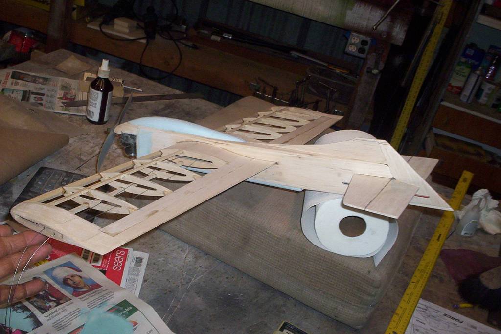

Howdy Gang...got a bug up my tailpipe last night to build a Mike Pratt designed FORCE... but for Norvel .074 power instead of a .40.
I framed the wing..33 inch span x 6 inch chord x 1 1/8 inch thick...measurements don't include flaps yet.
Should I bother with flaps...? I'm leaning towards elevator only.
The Norvel turns a 7x3 prop about 17,000 rpm.
What would be a good line length or lap time to shoot for...?
This plane should turn out pretty light [relative term I know]..but it won't have any landing gear. If I end up loving this version, LG could always be added someday.
I have made provisions for adjustable leadouts, so is engine offset and right rudder needed in 2011-2012...or can a model like this be taught to keep the lines tight with leadout rake and wingtip weight only...?

Leadout adjustment and tip weight should do the trick. Some outthrust might not hurt. I think you can fly it on .012 lines and I would start about 57 feet and cut them off as needed. For TD 09 powered Jr Flite Streak, with the airplane being turned loose at @15,000 on Cox 7 x 3.5, it took that length to make it reliably stuntable for me. On 55 ft lines, it was turning 3.8 sec laps and being herded rather than flown part of the time.
Back when we had 1/2A stunt contests, I flew my TD 049 airplanes on 42 ft 008 lines. I used a Master Airscrew 6 x 3 cut down to 5 1/2 in.

Thanks Jim.....that's great to hear that 55+ foot lines are doable. A plane this size and speed...[maybe 50 mph], will hopefully be able to get er done.
I'd like to go with Spiderline instead of steel cable.
Any thoughts about flaps...? I tried them once on a TD .049 powered plane years ago and thought they were a waste. Not enough of a hemisphere with 35 foot lines and the model was too fast to appreciate squared maneuvers.

On small airplanes, I like about 10 degrees movement either way for flaps. I think more movement gives too much drag on a small airplane. I've had two Shark 15 profiles with TD 09 and flaps. The weren't as fast as the Flite Streak, and did fine on 55 ft lines. I couldn't say if they turned better than the Flite Streak. Both airplanes flew very well, and I flew them in Classic, or PAMPA Advanced, stunt contests.

Hi Combatpigg, the model that you've drawn up only has 198sq"s.
That is TOO SMALL for that engine. I suggest you redraw to over 250 sq"s
of wing area. I 'm flying a Sig Akromaster (240sq" wing area), using an
MP-JET .061cu" diesel; this model flys beautifully on 44' X .008" lines.
I'm also flying a modified Ringmaster Jr (195sq") on the same 44' lines
that is pulled very strong, approx 56mph, using a PAW .049 Deluxe diesel.
your Norvel has significantly more hp than the PAW .049. There have been
many 240-250sq" models flown with PAW .049 diesels. I'll even wager that
the 300 sq" Peacemaker would fly very well with the Norvel .074.

Hi again Combatpigg, I see my suggestion to scale your design up for more wing area is too late.
In this case I suggest you do include operating flaps, because your 195sq" model will have a heavier
wing loading, than my PAW .049 powered RING Jr. Your model will certainly fly better with 50' + lines.

Thanks for your replys Tony.
I would like to see those planes of your's in action. I've never seen the PAW or MPJ .049 diesels.
This plane with a little bit of "craft work" involved to make a cowl and subsequent paint on the fuselage could end up making it a little bit heavy.
I did do something in the interests of lightness and ran a 1/8" aluminum rod from the bellcrank to the elevator.

Hey, CPigg...
Pretty looking work!
Is your airfoil the same as on the page plans? Photo makes it look thinner, and high point further back... Have you timed the engine's fuel consumption on the bench at a likely sounding RPM? That RC firewall mount should leave you space behind bulkhead #1 for a reasonable tank capacity - just want to make sure you'll have enough juice to get the pattern in...
Modern .049 (.8cc), .061 (1.0cc) and .074 (1.2cc) engines have enormous power! Oh, well, you can (almost) always go to a slower RPM OR a flatter pitch prop to tame things.

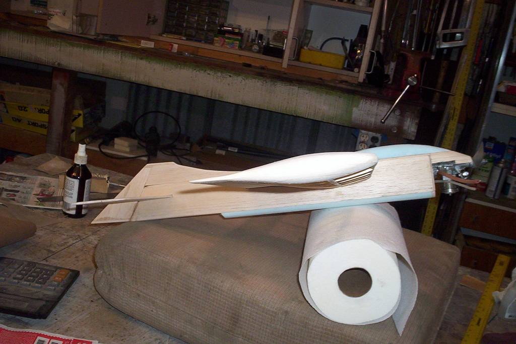

Howdy Lou....
I just eyeballed the airfoil. I've found that the smaller you go in size and weight [at least with RC planes]..the airfoils become less critical. I've never spent any time to speak of with control line stunters this small, though.
Until I see this thing fly, my thinking is that "speed is my friend".......then I'll have something to go by if it ends up being too fast to do a recognizable pattern with.
Might have to take some pitch out of a MAS 7x3 prop...?
The tank is a Hayes 2 ouncer, which is the most trouble free I've found in this size. It better be, because it's built into the plane now..!
Cutaway, after seeing this plane all framed up...it wouldn't look bad with more wing..maybe double or triple tapered....somewhat sportier looking. As it sits now it might fly more like a combat plane with a hot .09 diesel..?
I'll know better after seeing this thing fly whether I got it right or not. I'm hoping for a steady pulling plane that can keep me from biting my fingernails when I go for some overhead maneuvers.

Hi Combatpigg, I guess there are several of us interested in this project. You can control lap speed(not model speed) with flying line length. Going to a lower
pitch will buy you higher rpms, resulting in lower fuel range. If you stay with a 3" pitch, you might give increasing the prop diameter a try.
I'm afraid your model is going to weigh 13+ ozs; at 198sq"s this model will not fly like a combat ship. Prior generation TD .049 Combat designs were usually 190-200+ sq"s,
and they weighed 4.5-6ozs resulting in very low wingloading. This is why I suggest you use operating flaps. I think this model will fly a decent stunt pattern, even at 13+ ozs.
John Wright used to fly a PDQ Flying Clown" in OTS powered by a .25(Fox??). His "Flying Clown" has 200sq"s wing area, but he used long enough lines that maximized it's ability
to fly the OTS stunt pattern; and I'm pretty sure that 200sq"s was carrying close to 20ozs. Yes, keep us abreast with your experiences, Because I do wish you the Best!

Here's a progress report.
The fuselage has been covered with silkspan and white glue. It worked out pretty well for a first attempt. If weight permits, I might put a 2nd layer on the belly [that was made from blue foam].
The cowl is under developement. I started with a blue foam plug, then undercut the plug and surrounding area where the cowl overlaps the nose of the plane. This was done so that a strong buildup of cloth over the plug would come out "flush" with the rest of the plane. It is painstaking to cut out swatches of 6 oz cloth, then mist them with 3M77, then rub medium CA into each piece...one at a time...then knock down the fuzz and repeat...but eventually you get there without using any epoxy.
The foam plug gets covered with clear packing tape before the cloth is applied.
Right now I'm blending the edges of the cowl to the rest of the plane with Bondo..so there are still some hours left before this thing is ready for paint.
