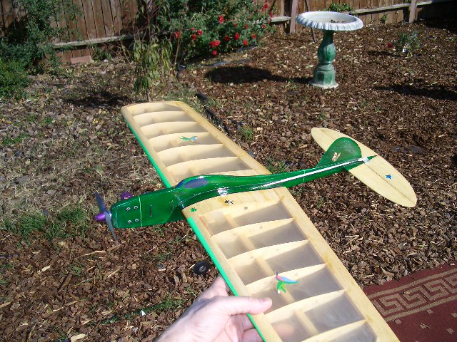

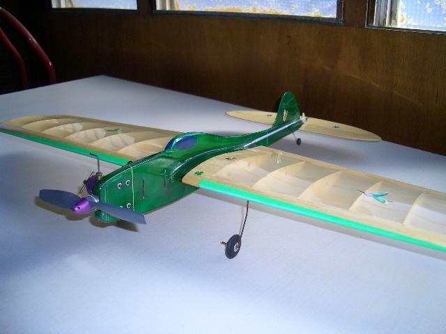

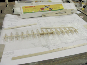

Starting a P-40 By Brodak

.15 Magnum. However, the performance will be less than stellar, because of the very high wing
loading of your finished model. You'll surely need to add tail weight to move the CG to optimal
performance. The Brodak model is a re-kit of the Sterling line which also featured a profile ME-109.
I eyeballed this model from a Sterling kit and estimated the wing area to be around 140 sq"s.
I fly a Ringmaster Jr (195 sq" wing) that is powered by a PAW .049 diesel, it literally flys like a combat
model on 44' X .008" lines, and it is going 54mph. It weighs 7.125 ozs ready to fly sans fuel. It flys an entire
stunt pattern with 1/2 oz of fuel.
With all that being said, I do like your model, and I'm sure it will be a lot of fun for you.

A smallish wing like that needs to have some airspeed around 70mph before it begins to operate in any sort of competent manner.
I build what we call 2.5 (.15) Slow combat models. At least 44" span and 8" chord. It still flies relatively fast, but will turn tight and doesnt slow down when asked to perform.

With wing area about the same as a jr Ringmaster it doesn't have to go 70 MPH or it will drop out of the air. I have 2 of the Jr Rings with OS10FP on them and fly with 55 ft .012 line. The both of them are quite capable of doing most anything you would want to do even a 4 leaf clover. Speed is more then adaquate. Prop is a 7/5 APC and a Rev-up 7/6 narrow respectively. Haven't used a 15 on any of the old designs as it simply isn't necessary. and weight and balance are real factors so equiped. Brodak apparently was making them for his 15 but really could have made much better choices then these 2 models. As I said a Norvel .074 will fly these models well if kept light and the 049 on an appropriately built model would probably be a nice sport model . For reference there have been several contest Ringmaster S-1 models powered with 15's. Modern engines are light years ahead of the old powerplants we had 50 years ago.
If Don has an 09 and wants to fly with it,it will be a very good sport model. an Enya 09 would be very good and they make 3 different models.All are available as C/l engines.

So it looks like I am buildinga GOOD YEAR RACER class plane as this is the sizeI put .15 s onin 1984.
but i think they were going faster then 70 mph.... If I had an .09 I would use it............. I do have a box of .049
and I do have a Gilbert .070.............................................. ..............................
The Buster and the Shoestring racer, go fast and burn circles.....

As you have surmised a good .10 of today has more power than those, and because of the muffler, more weight. If you put a .15 on it you will probably need to add tail weight for an even higher wing loading. I would go with the .10.
Of course your plane, your choice. Good luck either way.

First, forget the .049's and the Gilbert .07. Matt Kania designed the kit for a .15 of the mid 1950's. The .15's available during that time included the OK Cub .14, K&B .15, Cameron .15, and finally the Fox .15. They were just starting to import foreign engines.
George
George
showed a Cub .099 and a Torp .09 and a Torp .15 engine on the original plans.
My first Ring Jr was powered with a Cub .099. The Cub weighed only 1.77 ozs.
It flew very well on 35' X .012" lines. It actually was full pattern capable; but
that was in 1954, so I wasn't. A friend of mine flew a complete stunt pattern
with it in 1956. This experience prodded me(over 35 years later) to start using
smaller than suggested engines for the Jr. My first smaller displacement model
used an AM 10(1.0cc) diesel. It flew magnificently on 40' X .008" lines. The next
models used PAW .049 diesels, I did cut a bunch of pork by slimming the
fuselage, reduced stab and fin area and subsituted the empannage with "C" grain
3/32" sheet. Oh yes, I shortened the nose to accomodate CG and tank size.
The PAW .049s have more power than the AM 10 and are a bit lighter. The Paw .049
will fly a stock Jr with careful attention to weight and wood choices.
My last two Jrs weighed 7.125 and 7.25 ozs, ready to fly sans fuel. I don't remember
what my 1954 Jr weighed, but my late 1980's(stock kit) AM 10 model weighs 9.8-10.1 ozs
depending on prop used. I fly the latest Jrs on 44' X .008" lines. Yes, I agree to forget
about using his .049s and the Gilbert .07.

Hi Don, just consider the .09's as .10s, most .09s were really .099 cu"s. Look around for .10's from
Enya or OS 10 with control line venturis on ebay or even advertise in you local hobby shop. I do not
recommend going the diesel route, because I suspect you have no experience with them. also
consider 1.0 cc(.061cu"s) and .07 cu" engines.

I just ordered the OS .10LAas it is half the weight of the Magnum XLS.
OS.10LAis bushing and the Mag is a bearing engine, so half the weight close tosame rpm and prop.

You see what I am working on along with the P-40..
I realy like the red and white checker board ringmaster you have..............

Hi Dennis as a fun comparison, here is my Ringmaster Jr (much modified) that is
PAW .049 powered. It flys beautifully and handles very much like a 1/2A Combat
model flying 10-12 mph slower. I have posted some pics in the Shoestring thread,
so I'll post some different ones here.
Tony

ORIGINAL: paw080
Tony

Tony,
Thats a nice set up and a good looking model. I have one origional Jr Ringmaster left and one new manufacture Pat King kit. The red&white is a Pat King kit, the silkspan yellow is an Estes. But the next one was going to have a Paw 061 simply because I like to use longer lines and 55 foot seems to work for me. Incidentally as you know newer manufactured kits have infinitely better wood then Sterling had in their offerings.

Wll in the first photo you see my old Enya .19VIand it fit then a I pulled out the Magnum .15XLS and refit the smaller engine now I am waiting for the new OS.10LA engines to get here. That is holding up 2 planes now this one and the Ringmaster Jr and now I need smaller lines, So I ordered some .12 cable 7 strand.
I have .15 by55 ft. but they will be to large I think....
I am doing all this because I want the stellar performance.....
