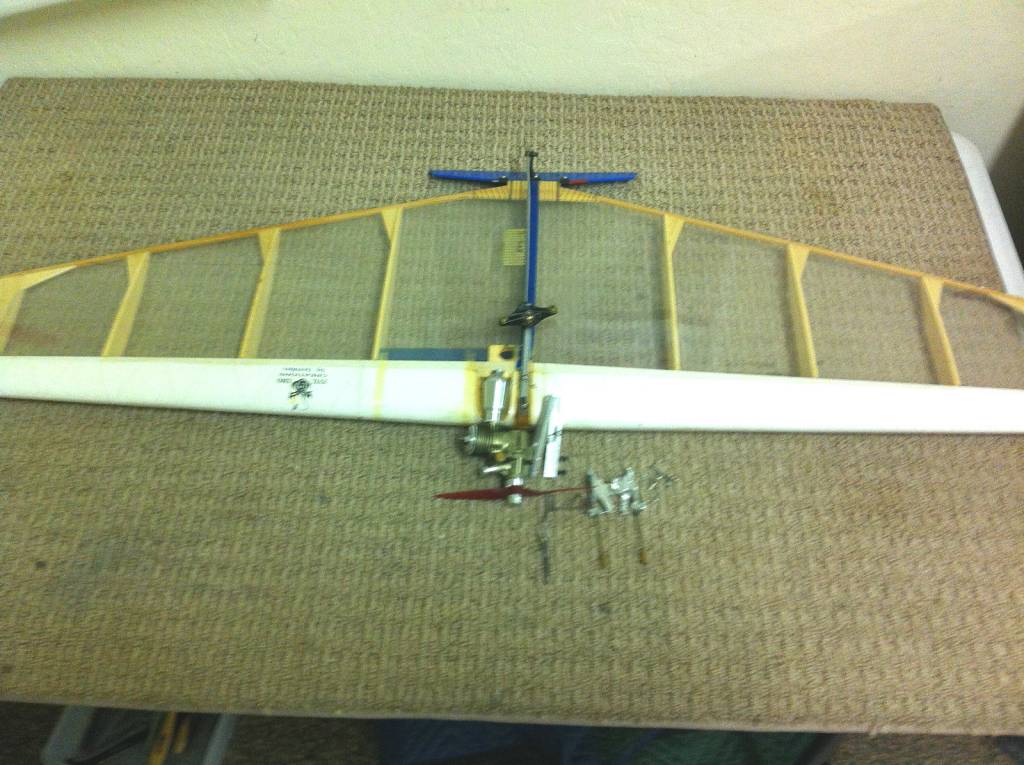

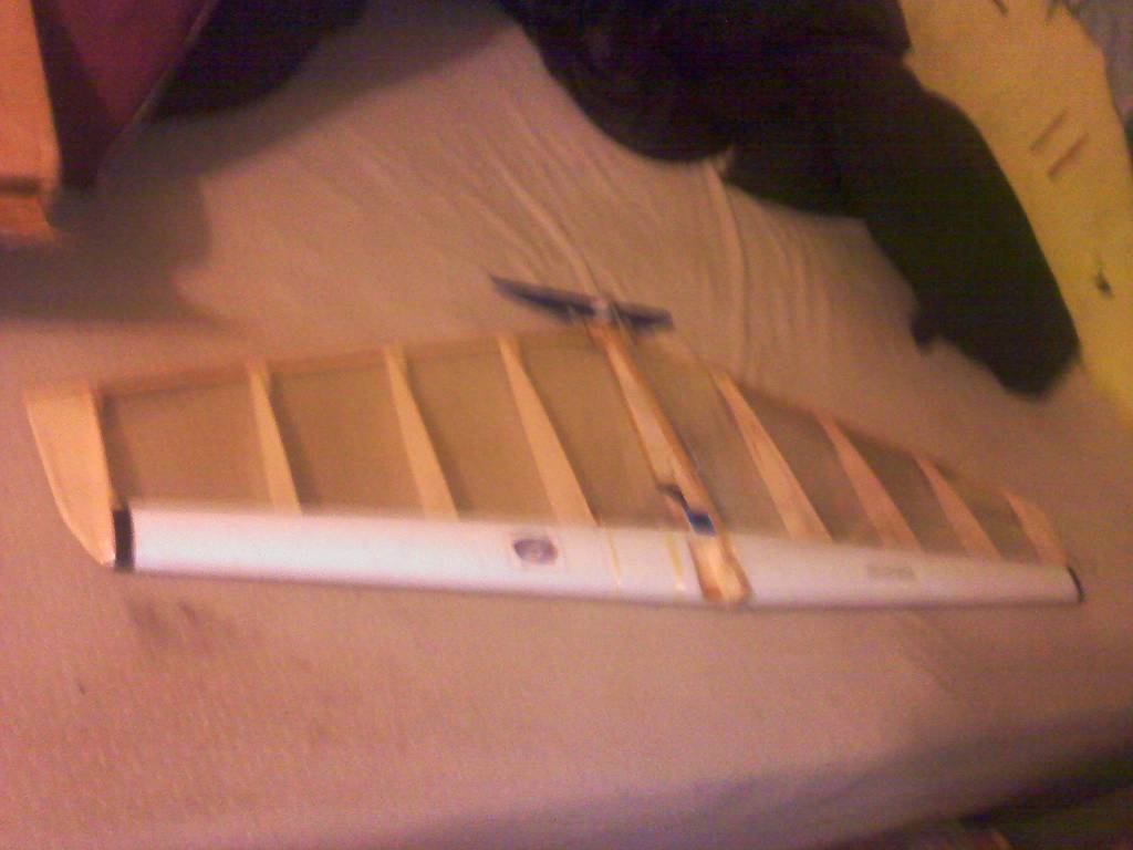

I have a few wings I bought new. 3 of them appear normal with leadout lines from inside. I have a another one that has the bellcrank on the outside of the wing with a strange set up. Same wing as the others, but set up different. How do I hook it up and why is it made this way, when it's the same wing as the others? Here are some pictures to compare together and see what i'm talking about.

Well, funny thing is, there's the mount inside the wing, but was converted outside. I can't see that it was recovored though. I was told it was the newest set up regulation, but have a hard time believing that. I thought it would screw up the flight as well. Should I cut the plane open, install it where it belongs and recover it? I was told the lines go directly to the bell. They pop on. Sounds like they will pop off just as easy..Sounds half-assed to me. What should I do? I haven't flown it yet....

The external black bellcrank in your first picture looks like a type widely used to prevent flyaways in the event of a line cut. This sort of device is a requirement for safety reasons at many contests. It also helps save your equipment.
The fuel line is routed through the hole. If line tention is lost after launch, the spring will pinch the tube shutting down the engine.
I'd guess if you searched "CL combat fuel shutoff" you might find instructions for its operation.

The bellcrank has a cut off built into it apperantly. There's a spring in it. It's really odd. I'm trying to search it.

Thats an H & R shutoff. The airplane originally came with internal controls. Shutoffs are now required in F2D and Fast 2D events. And in seatle (where this shutoff is manufactured) they do not allow swing arm shutoffs, so a bellcrank system must be used. They work very well (I designed this type of shutoff and H & R copied it, with my permission). I've flow airplanes with this setup and I cant really tell much difference in flying abilities. Unfortunatly, you will have to make longer lines, or just build a set of leadouts for the airplane

Oh.. Ok, so there's no worries then. I was so confused when I got this scratching my head looking at how it was set up. I'd like to keep all my lines the same, so i'll just add lead outs for it. That way I can fly my others with the same lines. Glad to hear it will fly fine.
