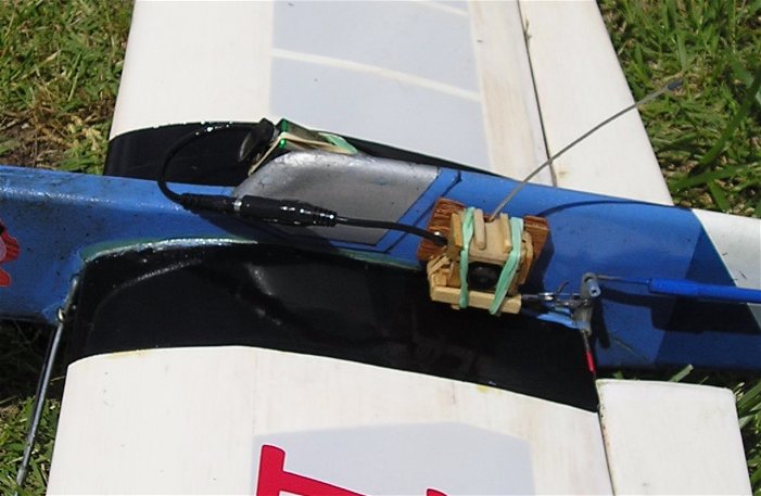

Some of our group got to wondering what the stunt pattern would look like if you were riding along in the airplane and now we're on our way to finding out. Several of us kicked in the money for a small color video camera and transmitter and one of our more techno-savvy members, Bob Reeves, is doing all of the installation and flying. The first attempt was using an old Dancing Girl Bipe that had been recently refurbished. The cockpit provided a good place near the CG to mount the transmitter and the camera was mounted on a pod strapped under the wing a little off to one side to minimize any interference from shooting through the prop. The set up proved the system would work but the added weight degraded performance enough that the plane couldn't do the entire pattern. The next step is to put the system in a second hand Sig Magnum that should be able to handle the weight increase. The plane has been fitted with a Stalker 61 and a few test flights without the camera has proven the plane is a decent flyer and just needed a little flap tweaking and wingtip weight adjustment to get it trimmed out well. Hopefully we'll get to try out the new plane with the camera on board this weekend or next. Other things we are hoping to try is shooting a clear plastic fuel tank as the plane goes through the pattern to see just exactly how the fuel moves around in the tank, and shooting the tail of a profile ship to see how much twisting of the fuselage occurs.

Well the weather was sunny and calm early Sunday so Bob brought out the Magnum camera plane for it's first test with the camera on board. It went so well it was almost anticlimactic. The plane didn't even know the camera was there. The image would flicker a little now and then but nothing too bad. There was some stobing effect on the prop and it looked like you could tell when the rpm's changed. After shooting a flight looking forward Bob turned the camera around to shoot the elevator and flaps. This looked even better than shooting forward. It's amazing how little elevator movement is used during a loop. A hard corner used quite a bit more movement. Can't wait to see the footage on a full screen. We only had a 3" monitor at the field.
After watching the video on a big screen, Bob reports the camera was slow to recover after the sun passses through the field of view so plans are to do more video taping on a day when we have some cloud cover.

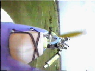

Bob brought the camera toting Magnum out again this weekend and put up two successful flights. On one flight the plane was just puttering along doing a 6.5 second lap but Bob was still able to complete the pattern. There was still some "noise" evident in the video, but Bob had tweaked the camera and has gotten it to a minimum. On Sunday Bob brought out his Twistmaster with the camera attached and filmed the fuel tank going through a full pattern and then turned the camera around and filmed the flaps and tail. The Twistmaster weighed in at 47 OZ with the camera on board which is a lot of weight for a 500 sq in wing on a C/L stunter. Fortunately Bob had recently re-engined the plane with a 40 four stroke so there was plenty of oomph to haul the increased weight. The small muffler on the 4-stroke concentrated the exhaust and on the video looking to the rear it kind of looked like he had a smoke system. There seemed to be less "noise" problems with the video when shooting toward the rear for some reason. Maybe it relates to shooting through the prop in some way. Can't wait to see it on a full sized screen.

O K! Bob has put a short bit of video on the web so you can get a sneak peek at what's been goin' on.
If you have a fast connection it won't be a big problem but if you are on dial-up even at 56k be prepared for a long download. The easiest way to get the file is to Right Click on the link and select <Save Target As> and make a mental note of where on your hard drive you saved it to. After the download you should be able to use Windows Explorer to navigate to the file. A double click on the file should bring up Windows Media Player and play the AVI. Here's a frame from the video with the plane at the top of the circle. We were shooting the fuel as it reacted to the various g-forces as the plane went through the stunt pattern.
http://www.eaglextra.com/images/WINGOVER.AVI
