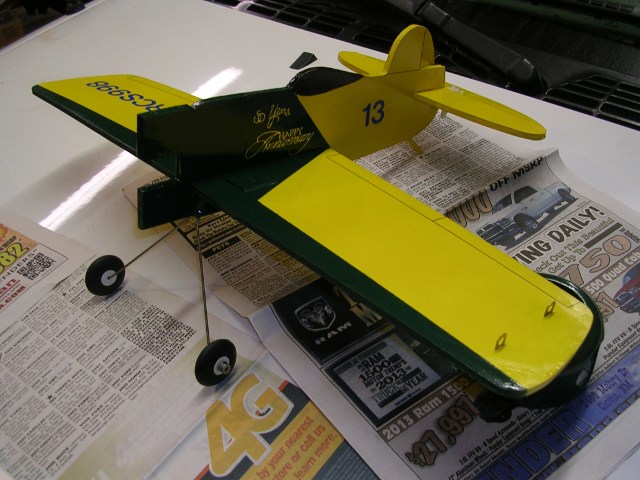

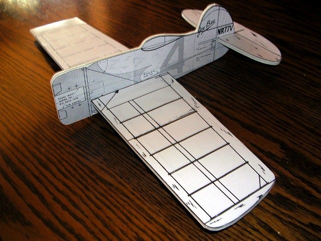

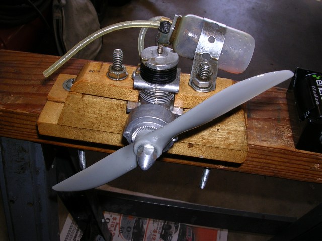

Well, I finally did it. Needed to have something to make the homely Gilbert .074 look at home, somewhat modern, but somewhat vintage. Came across an old keith Laumer 1/2-A Gee Bee Z profile plan. Then wanted to have a little fun with it, somehow relate it to the Ringmaster Brotherhood.
I came up with the Ringmaster Gee Bee Z variant. It adapts the fuselage of Laumer's Gee Bee, but retains the cockpit, rudder, elevator and wing of the .049 powered Sterling Beginner Ringmaster. To make it quick building and inexpensive, I used 3/16" thick (5 mm) poster foamboard, $2 from Wal-Mart. To keep it "scale" looking, it needed a cowl. I took a 3" (76 mm) diameter vitamin supplement bottle (GNC Mega Men Multi) and took a section of the bottle.
Attached is what I have come up with so far. With the look of the cowl and the genuine Gilbert putting out the horsepower of a Cox Sure Start .049, you can almost feel the 535 HP from the Pratt and Whitney Wasp Jr. engine.

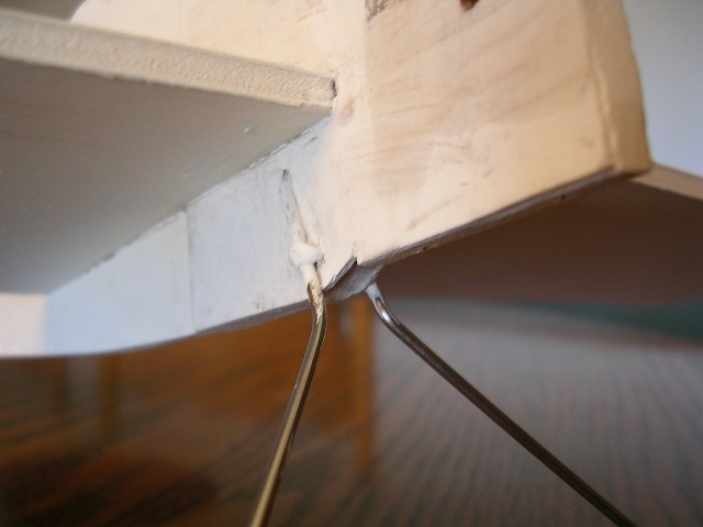

Thanks, Dan and Don! I forgot to install the landing gear before putting the wing on. No problem! I drilled a 1/16" hole near the wing, insert a half bent landing gear through it. Then used heavy duty needle nose and standard pliers to bend at hole location on other side. Then I completed bending the rest of the gear. I drilled 2 holes on both sides of the landing gear wire. I wrapped about 5 winds of bell wire copper around the gear, then soldered it with a 40 Watt soldering iron. Normally I would have coated both sides of the gear along the profile fuselage sides to help lock the gear in place, but forgot. It's stable and not moving.
After a thorough sanding, I brush coated the model with a thin layer of gyp board primer. This stuff is sandable when dry. One thing I found out immediately is that cardboard covered foam board can warp if you are not careful. It was night and I forgot to paint the rear portion of the right fuselage side. This morning I picked up the plane and immediately noticed the warp. The tail was curved over about a quarter inch (6 mm) toward the left. Again no problem, I recoated the left side and put a new coat on the right side. Dry a few hours later, the problem straightened out. Also there was a slight downward bowing (sag) of the wing. It is only slightly noticeable, not worth fixing.

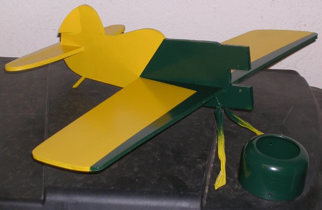

After a second coat of yellow, I've got her masked off and trim painted. The trim on the original Gee Bee Z was involved with scalloped wing, fuelage and elevator trim. It is more important to have something that looks reasonable but ready to fly soon, so I simplified the scheme, easy to tape.
In honor of the indigenious population surrounding where I live, I selected familiar colors, those similar to John Deere.

Old 12-20-2012 | 09:52 AM
GallopingGhostler's Avatar
Joined: Oct 2004
Posts: 2,363
Received 127 Likes on 95 Posts
From: Clovis, NM
Default RE: Gilbert .074 Powered Ringmaster Gee Bee Z Variant
I've made progress, painting is done. Just waiting for the windy chilly New Mexico weather to pass so I can spray the plane with a fuel proofing clear coat.

Old 01-11-2013 | 06:07 AM
Joined: Oct 2004
Posts: 2,363
From: Clovis, NM
Fuel Tank is in place but needs strapping, wing lead out guides are installed. Left are clear coating (awaiting warmer weather) and installing lead out wires.

Old 03-15-2013 | 03:12 AM
Joined: Oct 2004
Posts: 2,363
From: Clovis, NM
Decided to fuel proof it by brush coating the variant instead of spray. Paint: Red Devil Clear Gloss Polyurethane. Just need to strap the tank, install leadouts and I'm done except for flying.
