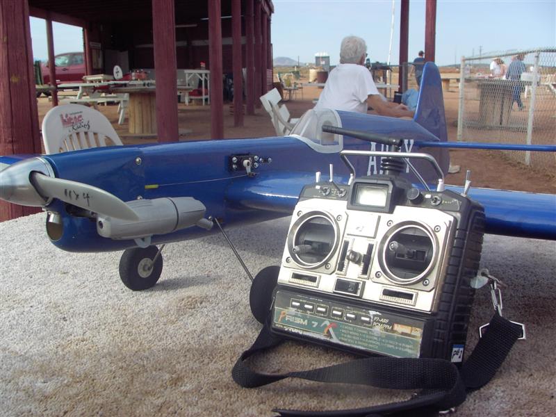

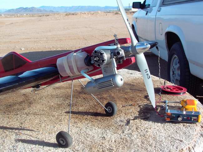

Hi Jaka, yes and yes. I do infact use Tetra 5.5 Tetra bubbless in my Nobler .35AX and my Magician .40FP. Both are throttled engines and I now use Hitec 2.4 systems rather than my old Young over the wire system.
In both ships I find using the bubbless give me the best and most uniform engine runs possible and far better than the old unflow methods. I now can make and entire flight of touch and gos If I want and the engine response is perfect.
I Prefer using a syringe method for fueling with the bubbless and in my case I us a Dub Jett Tanker left over from my active pylon days. I would highly recommend the Tetra or Jett bubbless systems for any controlline use. I would post pictures but cannot yet with this new forum setup.

Hi Ken good speaking with you agine. I believe Central Hobbies is the only major supplier of Tetra but not sure perhaps some of the cottage industry pylon specific suppliers do. Anyway here they are and be careful they also sell Tetra conventional tanks that look almost the same so just be sure you order "Bubbless". They are not cheap but for controlline or some problematic RC types especially throttled engines they are more than worth it.

Here is an older shot of the Magician with the Tetra and here is one of my old vidios flying the Magician with the tetra and you will hear the steady running as well as throttling. Watch my feet 13 seconds into the vidio
