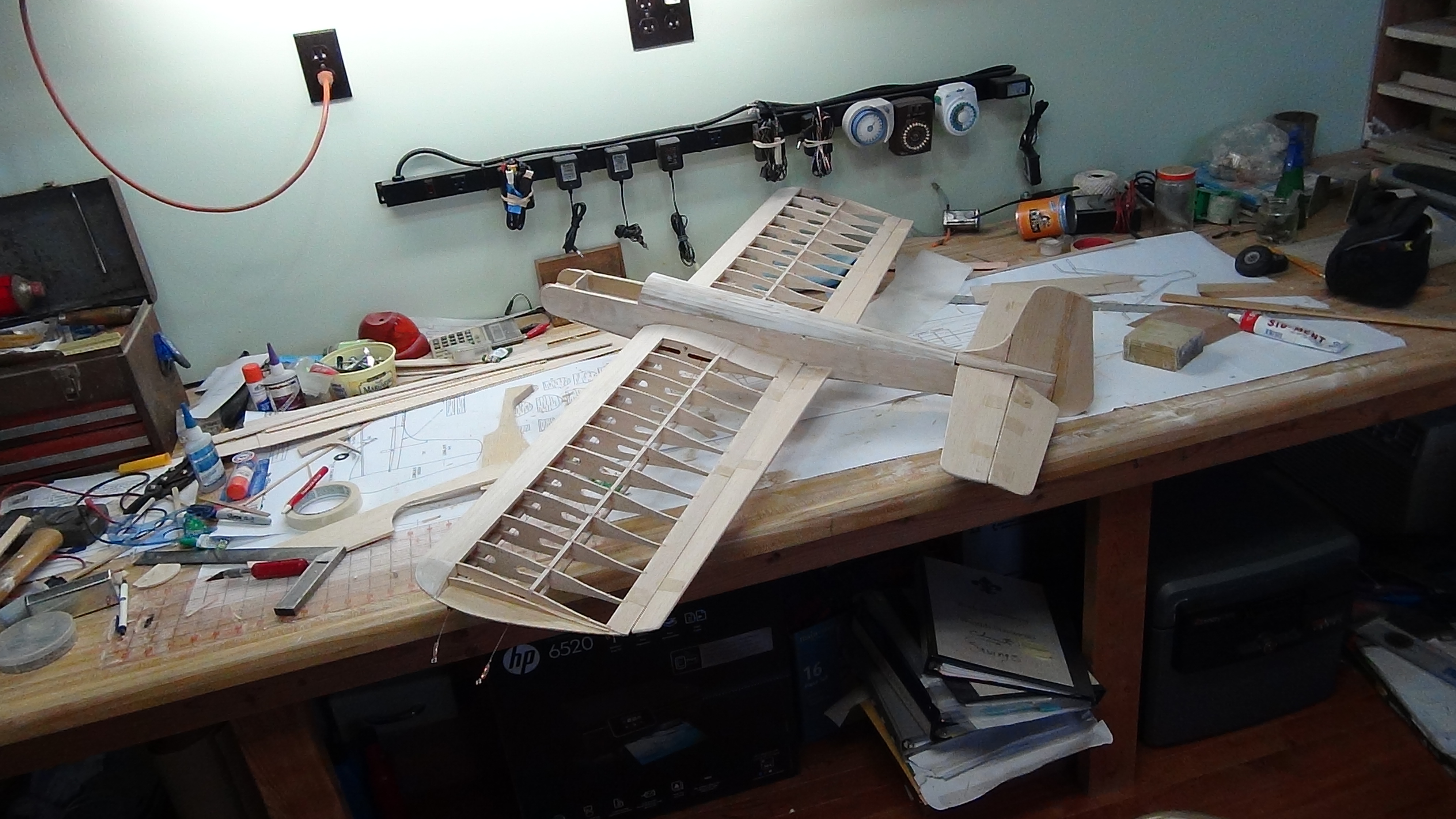

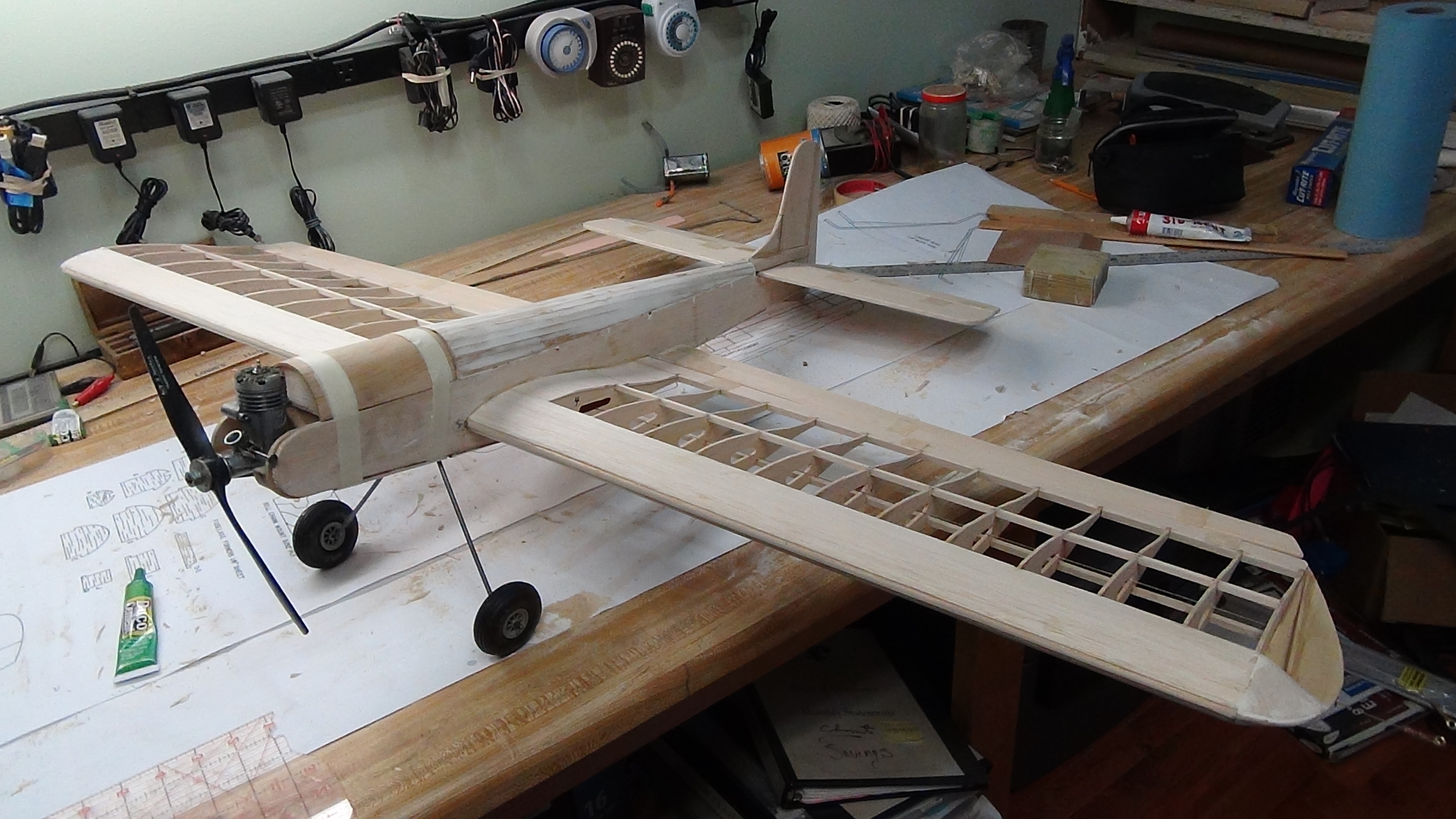

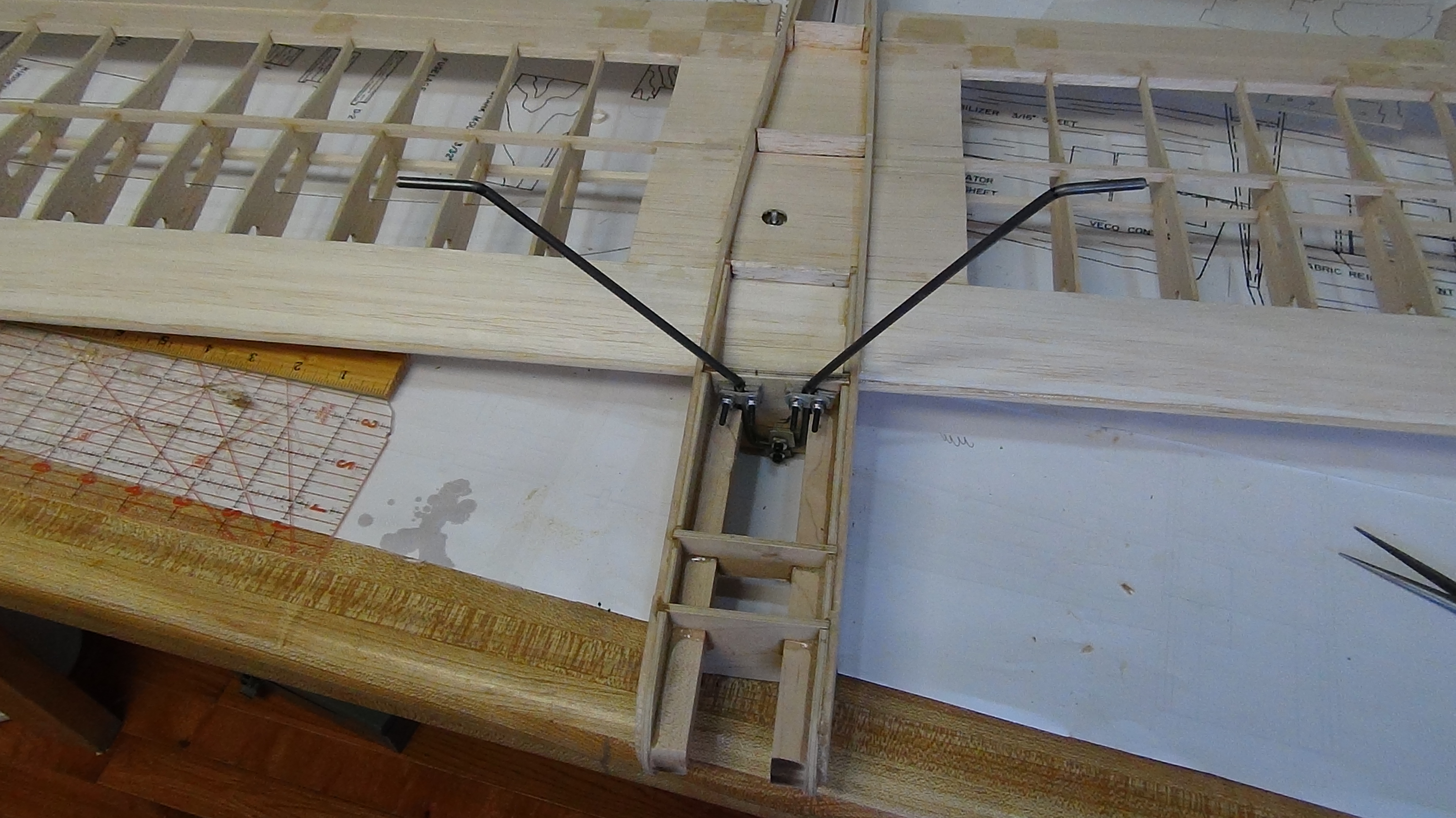

I ordered the plans from Barry Baxter for the Veco Chief. I started building the Chieftoo but it is ant what I wanted.
ID:	2077905   Click image for larger version

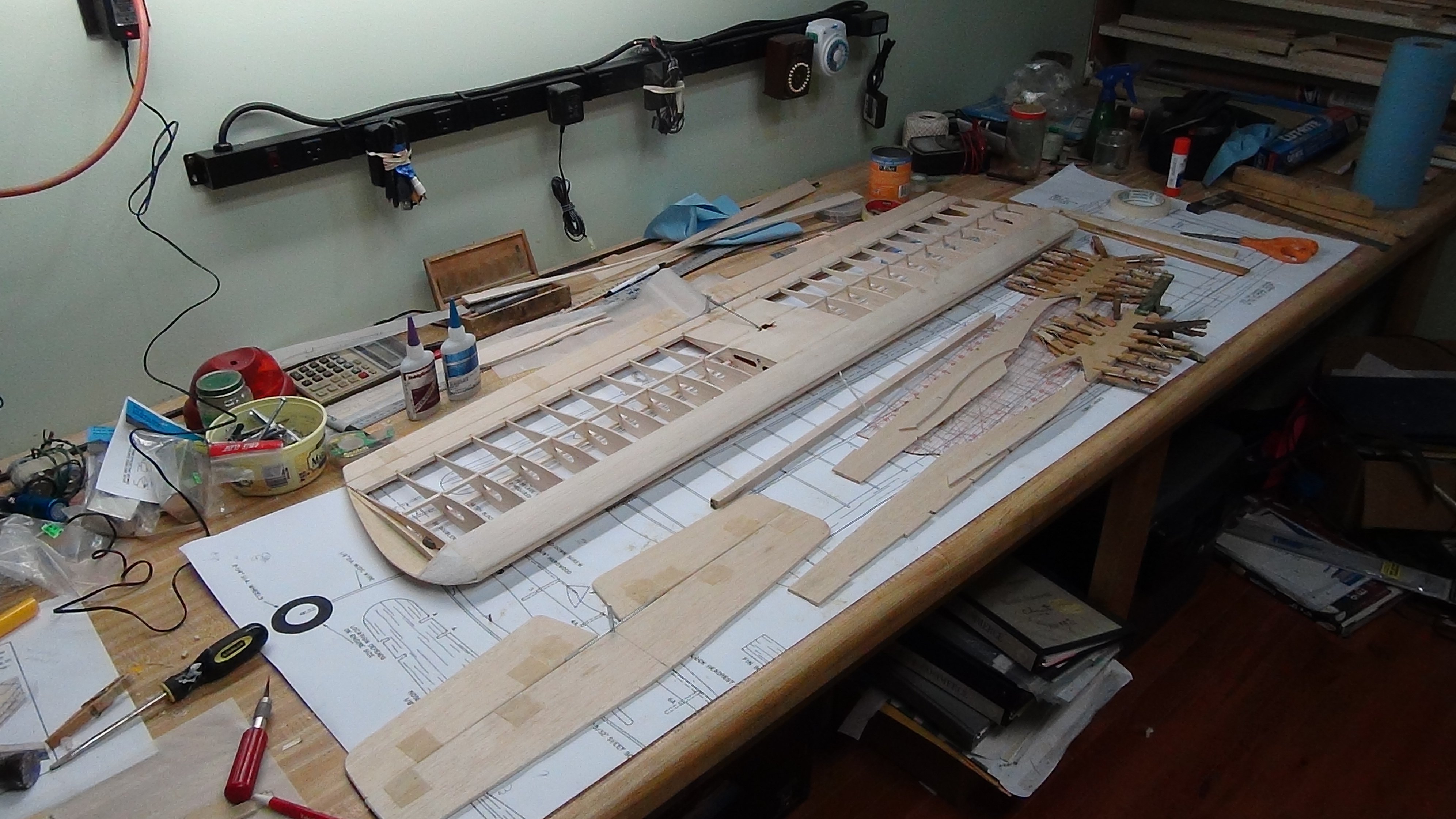

The plans say to use 1/8" sheet for nose doublers that didn't seem right so I have some 1/8" birch 5 ply so I used that. The landing gear on the lpans seem way to long so I made them about an 1" shorter.
ID:	2077908   Click image for larger version
ID:	2077909   Click image for larger version
ID:	2077910   Click image for larger version

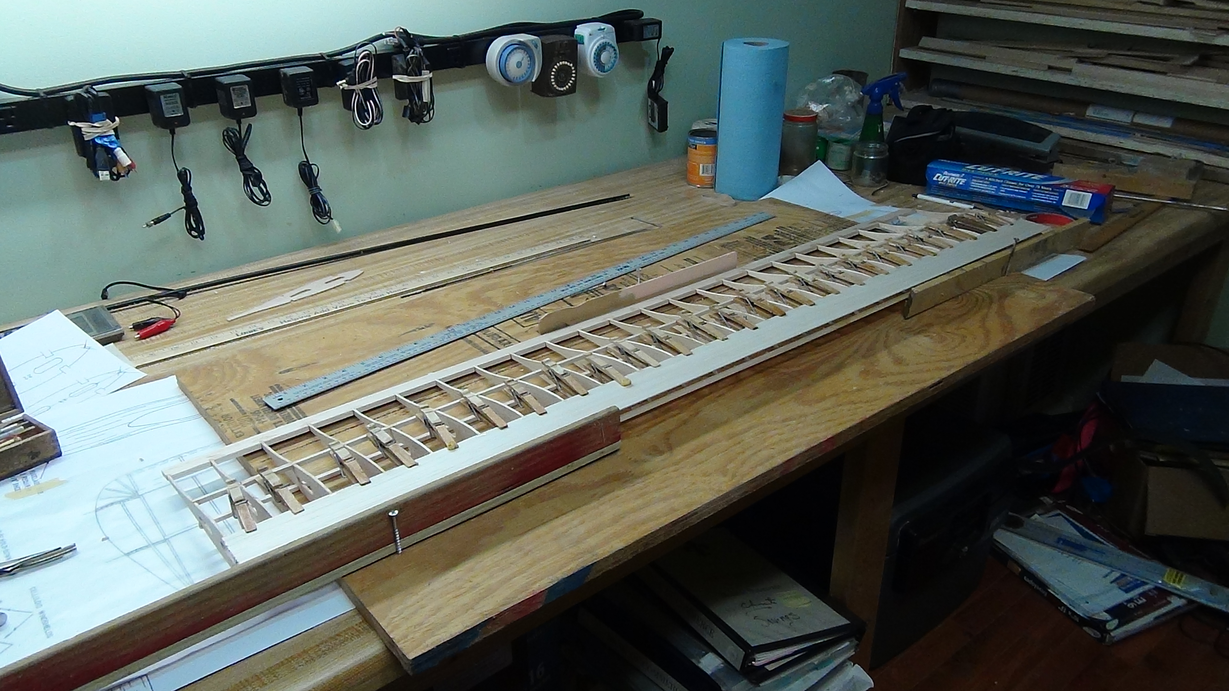

The 1/8" sheet fuselage seem flimsy so I put 1/8" sheet length wise on the bottom. I tried to to soak some 3/32" sheet and form the top but it just would split, I didn't have any soft balsa so I planked the top. We will see how that works. I think I will not cut out the cockpit holes to save some strength,just paint them. I will need to find some thing to make windshields out of.

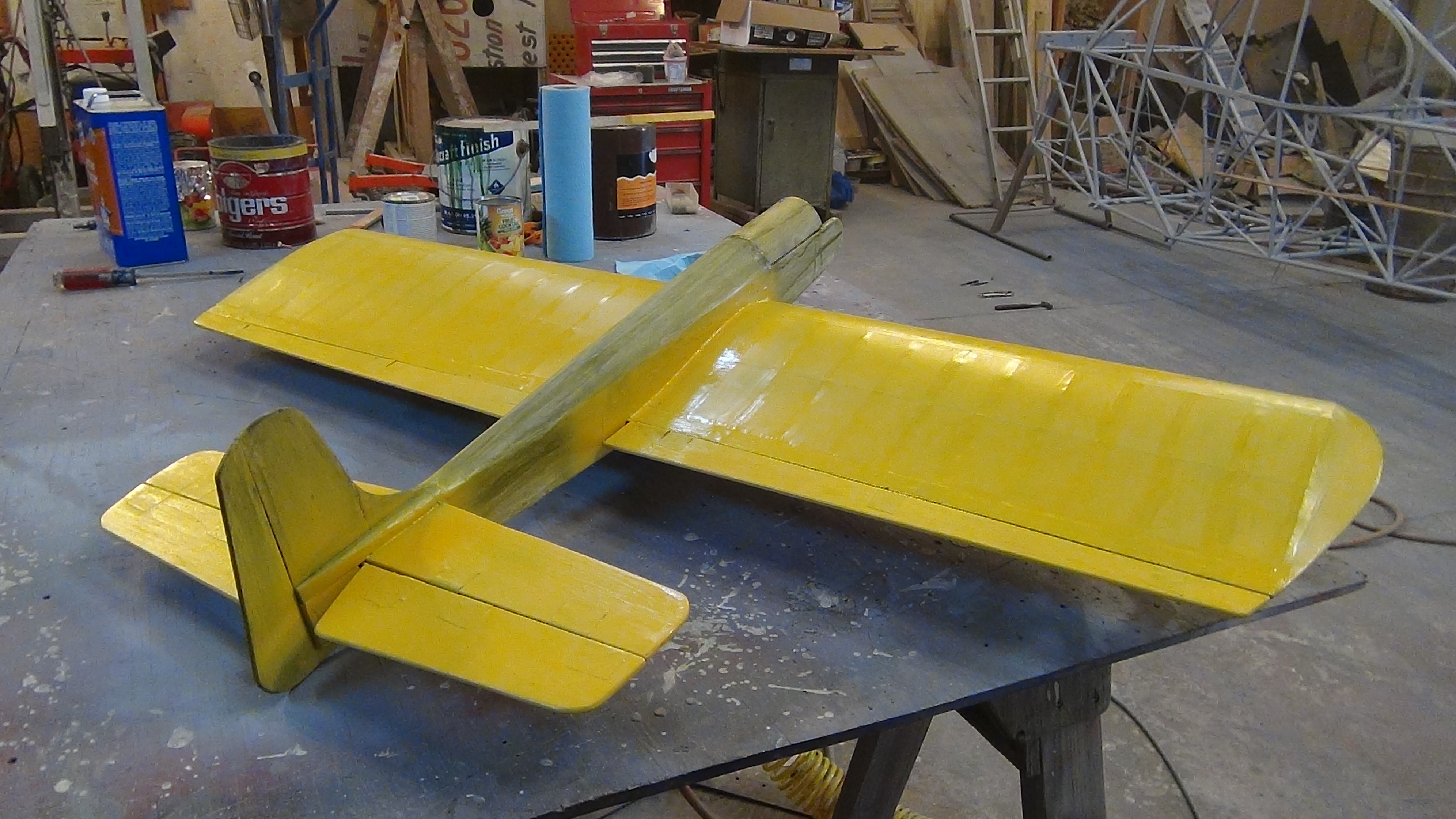

Doped the wood with Rand-O- proof nitrate. Covered with Sig Cover all and doped with Rand-O-proof

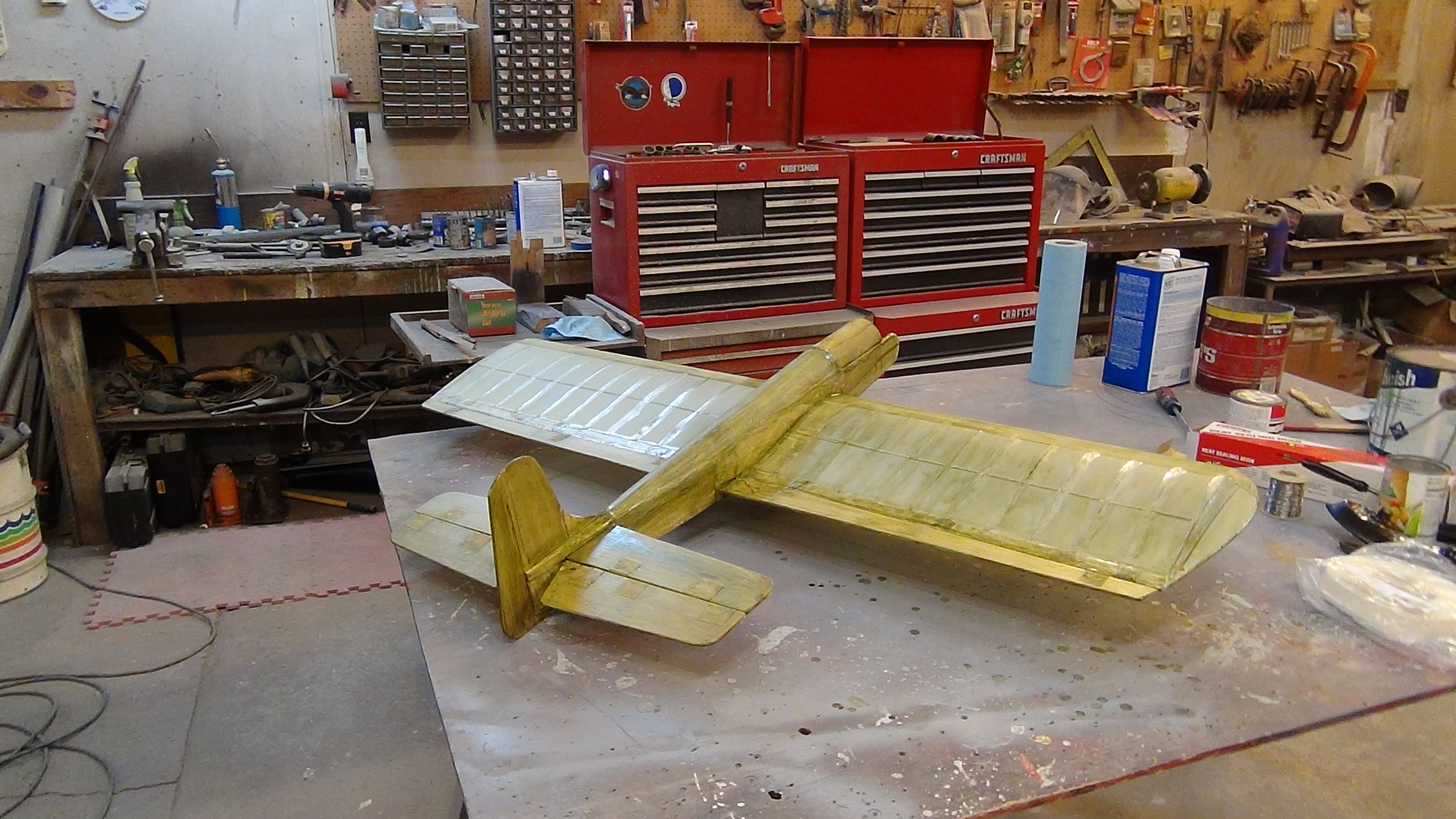

Finisher with Randolph Butyrate color dope.
ID:	2083451   Click image for larger version

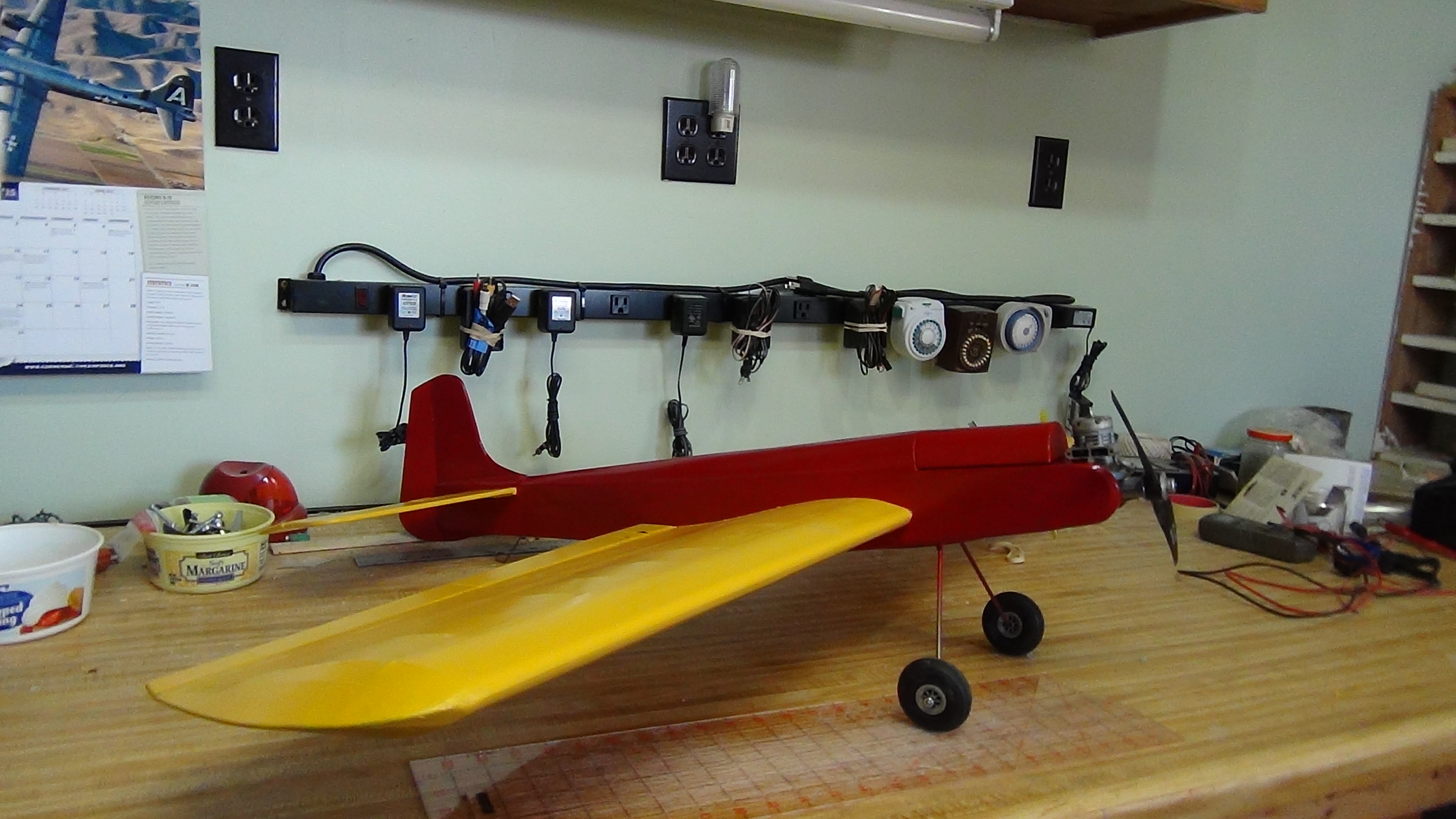

From: Galesburg, KS
https://www.youtube.com/watch?v=7V6g2dQwFw4
It is a lot faster than I expected. It really pulls on the lines. I flew it on 60' lines I ordered some 70' lines. It has a 10X6 prop. I ordered 11X5 and 11X4 props I hope will slow it down some.
Hye Flyer (01-15-2024)
Old 03-23-2015 | 04:16 PM
Joined: May 2006
Posts: 713
Received 6 Likes on 5 Posts
From: Sierra Vista, AZ
Joe,
Looks good! Congratulations!
Confirm which engine you're using? Looks like a Fox, but hotter than the Stunt 35. Nice steady run, too.
Glad to see you settle in after the first lap or two 'flutters'. Lazy-8s are fun, no? Good way to prevent turning dizziness... Very nice landing, too.
To slow the airspeed, look at that 11-4. It lets the engine wind where it is happy at 2/3 the theoretical forward speed for the same RPM (6" pitch vs 4" pitch.) Of course the extra inch may pull RPM down some too.
Envy you your flying site...

Old 03-23-2015 | 05:13 PM
Joe Fisher's Avatar
Joined: Nov 2003
Posts: 298
Received 21 Likes on 13 Posts
From: Galesburg, KS
Yes it is a Fox 35 stunt Anniversary engine. I bought the engine for a Ringmaster but I couldn't get it to run when I would do H 8,s it would quit going up the back side. I learned that engine doesn't like being on its side. Now I hope to try working on more pattern maneuvers.
AJ Sun (01-14-2024)
