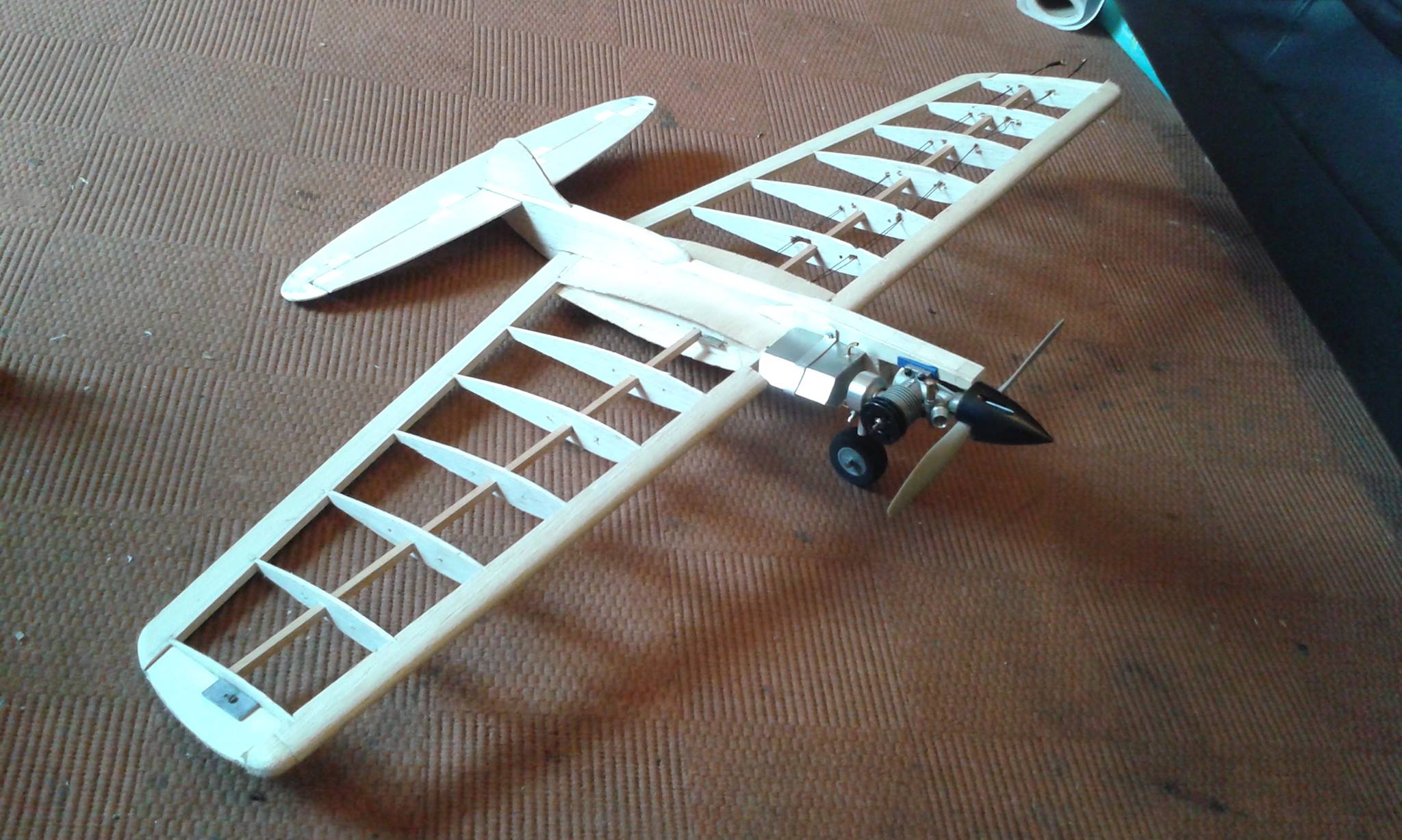

Here is my Dragoon with an AP15 - it came with the venturi off eBay (the engine that is not the venturi).

How does the plane fly with the AP15?Plenty of power?What size wing is that?

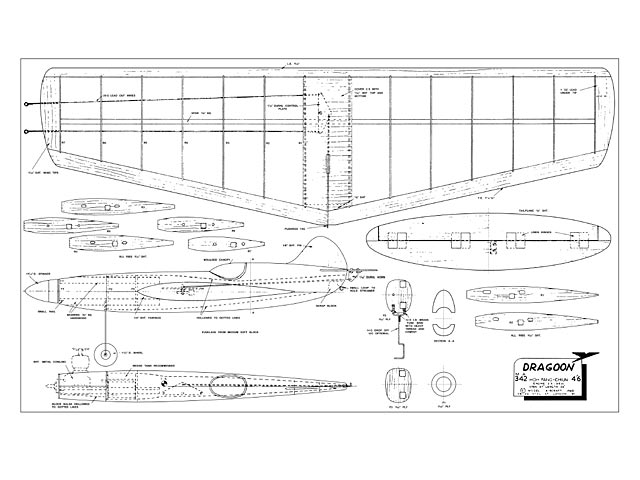

The Dragoon is not finished yet.
It's 37" span.
