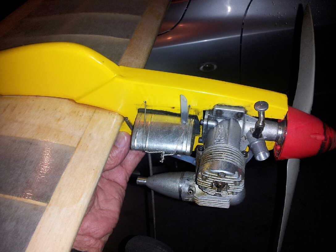

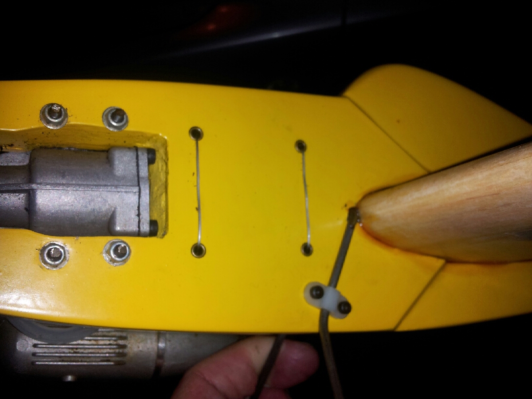

The rubber band method is the classic way of attaching the tank, but I have used the method shown in these photos for some years with great success. Holes are drilled through the fuselage and servo screw bushings are inserted on the left side. Aviation safety wire holds the tank in place. The tank should not be seated directly on the fuselage, but rest on dense foam rubber or inner tube.

I’ve been going thru some posts and I found this old post on soldering Fuel tanks. And attaching tank to a profile U Control behind the engine. I have found vibration is a big concern. And you can control some of that with a rubber pad between the tank and the mount surface. I been using brass strips covered in heat shrink and blind nuts with machine screws. A previous post recommended Aircraft safety wire. In a flying site repair I used plastic ty raps and it saved the day. It’s always great to do a field repair. And get to fly. Guys keep them lines tite! AJ
