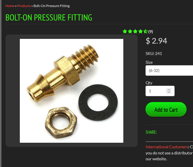

I'm' setting up a McCoy 29 that has a front air intake and needle valve , I would like to use a rear mounted needle valve on it . I read you must use a pressure fuel tank , this engine has no muffler . How can I get crank case pressure to the tank ?
Thanks , Mark .
Thanks , Mark .
A pressure tap in the backplate is probably the easiest method. Du-Bro used to sell a pressure nipple together with a suitable sized drill and a 10-32 tap. Still available less the tap and drill. In the old days we'd run a 1/8" Whitworth (similar to a 5:40 UNC) die down a piece of 1/8" Copper tube and screw a brass nut down the thread. Almost anything will work. Now days you could reinforce the thread in place with JB Weld. Make sure than none of the screw protrudes into the engine internals.
We'd also restrict the inner hole in the nipple to about .012" - .015" for more reliable needling. A few years ago I did this to a K&S nipple with a bit of c/l wire and JG Weld inside the nipple. Fill the nipple, Pierce it with the wire, leave it there till it is semi hard, pull it out. It should leave a hole about .012" or so diameter. In the 1960's we used solder to do much the same. Plumbers solder not electrical works best. Coat the wire with carbon soot first if using the latter. Plumbers solder doesn't solidify instantly. It has a "mushy" phase to it's solidification.

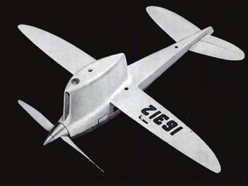

Old 05-04-2024 | 07:34 AM
markwesti's Avatar
Joined: Apr 2024
Posts: 13
From: Seal Beach , Ca.
Thanks again qazimoto , that tells me what I need to know . I'm building a B speed plane . Plans are from the 50's it's called the "All American" . I know it's a C but I'm putting a McCoy 29 in it .I also started with a Harter's B pan .
Mark .

On some engines the upper left rear cover screw hole goes all the way through to the inside of the crankcase. If your engine has the through hole, replace that screw with a 4/40" nipple.
markwesti (05-04-2024)
