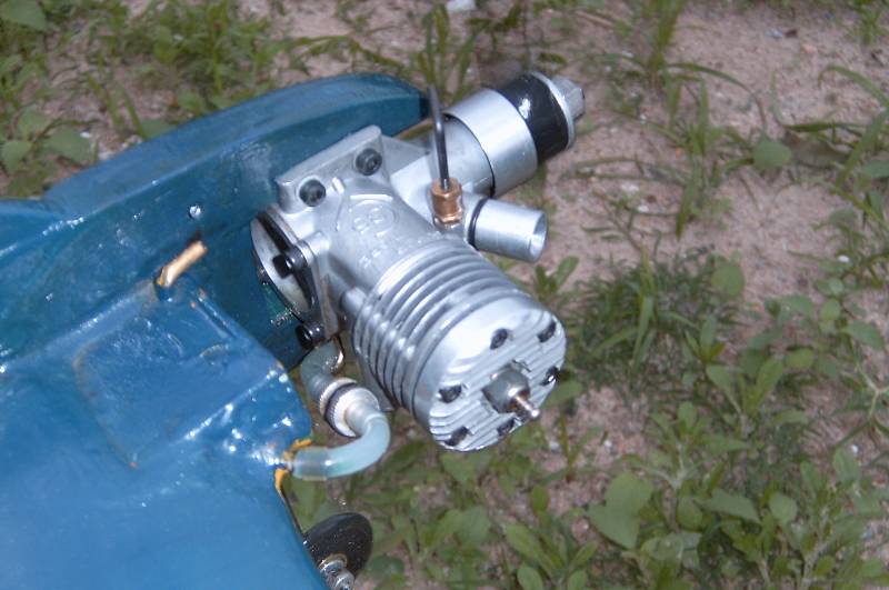

In digging through my boxes of "junk", I found a few old Super Tigre engines. Looking around trying to figure out what I had, I found this thread regarding G21 engines. I have a G21, but it dose not look anything like the ones you have posted pictures of. Can anyone here tell me anything about this engine? I also found a couple of old Super Tigre diesels, one of which I have also pictured. Rather unconventional looking to me, with the rear rotor and front crankcase split only.
The G21 with the rear rotor looks to be a racing engine? Any info would be appreciated. If it matters to you, both of these will be going "on the block" as they are not really my interest...
Arlen

I have a rear rotor G21 .29 just like the one in your picture. It was supposedly built in 1972 as a control line speed engine but I bought it (never run!) to use in SAM B Glow. I sent it to Don Blackburn, the SAM engine guru for tuning and he said he'd never seen one just like it as it seems to be one of the earlier ABC engines...most were conventional iron sleeves at that time. Is yours ABC? The large intake means they need to be run on some sort of pressure. Mine uses a presure tap in the upper left backplate bolt hole that runs into the bypass.
It runs real well, in the 18,000's. They seem to be the engine of choice in B Glow and are much sought after on auction sites.

Thanks for the reply. The rear rotor G21 I have dose have an ABC liner. It did look to me like something other than a run of the mill engine, and as it is set up, it would require pressure. As I said in my original post, my heart really isn't in it, and it will be posted "you know where" - probably in the next week or so.

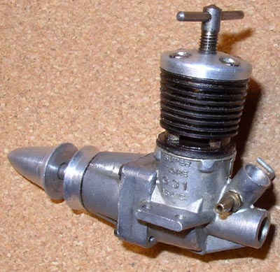

The diesel pictured is a G31 1.5 cc. There should be a rubber cap over the end of the backplate. I had one and though it a very good engine. There was also a similar G29, with red fins, at 1cc, and G30 at 2.5 cc.
George
