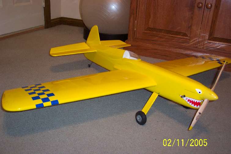

Old 02-11-2005 | 08:22 PM
green river rc's Avatar
Joined: Jun 2002
Posts: 1,036
From: Raywick, KY
Default RE: Crimped on vs wrapped.
Might fly it tomorrow.
Old 02-11-2005 | 09:01 PM
fox4evr's Avatar
Joined: Oct 2004
Posts: 68
From: Broken Arrow, OK
Hey, lookin good David. Let us know how it flys. Did you monocote the fuse, or is that painted?
