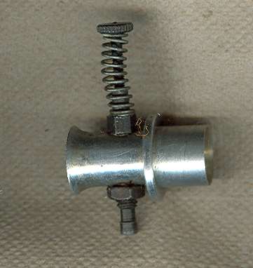

Anyone have any experience with a Fox 25BB? I just acquired what I think is a 25 although it could be the 19BB since it isn't stamped 25. I did notice it had an odd venturi held in place by a small set screw and the venturi didn't have any gasket under it. I might put a little RTV silicon under the lip of the venturi before re-installing it. The venturi measured out to .291 which seems a bit large although it seemed like the older plain bearing 19 and 25's from the 1970's had a fairly large venturi also. I'll probably use a 9-4 prop on it and let it rev like a 25FP. Since it's an iron piston motor I'll try to keep the oil content around 25% with a good portion of that castor . Here's a picture of the venturi. Does anyone know if this the stock needle valve that came with the C/L version. It looks like somethng borrowed from an older design. You don't see many larger engines using a coil spring to keep tenson on the needle valve much anymore.
