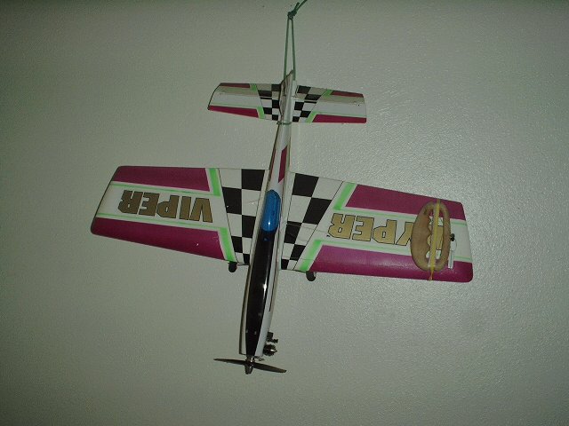

I bought a hyper viper about two years ago. The engine ran great after about two tanks. It is fast in level flight, but kind of shaky in maneuvers. It's on the wall in the living room now. If past experience with cox planes has taught me anything, it's that they degrade from fuel exposure after a few months of inactivity. I doubt if I will fly it again. I personally think the older super chipmunk was a better out of the box flyer.
