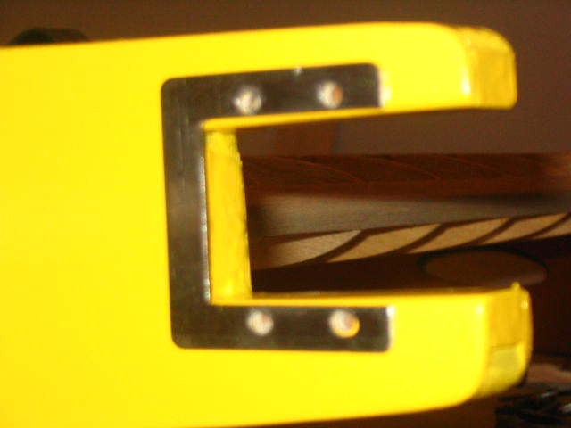

I'm not exactly sure about how much tip weight, I built a weight box in my outer wing tip and right now the plane will laterally balance slightly heavy on the outer wing, and I will probably add from that point about 1 ounce. Maybe somebody else will jump in here and give some more suggestions.
