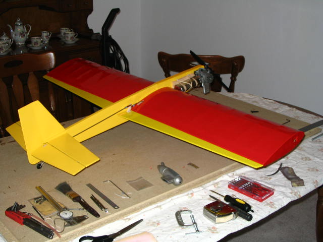

That is interesting, latex house paint. I think I had read some other threads somewhere about it, but I'm not sure.
I finished a TWISTER a couple months ago and used RUSTOLEUM on it. On the balsa I first used R-OLEUM wood primer and sanded each coat almost back to the wood to fill the grain. It still left some of the grain showing when I painted the wood parts, the wing I covered in ULTRAKOTE, since I had several rolls laying around. The R-OLEUM bright yellow and the U-KOTE bright yellow are almost a perfect match, and since this was just for "training" purposes, I wasn't too worried about the final outcome. But I think it looks okay for it's purpose, it won't win any beauty contests.
My next project I am going to try doping, as I plan on a full fuse plane and a little more attention to detail. And a better paint or covering job. Here is my TWISTER results, haven't flown it yet.
As things stand, the weather is supposed to be great for Sunday, and I am going to fly. We haven't had a break around here for months, weather-wize, so if nothing happens, I'll get to fly this weekend.
Hey, RW, that looks fine! Next time, cover the fuselage with silkspan before assembling the wing and fuse. You can also cover the wing and get it filled before assembly if you paint it. Then the grain issue mostly goes away. Not entirely, but mostly. I think you can get away with less paint, especially filler, too, saving weight.
I really like SIG Koverall, too. But it is pretty heavy for a stunt or sport CL. Scale builders maybe can tolerate higher weight than stunt.
The latex idea is so attractive, but a fuel proof clear is not a fool proof thing. For clscale-what works well as a top coat? Urethane, dope, auto clear?

Oh yeah,
Forgot to mention that the flaps are U-KOTE covered but all else is painted.
What I want to try for on my next plane is a good smooth transition from the wing into the fuselage. It's called a fillet, but how is it done? When I epoxied my wing into my fuselage on my TWISTER I used a large syringe and filled it with epoxy and sorta used it like a caulking gun. Maybe this isn't the way it's supposed to be done, but my wing is solid as a rock in the fuse. I did coat the balsa sheeting all around before I slid the wing in the last inch so the epoxy is on the mating surfaces inside the profile fuse to the wing.
I have seen pictures of other planes and some of them are really blended in well where fuse meets wing. How do they do it? Is it like wood filler that is used and then a finger tip or something run along it to give it a concave shape and sanded?
One thread somewhere mentioned making the fillets and gluing them on. So I am curious as to how to get a good transition from wing to fuse. What is the procedure most guys use?
