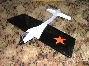

OK, cool. I missed the CL version. Based on the wing area, I wouldn't use anything bigger than the 15 LA. Let me throw on a picture of my son's little ship. It's 31" span, about 275 square inches and one pound. It flies like mad on the LA 15. You could use more engine, but the increase in weight ruins the benefit a lot of times, on CL planes.

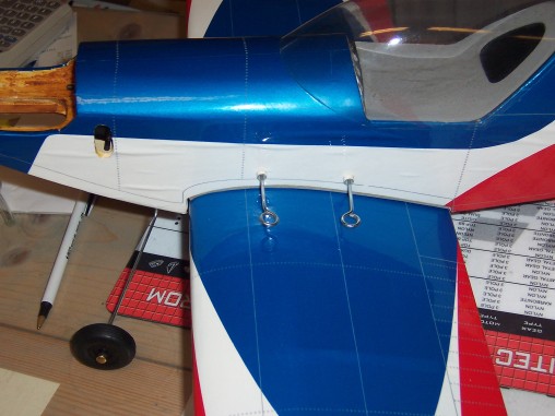

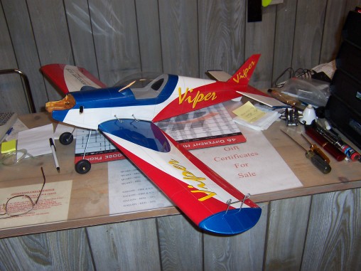

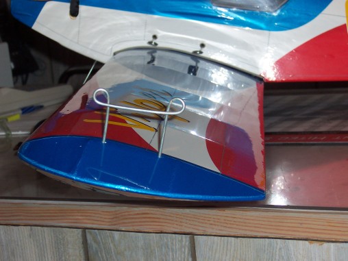

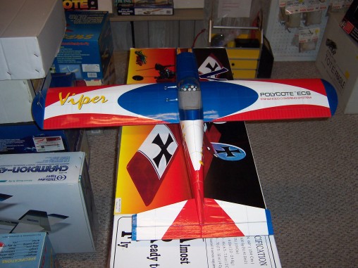

Ahah, Bobby sent me pictures. It's cute. The only issue we find on the low wing CL planes is that the vertical CG is high, so they roll out while going around the circle, flying with the outside wing low. That's why the leadout guides are mounted above the wing tip the way they are, to get the tether point closer to the center of mass. At 260 square inches, a mild 15 will be plenty of power.
