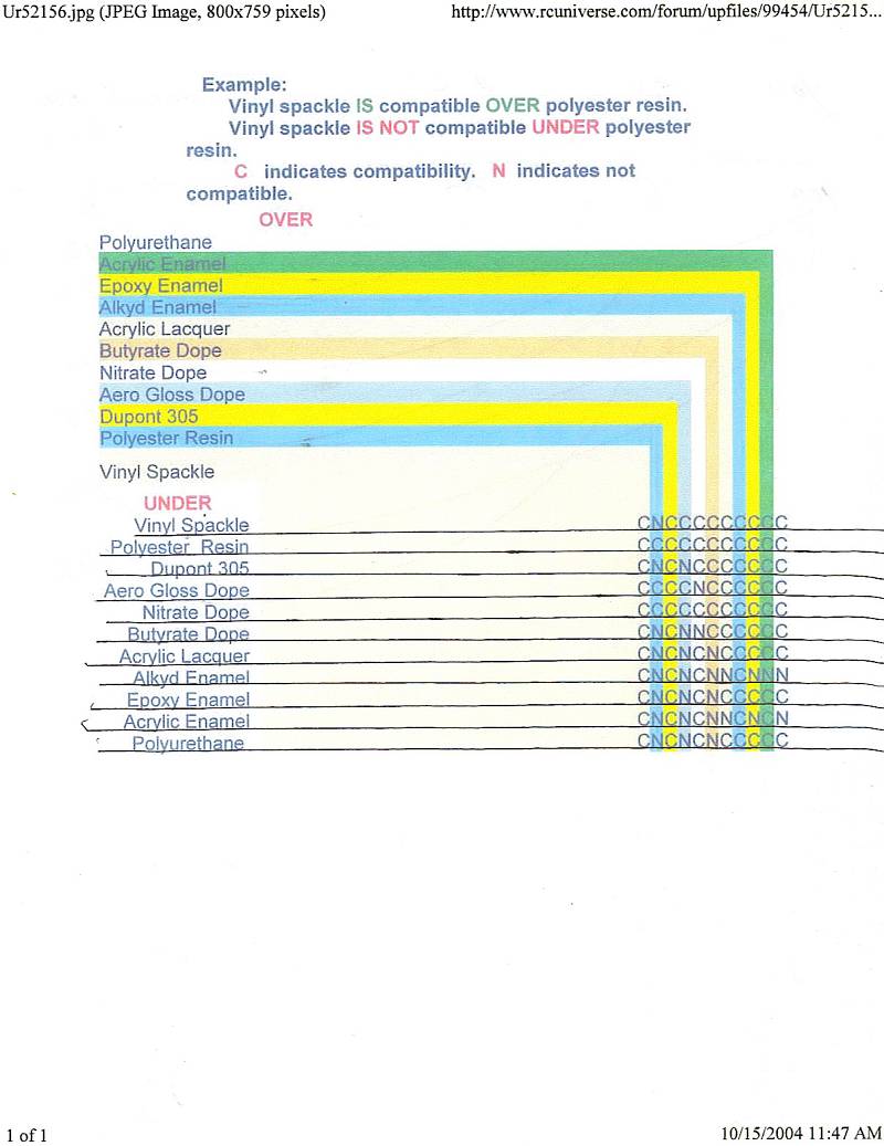

I recently purchases a used C/L airplane and motor for $10. I knew it was finished in Formula 'U' paints. Aero Gloss' manufacturer says they no longer manufacture the 'U'. I found some color spray cans down at the local hobby shop and purchased them. I have finished planes using other dope brands but never Formula 'U'. If i'm not mistaken, Formula 'U' isn't even a dope. I could use some advice on using Formula 'U' for refinishing my model. Do they have a clear? Does it come in bottles so you can brush it on? Any advice or help would be welcome. Thanks. Dave G.

Formula U was a polyurethane paint. they haven't made it for quite a while, I think. If you found some, I would expect it would be bad, and stay away.
For refinishing, I'd try to remove as much of the old as possible, and test compatibility of whatever I was putting "over."

I'm attaching a chart of what finish goes over an original finish. It's sort of a chuckle that it appears that Aerogloss won't go over Formula "U". Nor will Butyrate. Everything else seems to go over polyurethane.
Are there any covered open areas (like the wings), or is all the exterior wood?

Thanks for your help. If I read your chart correctly, I could put nitrate dope over the polyurethane 'U', and then put Butyrate over that. I don't want to go to 2 part mixes, the plane isn't that spectacular. If my idea is functional, it is a choice between Sig and Brodak dopes. Let me know if you think this will work. They plane is an old one and the covering over the wings (with open areas, not all wood) is tore in a couple of bays.

Yup, according to the chart, that'll work.
To refinish, you need to clean the surface and lightly sand it. I've cleaned the surface with soap and water and a soft brush in preparation to repaint, and discovered the finish look good enough to fly, and wound up not repainting. But whatever may happen, it's a good idea to wash the plane first.
After I washed that plane, I wiped it down with denatured alcohol. That's when it looked better.
You need to get the oil and dirt off. That's why I used soap and then alcohol.
