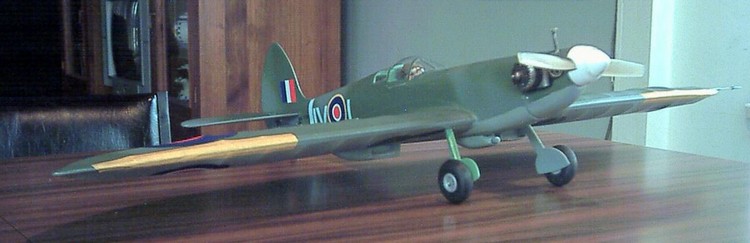

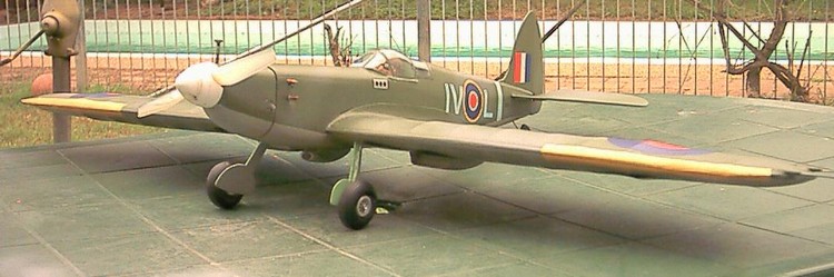

I've almost finished this Spit which was built from a plan. Span is 36", fairly lightweight and powered by an OS .15. I'm hoping to try it out next weekend..........John

Very nice model. Is it an Aeroflyte model? I had one of their second series Spits, not as fine looking as yours, but a beaut flier.

Hi Greg, the plan was published by MM Plans Service during the 60's I think. Model Maker was an Australian magazine apparently. Although I'm 58 YO I can't recall ever seeing a copy of it. A friend was kind enough to copy his plan for me. This one is mucher closer to scale than the AeroFlyte version, which I've also built and crashed ( a line crimp failed ) a few years ago. Thanks for your encouraging comments.........John

Looks good! It always seems strange to see a plane like that without dihedral ... the wings almost seem to droop. But I'm sure it's gonna fly beautifully. What's the finish, silkspan and dope?
Nice job on the landing gear, too. I like the scale look of the plane.

Hi Phil, you're right about the thick, flat wing. Doesn't look right, but its a concession to flight performance. The "droop" is an optical illusion caused by the gently curved leading edge. Considering the fuse. is so scale I was tempted to build a thin dihedralled wing to match it, but performance would have suffered.
The wing covering is indeed doped Silkspan. The fuse. is talc/dope mix sanded smooth. Paint is Tamiya spray can matt RAF colours, finished with a few coats of oilbased polyurethane clear matt. I printed the decals on my inkjet using MS Word........John

I have test flown the Spit., what a great model. Flew right off the plan, no ballast or adjustments needed. Good line tension, nice tight loops, very successful design.......John
