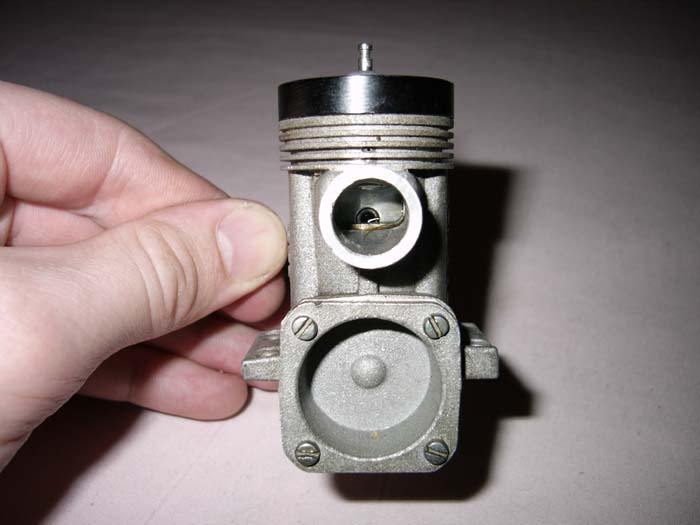

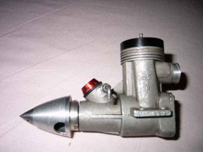

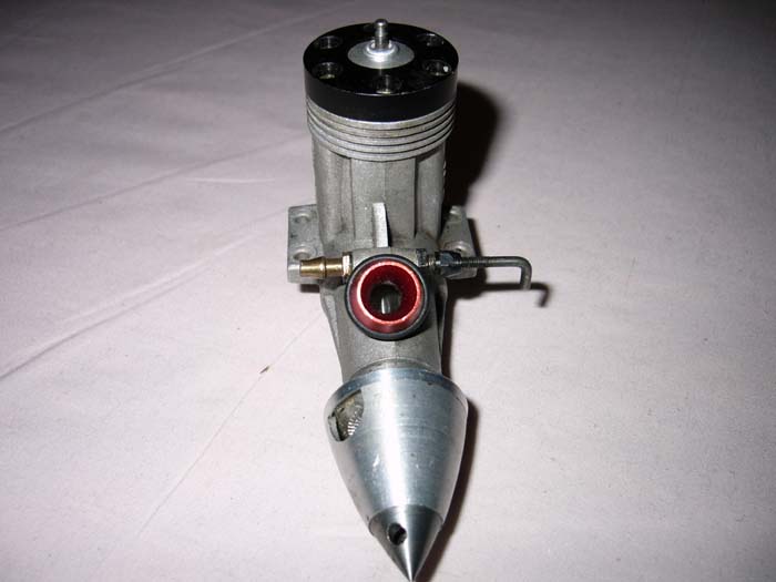

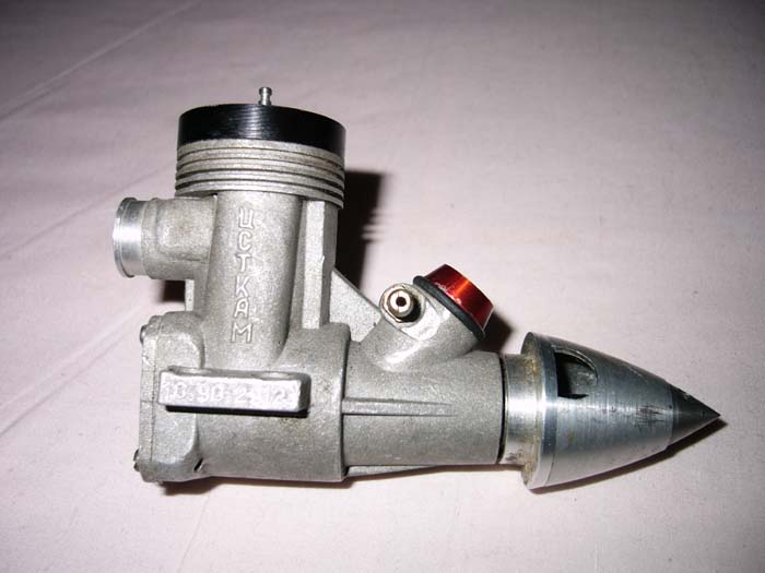

There is a commonly available motor ( ebay etc ) that is a copy of the Rossi .15 speed motor.
It goes under the names of MDS or summat like "UKATAM".
They usually come with a tuned pipe and are very fast, (28,000 rpm on a 6x6 or thereabouts iirc ) however take care if you are looking at bidding or buying one as there are plenty of new ones around and they can be got really cheap ( because there is little demand ) and some folks don't realize that and get carried away because it is a "racing motor".
I got mine new in the box for £20 with pipe, book etc.
Fitted with a Rossi style "button head" which lasts for ages and can easily be got anyhow

Here is the engine Ghost is talking about, the UCTKAM 2.5 (translation, CSTKAM) and they often come with a tuned pipe.
If you find a new one on the web make sure you strip and clean it. Be especially careful of the screws, they are fragile and shear their heads off with great ease if you are ham fisted. Also, the head appears to be drilled in situ for the mounting screws, the screws have a difficult time lining up if you change the orientation.
