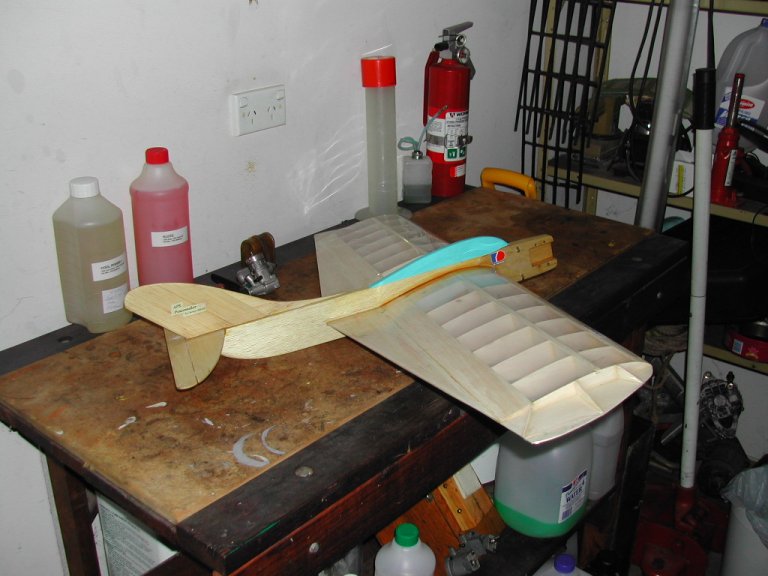

Thought I would show you a Peacemaker under constraction. I believe my looping problem is in fact toooooo much elevator creating a stall. How critical is the CG point.?

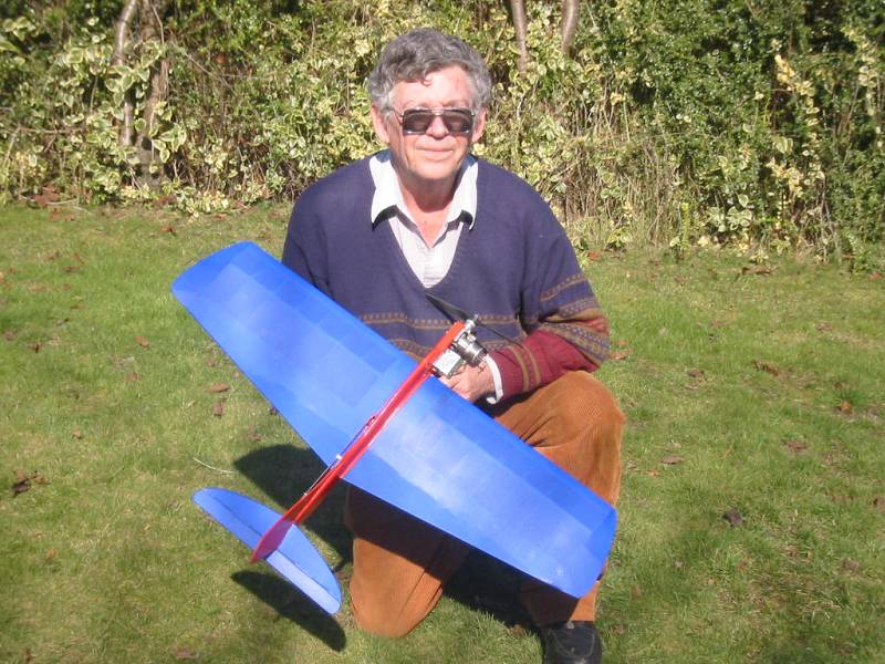

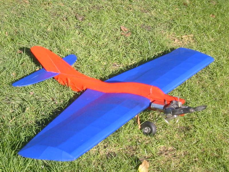

Here are a couple of pics of my present Peacemaker. Flies excellently, plenty of line tension and tight loops
Charles
My last one however was a bit "light on the lines" so I gave the rudder more offset and removed a little of the tail weight to bring the CG forward.
Charles
