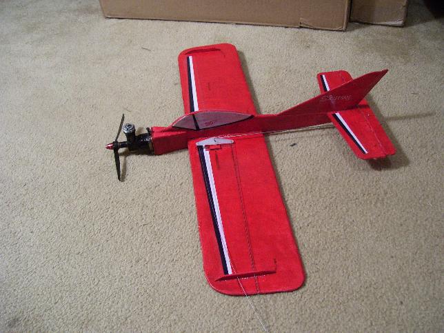

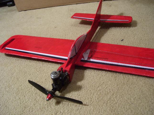

The Skyray came in today. I will probably get a start on it tomorrow, mabby finish if I'm lucky
. Anyway I have a spare can of olive drab krylon laying around. Could I use that to paint it?
I painted mine with Sig dope. One 1/2 pint bottle is all you need. Some LHS carry it, at least mine used to.
Make sure you get the CG right. I had to add quite a bit of lead on the nose to balance with a Cox 049. I tried flying it slightly tail heavy at first.... bad idea!
My Feedback: (15)
The Skyray had a vary eventful first outing today. First flight; ended after a half lap when the Cox .049 quit. Second flight; something (most likely wind) made the plane pitch up and turn inside the circle and head right at me, I ran like heck and had a good laugh when it hit right where I had been standing; third and fourth flight went well. fifth flight I somehow let go of the handle and the plane headed right towards the car hitting the rear left window, A good surprise for my mom and sister inside (good thing they had the window up
) Sixth flight; cut short when the engine ran out of fuel. All in all a pretty good day and the skyray has gained a reputation for being homicidal.
