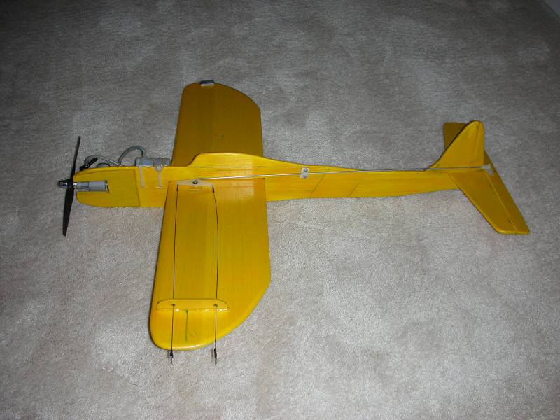

Thanks for all the suggestions. I have a couple of more questions that I forgot to ask in my original post--
How is the amount of weight on the outboard wing tip determined. I have a 1/2A Skyray that has two pennies glued on. I believe this is to counter the weight of the lines.
Just goofing around, I am putting together a 24" profile, slab wing WS 26", stab/ele 10" to fly on a the AP .09. I have 30 ft lines (not SS) from the 1/2A. Would these be long enough or should I get .15 x 60' SS. They are available at my LHS.
Thanks again.

I think the 30 ft lines will be too short and the 60 ft lines too long. [] Should be able to order a set of 52ft 012 lines. That will be about right.
If you get serious you need an adjustable weight box. I make mine out of plywood and put a thick piece of ply on one side. Drill and tap 1/4 x 20 and seal with a Nylon bolt. I use BB's and put them in, or take them out, five at a time. Two pennies is about right for your 1/2A Skyray.

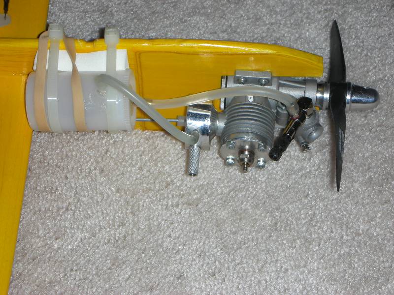

Well, I am ready to give it a try. I call it the CL TLAR. (That looks about right.) Here are a few photos. The first version was so nose heavy, I decided to lengthen the fuse a full 2 inches. Now it balances about an inch back from the LE. I also replaced the 1/8: balsa tail feathers with 1/4 inch. I was a little disappointed the Cub Yellow Lustre Coate didn't cover a little better. I had prepped the surface with a dope sandable sealer. Again, this is just an experiment. I have a larger tank, but am afraid the run time will be too long, so went with a film can. I plan to fly it today on 42 foot dacron lines. Flight report to follow.

Flight report--had difficulty getting engine (Hornet .09) to run. Finally mentioned that I had replaced the crank shaft, after a crash, and the guy helping me asked about the orientation of the cylinder sleeve. Removed it and sure enough, I had it oriented so the exhaust and intake ports were reversed. fixed the orientation and the engine jumped to life. First flight was great. Lots of line tension on about 42 feet. Large well rounded loops. I did not try inverted or outside loops. The film can tank was just about right. Started to get dizzy just as the fuel ran out. Second flight, I pulled down when I should have pulled "up" and in she went. Cleanly broke off outside wing. Seasoned CL guys that were watching told me it could probably fly just fine, with just half a wing! Since I had already wound up the lines, I didn't try. Have repaired the wing and am looking foward to calm weather for additional flights. BTW, the Hornet with its stock muffler is exremely quiet. I might try a CL plane with E power if I can figure a way out to cut off the battery before it draws down too far.

Yea, that plane looks like it would fly on half a wing. I've done it many times when a wing was wrecked in the middle of a combat match.
