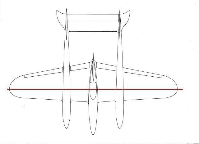

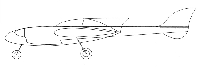

This winter I'm in the mood for a new stunter. I've been playing around with the idea for a twin engine, twin boom plane, similar to a P-38 for several years now. I've just about finished with the working plans, and should start cutting balsa after New Year.
The plane will be .60 size powered by two OS .35 MAX-S engines. I have a 60 size foam core wing I bought at a swap meet and a small collection of OS engines, so why not? Here are some drawings. Of course, any comments and help will be appreciated.
Steve

Looks like it might turn out very nose heavy

Hi cutaway. I was thinking that too. But a couple of years ago I re-covered a Mosquito Bomber for Jack Sheeks. I took the measurements of his plane and used them to layout the moments for this one. His plane flies great. I'll ask him if he added any tail weight.

I had a twin Mustang years ago with a pair of McCoy 35's. The line tension was beastly. Had to be at least 15lb @65mph or so. Its wing wasn't too fat so it was moving pretty quick. Might fatten up the section to something like that in the Strega just to slow it down some.

The foam core I have was cut for a Genesis (at least that's what I was told) It's 2 1/4" thick. Looking at the plan view, it's easier to see just how much of the plane is behind the C.G. It's 7 1/4" from the thrust washer to the leading edge, which is pretty close for a stunter. My Nobler is 9" and my Banshee was 10" before I shortened the nose.

Banshee's nose was just flat out too long for any reasonable sized engine ;->
In reality the only reason for nose length is to get the CG close without needing too much weight in the tail or to fit a tank in. The shorter the better.
I think if you went with light booms (like a silk covered rolled balsa tube) and a built up rather than plank tail, the tail is going to come out very light. Probably in the 5oz or less range after paint.

I'm really not trying for any kind of scale look. It just happens that a twin engine, twin boom plane looks a little like the P-38. Actually, I stretched the nose to get the moments right. There seems to be a "sweet spot" for nose length on stunters. Too long and it's sluggish, Too short and it's jumpy (like a combat ship). I'm not an engineer, so I'm sticking to moments that work well on a host of other stunt planes.
