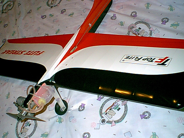

I want to try C/L flying, and was wondering is the Top Flite Flite Streak ARF anygood? I normally build RC kits this time I want to try it before I build a kit. I have a OS .25FX and a 40LA which would be best?

I just destroyed a TF Streak, the sub par aspects are the build quality of the fuselage, and landing gear, its way too flimsy. Would recommend you build a new fuse from scratch using solid balsa, maple mounts, and 1/8th 5 ply doublers, and a decent 2-1/4 wheel. Make sure the mounting holes for gear are going through maple as well, you can use the landing gear wire they supply but if you’re running 9" + props you may need to up-size this part too. As for power plants, I was running an Enya 30 and had too much power for the plane, would stick with the .25" Hope this helps, Regards, Mike.
Joined: Aug 2007
Posts: 340
From: Brisbane, AUSTRALIA
Oh and forget about setting the CG as the instruction suggest, there hopelessly wrong! I would say between 1-1/2 and 2 inches from the leading edge is best, start at an inch and work it back to suite you style. Remember nose heavy on a control line plane is much less touchy than tail heavy.

The Flite Streak ARF is a good way to start. The 25 with an 8x5 or so prop is the way to go with this model. There are guys flying in Beginner and Intermediate levels of competition aerobatics with this model, it's a very good flyer. Use 55 foot, .015 control lines, they can be cut down from 60 foot pre-made lines that you can buy.
The other Flite Streak comments are correct on CG and how the fuselage is lightly built. If you have building experience the repairs will go in a straightforward manner, if you need them. I have used every part except the screws (replace with 4/40 sockets) on all of the ARF's I've built for the kids. Use what is there unless it isn't working before looking to replace parts.

The original Flite Streak called for a baffle .19 to .35. Your OS .25 has more power than the old .35's. Forget anything larger. Some have flown the FS with an OS FP-.15. A .20-.25 seems to be the preferred size. The ARF Flite Streak would be good as a second plane...after a trainer.
Do pay attention to balancing it about 1" to 1.5" behind the leading edge of the wing. Several flyers have reported losing the plane because it was balanced too far aft.

I fly my streak with a 10X4 on 5% fuel, on 60 foot lines and it is pretty fast.

Flite Streak ARF, ALL STOCK airframe, pin hinges on elevator (DO NOT use CA hinges), OS .25FP (C/L version) w/ tounge muffler, 10x4 prop, Brodak uniflow wedge tank (around 2.5 - 3oz. I think), Powermaster C/L fuel- 10%nitro 1/2cas-1/2syn oil, 60ft lines.
Running the motor in a very wet 2cycle and getting about 5.0sec laps.
