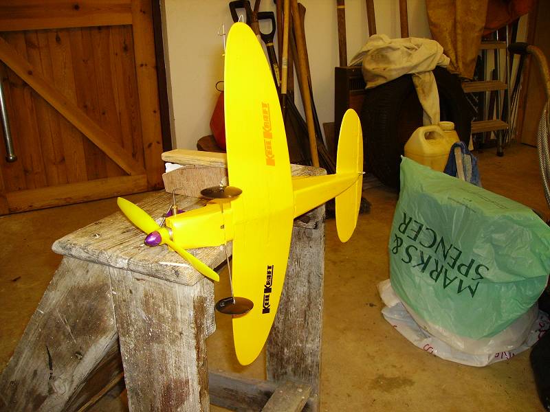

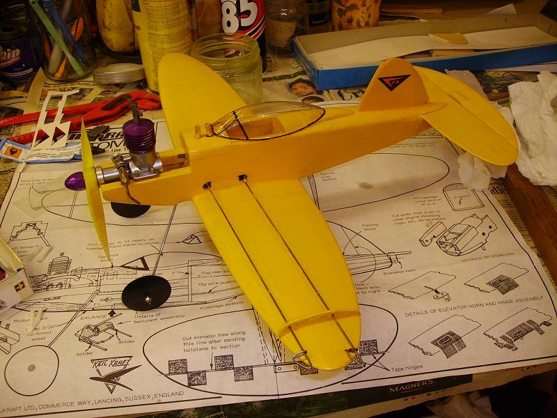

Thats great thanks! Is there a certain grade of terylene i should get? also where do you source it from? here are some photos of how i have been getting on.the engine and canopy are just sitting in place at the moment! thanks

Hi Chris,
That's nice work. Is that a PAW 1cc up front?
It would be of help to you to fly with other control line fliers in your area. Where in UK are you?
If you haven't already found the Barton Forum, let me recommend it to you. http://www.controlline.org.uk/phpBB2/index.php
Personally I wouldn't use and fabric lines, instead I'd look for some .008" Brodaks do them, you may also find something suitable in fishing tackle shops.
Good luck with the Mite.

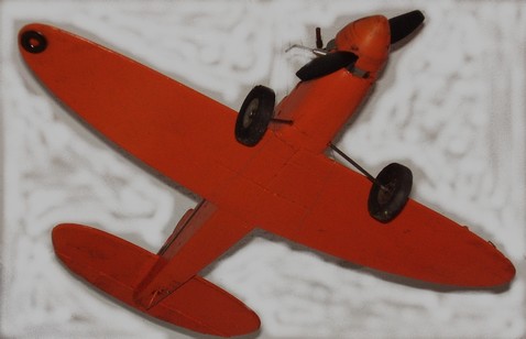

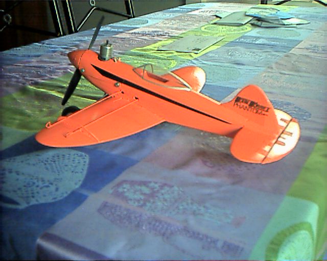

Re the tip weight, my Mite did need a small washer glued under the wing tip ( see photo ). I flew it on 35' Laystrate, not much line pull with my model so lighter lines should be O.K.
I've a attached some pics. of my Mite, which, still gets flown sometimes, although it did become a bit of a Hangar Queen when diesel fuel became very hard ( impossible ) to find here in Australia. I mix my own these days, problem solved........John
