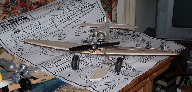

I’m building a Phantom from scratch, starting with the plans which I found online as an A4 sheet and enlarged to scale with Page Plus. I then cut and taped the parts together to make a plan and had them copied onto one sheet by my local copy shop. I had 3 sets made, 1 as master, 1 as working, and 1 to cut for pattern pieces.
The pattern pieces were tacked to the balsa and have been rough cut.
The photo shows the wood cut ready for finishing and assembly. Also a piece of GRP circuit board which I etched the copper off to make the bell crank. The engine is also lurking there somewhere. (Poser)
I have the plywood for the firewall/undercarriage support and bell crank support but it is not cut yet as I will cut it oversize and fit to the fuse as it is built so I get a very good fit. I also have the piano wire and wheels ready to fit.
The tank will also be made to fit the space available. Whatever happened to the tin oil can? plastic just doesn’t solder the same and a surprising number of tin cans are made of some alloy or other, again not ideal for soldering. Still I have some tin sheet I robbed from another project that will do the job.
I will post more pics as I progress with the build, and some more boring drivel as well if anyone gives me the slightest encouragement.

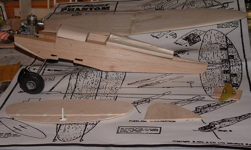

Here we have an over view of the parts. the port wing has been shaped and is ready for covering, the starboard wing is just rough carved. The fuselage has the bearers glued in place. The tail is rough cut with the elevator shaped and ready for covering. On the right are various formers and the fin. It also shows the bellcrank mounted on its bearer. The bellcrank is made from a bit of GRP circuit board. The former is going to have the undercarriage "sewn" to it.
The copied and enlarged plan can be seen under the parts in pic 1.

You probably already plan to do it, but you might want to chamfer or radius those bellcrank holes unless you are using solid leadouts.
George

Hi George. The holes are not full size yet, just pilots, but I will be using solid leadouts on this model.
Good tip though for anyone reading this who is going to use flexible leadouts on their models. On larger models I also sometimes run the leadout wires through soft brass tube in the bellcrank to stop the wire sawing through.

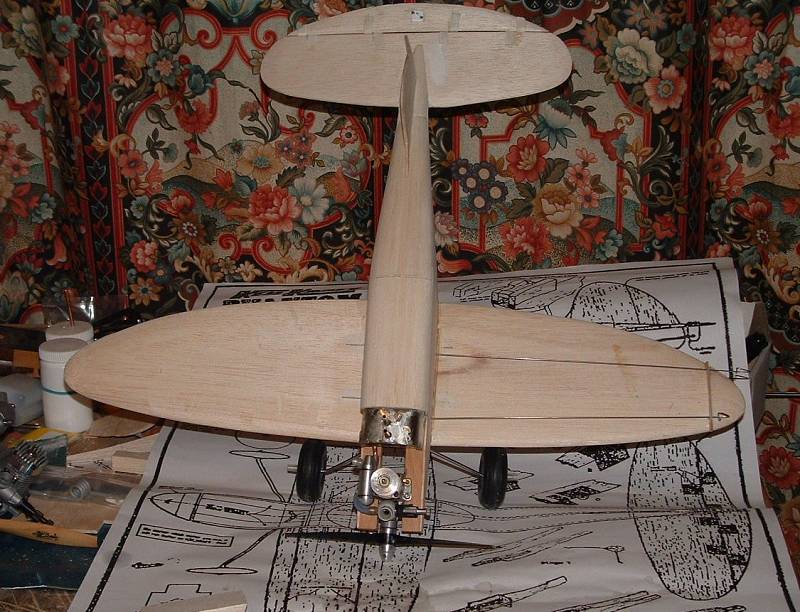

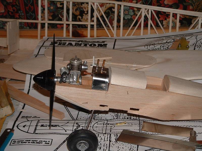

Coming together nicely now. The wings are made and joined, filled and just need sanding before tissue covering and doping. The fuselage is joined and the engine bearers drilled. Fire wall with the undercarriage is fitted. Not in the pic but the bell crank has its wires fitted ready to install.
The tail is ready for covering and having the hinges fitted. Not sure yet if I am going to use small rc hinges, tape, or sewn. The control horn is a small rc one. The fin is the only part that is only cut out and had no work done on it. The fuselage top block is rough carved to shape.
The tank will be next to be built and fitted followed by the cowl.
Taking into consideration I am building a medium sized rc model as well, things are coming on well.
Looking for ideas on colour scheme now.

It looks really good! I do hope you plan on hollowing that top block or you may face a tail heavy model. The completed model (less covering and finish) should be significantly nose heavy else you will need to add lead ballast to the nose and that will hurt overall performance.
Good job and keep up the good work!

Yes the top block will be hollowed before sticking down. The tank will be forward of the CG which will help a bit. If it ends up too tail heavy I have a bigger engine I could fit but then it would be rather overpowered. (.015)

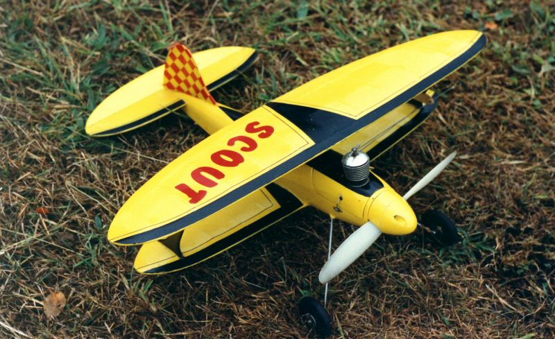

I came across this pic. It looks very like a Phantom biplane. Might build that next just for a bit of fun.
Wonder what size engine to put in it taking the wingspan to be Phantoms 21". About a 2.5 cc maybe. What do you think?

I believe that would be plenty of engine-assuming that my conversion to .15 cu. in. is correct(Silly American-that's me!)[8D]

Yes I think you are right .15cu in sounds about right. I was wondering if it might be too much engine for the size. I suppose the only way to be sure would be to try it and see.

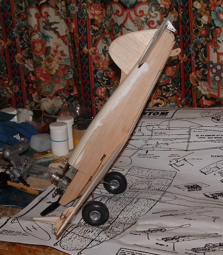

Not a lot of obvious work but quite a lot of progress. The tail has been completed ready for covering. I went with the cloth hinges and a small rc control horn as can be seen in the pic.
The main fuselage blocks have been shaped and the top fuselage block has been hollowed out. I might do a little more on this but with my luck I would go through it.
The fin has been shaped but still needs sanding to an aerodynamic shape and the offset being put on.
I have made a paper template of the tank which will be half round and mounted behind the engine on the firewall. I hope to cut the tank and solder it over the next couple of days.
The cowling I am not sure on yet. It might be balsa or I might go the beer tin route, or even both just for the hell of it. Then it needs covering and doping, fitting it all together and finishing it. Still no ideas on colour scheme yet though

The fuel tank Mk1, Im not happy with it so will have another go.
I think I need a bigger spinner otherwise I have a lot of wood to lose on the nose.
