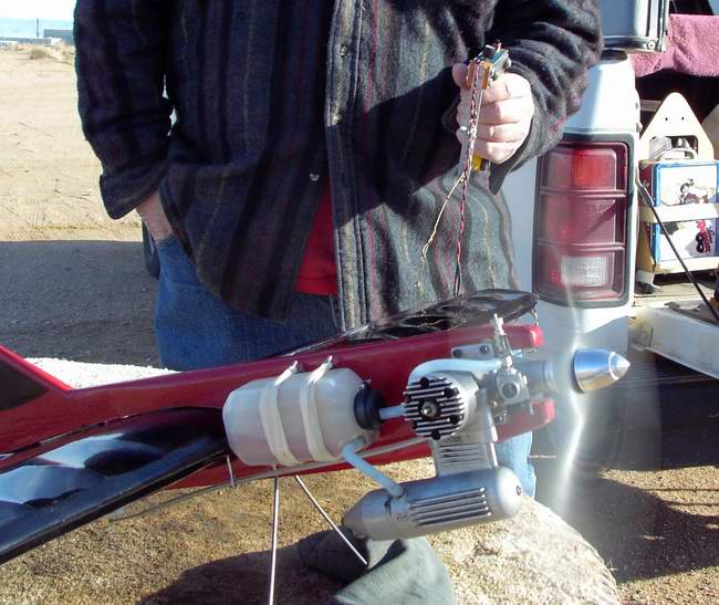

ORIGINAL: iflyg450
I do have a OS 25FX that I could lock the throttle open on????? What are your thoughts on that????
If you do not buy the Super Tiger you mentioned then there is no reason at all to not use the 25 FX Its a wonderful engine and I use a lot of them for RC but do use an old throttled 40FP on my magician with a tetra bubbless tank and its wonderfull.
John
