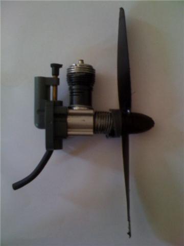

I recently bought a Cox .049 engine from ebay and before I put this on my first C/L model I need to know some things. What fuel does it take? How do I remove the head? What's the hole on top of the back plate for? and How do I tune it?

The pictured engine is obviously an engine removed from one of the many many that cox provided for various vehicles along their toy road.
It looks like the fuel enters from an outside tank through the black fuel line. It looks like the long stem on top is a form of needle valve.
To change glow heads, notice the small indention on the silver glow head (one each side). That is for using a cox engine tool to unscrew the glow head. Without such tool, I have found that a nice pair of needle nose pliers, properly applied, can perform such task. There should be a copper gasket under the head. Use care to save it.
A tip that is seldom advertised or spoken of, is that small engines like a lot of cooling oil. Most users speak of the requirement for high nitro. That is incorrect as far as the "NEED". The standard cox .049 is very happy with a 10% nitro, and at least 20% castor oil. I have 3 that I have been flying with, kids using my original design models ranging from 18" w/s to 24" w/s, two being almost 20 years old and one only 8 years old. They start easily with the spring starters, are easy to needle using the stated fuel (old ducted fan engine fuel) and run very well, certainly well enough for sport use.

The hole at the top of the backplate is called the snorkle tube-holding your finger over it while hand turning the prop will help prime the engine[8D]

Thanks, I just need to know one more thing though, why is there a hole on the support behind the knob? I think its the air intake but I'm not sure.
Old 08-22-2009 | 07:14 AM
Phlip's Avatar
Posts: 635
From: Auburn, MA
Default RE: How to use cox .049?
Yes, 509boatman55 just answered that. He called it the snorkle tube, which makes sense if you know that the normal air intake for plastic-backed Cox engines is in the center of the backplate. This one has the intake extended up toward the needle valve in a snorkle-like fashion.

3D 4 ME,
The engine was installed in some RTF planes and was also sold separately as the "Sure Start".
Check out Blackhawk Models, they are just now introducing some CL planes specificly designed for that engine.
