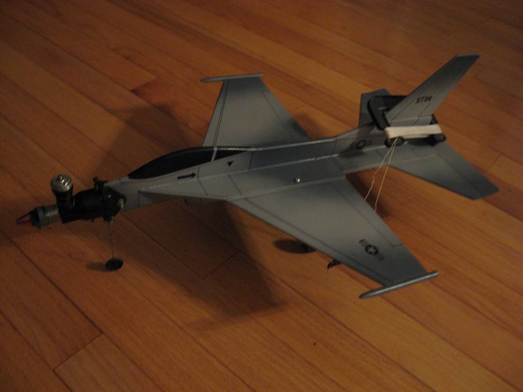

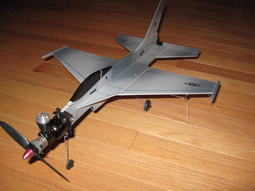

I have a few questions regarding the Sterling F-16; I assembled this kit basically stock some 10+ years ago and enjoy flying it straight and level on occasion...(took pics to post here) Is the A-10 complement available in plans form? Is this type of airplane (F-16) capable of looping successfully? Just as a matter of interest, I remember having lots of fun with a Sterling Junior Ringmaster Bipe and one of their warbird series - the 1/2A profile Spitfire - are these at all available as plans or after-market/mfg kits?

I've never flown the F-16, but just looking at it Ican imagine that it has way too much weight forward. I'd remove the engine/mounts and cut the fuselage back as far as possible (looks about like 1") and then remount the engine. I'd also increase the elevator area by about 25% or so.
Good luck!
P.S. Nice job on the finish!

That is a cute model - you did a nice job on it. I have to agree that with that long nose, this model will be extremely nose heavy and very hard to add enough lead to the tail to fix it. If you want to slap together something more aerobatic, I would suggest getting a Sig 1/2A Skyray - builds quick and flies well.
