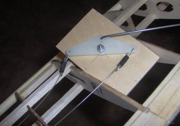

The bellcrank, pushrod and lead out assembly was attached to the plate and glued in place. The bellcrank pivot bolt seats on the bottom spar.
I like to use plastic coated game fishing wire and matching crimps for the lead outs. The correct crimping pliers crimp along the sleeve, not across it, which can cut the wire inside the sleeve. The wing tip leadout guides were epoxied in place. Everything is operating smoothly and as it should be, so I'll sheet the centre section next.........John

Looks good.Is the leading edge a round dowel?What is it made of?

Leading edge is 3/8, (9mm) birch dowel from SIG. Span is 38 inches... (96cm)

Is this a common practice, i haven't seen this before, but i'm pretty new to this.

Pops up on occasion. It's strong, readily available, relatively cheap and pre-shaped.

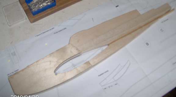

The wing is pretty much finished, more sanding and finishing needed. The wing flaps will not be moveable, they'll be added AFTER the wing is fitted to the fuselage.
The ten pieces that make up the fuselage have been all glued together over the plan. I find exterior PVA plenty strong enough, but, you could use epoxy for the nose area and engine mounts. I had a small problem removing the ply doublers from their sheet, needed the scroll saw to avoid damaging them.
All going together nicely, most of the hard stuff is done now, I'm offline for a few days, see ya Tuesday.
