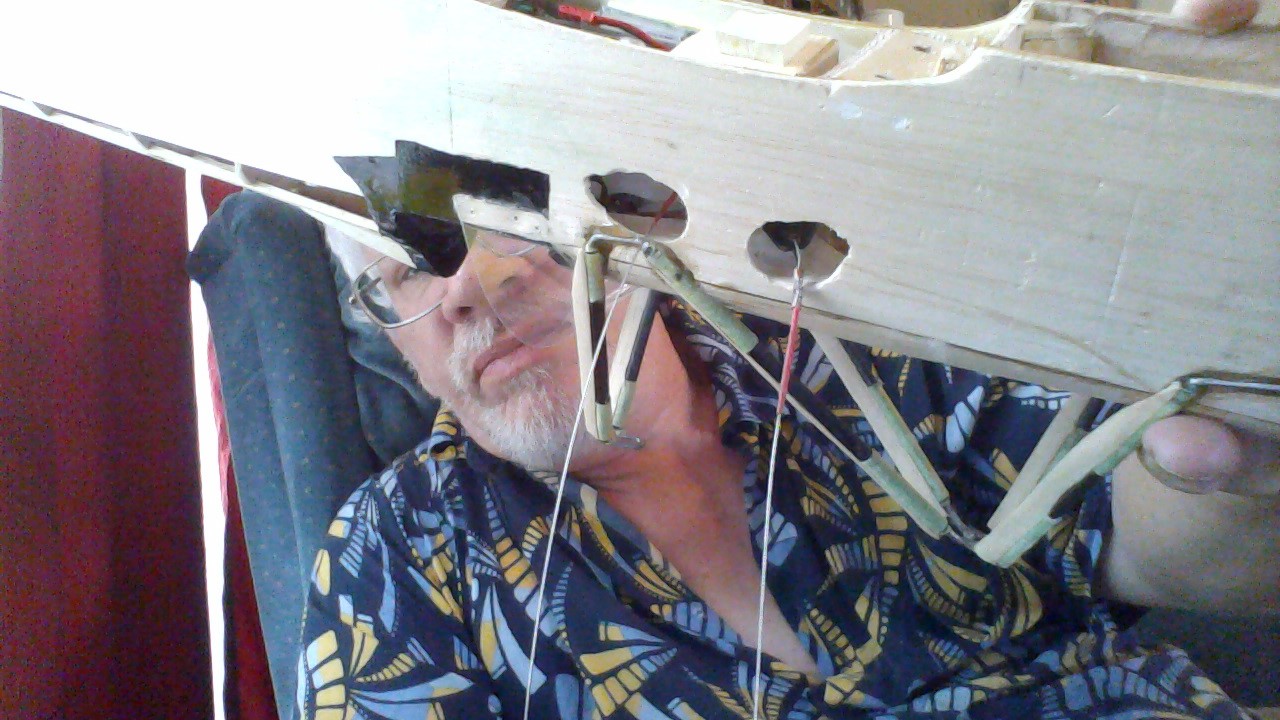

flyingagin 09-17-2014 10:49 AM
1 Attachment(s)
Ok A question guys.
My bell crank is cut from 1/8" carbon fiber sheet. The lead outs are .027 lead outs.
I installed a 5/32" od 1/8" id brass tube at each end flush on both sides with the plate. Inside of that is a piece of 1/8" od brass tube that is free to rotate. It is a bit taller than the in brass insert. I have rounded the inside off. Is that suffecient to avoid damage to the lead out wires that loop thru this?
Ken
skylark-flier 09-17-2014 10:58 AM
Hey Ken, as far as I can see there's no problem with your tubing for the wires - although the opposite might be more to the point. Over the years I've had to replace a couple cranks because the wires cut into them - - wires were OK, crank wasn't. Leadout wires are TOUGH, apparently they're quite a bit tougher than aluminum cranks. How I solved it (at least, they've managed to hold up now for almost 30 years) was to use one of the lipped brass tubes that you normally use for servo mounting. I drilled the crank hole big enough to take that tube, then folded the bottom (straight side) of the tube back. It rotates inside the crank hole, along with the leadout wires.
Seems to work just fine.
flyingagin 09-17-2014 11:09 AM
Yeah Dave, lead out wire is tuff stuff. I know it it cut thru the carbon plate in nothing flat.
Well it now has 2 brass tubs to cut thru, and the inner rotates. At least I hope it will rotate with the lead outs. A drop of ATF might help that.
Ok back at it.
Ken

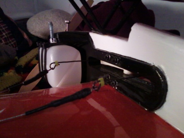

flyingagin 09-17-2014 07:17 PM
2 things
Is it ok if the lead outs do not go past the wings. They end right about at the ends of the , maybe a little less once termintated. I can always make another set. I have the cable in a drawer.
2nd issue. The lead out terminations at the bell crank are hitting the fuse. Cant move or revers the bc. I can make shorter terminations but they will still hit. I may just make the holes bigger,that is the simplest. That coupled with some sort of guides
Ken

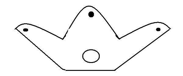

skylark-flier 09-18-2014 06:38 AM
1 Attachment(s)
Originally Posted by flyingagin (Post 11882944)
2 things
Whether the lead outs go past the wings or not isn't an issue - whether they clear the guide with full elevator deflection is the issue. I'm super conservative with "clearances" - I believe in getting all I can get. If I were building this plane I'd be making sure that there's no way the leadouts come closer than 1" to the outside of the guide. I'm assuming your guide will be part of the outside (left) wing strut. With full elevator deflection I'd want the leadout no closer than 1" to that strut.
Ken
Hokay, got an opportunity here, and you know you've got 2 choices - either of which are good. If your aim is simply "movement and control" you can/will simply make the holes bigger. No problem. Guides wouldn't really be all that necessary, you just CA the edge of the fuse side where the hole is.
HOWEVER, is your aim is to get your movement & control maximized AND keep your appearance as clean as possible, you're going to need to re-design your belcrank so it doesn't hit the sides anymore. It might look something like this:
http://www.rcuniverse.com/forum/atta...mentid=2033231
Forgive the crudity of the drawing - took about 3 minutes using MS Paint, but I think you get the idea. I had to do this same thing many years ago when I was building my Skylarks. The belcranks kept beating up the first rib inside the wings and they'd eventually jam when the slot they were creating got big enough. I just built my own belcranks (thus keeping the near 90 degree elevator deflection that I like with the Skylark) and went with that. Only thing you have to do with a design like this is to make sure you bend the crank up a bit on the "up" side so the rod to the elevators doesn't get hung up on it when you deflect for down elevator.
Of course, you're making the belcrank out of carbon sheet which probably doesn't bend real well, so you'll have to cant the whole mount a few degrees instead, which will give you a "low" leadout and a "high" leadout, but I don't think that's really much of an issue either.
Just some ideas.

I opened up the belly (just remove some screws) for a better look. Made some drawings of fuse belly area where the B.C. is.
Laid the B.C. with a small post thru it at the pivot point. Played with the full rang of motion so I could see what I was up against.
Conclusions
#1 I am an IDIOT
.................Those are the very steps I should have done when I first started to pencil out this bird .......DUHHHH
#2 I can resolve this issue. Just need to open up the lead out exit area a bit, but selectively. Open towards the center of the B.C. and up.
Also redo the lead outs. Use smaller brass tubing to swag the cables and make them long enough to exit the sides of the fuse, even when that line is fully in the fuse as the opposite line is pulled. And do a much smother wrap of the folded over lead out wire end. Then I can partially close up the holes, leaving just enough area to play nice.
Got to wait till next Wednesday to get the small tubing.
So will work on the lead out guide. I did a scrap balsa mock up, so I have some ideal of what is needed. The intent is to be fully adjustable.
Line spacing apart
Lines spacing fore and aft
And line position up and down.
I have ideal that I got to play with to get it work and achieve minimum wight and screws.
Ken
flyingagin 09-19-2014 10:15 AM
5 Attachment(s)
Had plans to go out in the car and take of some things. But there has been localized flooding. Went thru some yesterday that came up to the floor pan. A bit scary. So there was now way I was going out today in areas I did not know flooding wise.
So I have been working on the plane today off and on.
Cooked some lunch. Beans and rice in the belly. The garage is going to be a dangerous place to be!
2 shots are when I figured out I had a problem and enlarged the exit holes. http://www.rcuniverse.com/forum/atta...mentid=2033521http://www.rcuniverse.com/forum/atta...mentid=2033522
Thees 2 are after I realized I could relocate verticaly the B.C. That helps a bunch. I just reversed the pivot rod. I can adjust things so I split the difference vertical some. http://www.rcuniverse.com/forum/atta...mentid=2033524http://www.rcuniverse.com/forum/atta...mentid=2033525
The last is an ideal posted by John on the BHOTR I will play with also.http://www.rcuniverse.com/forum/atta...mentid=2033518
Ken
