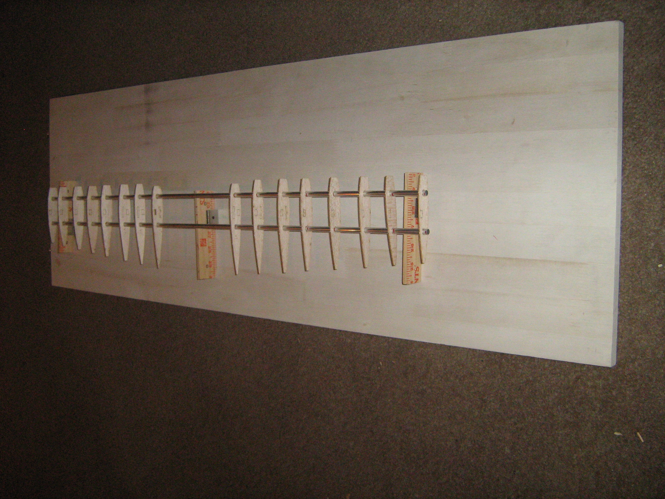

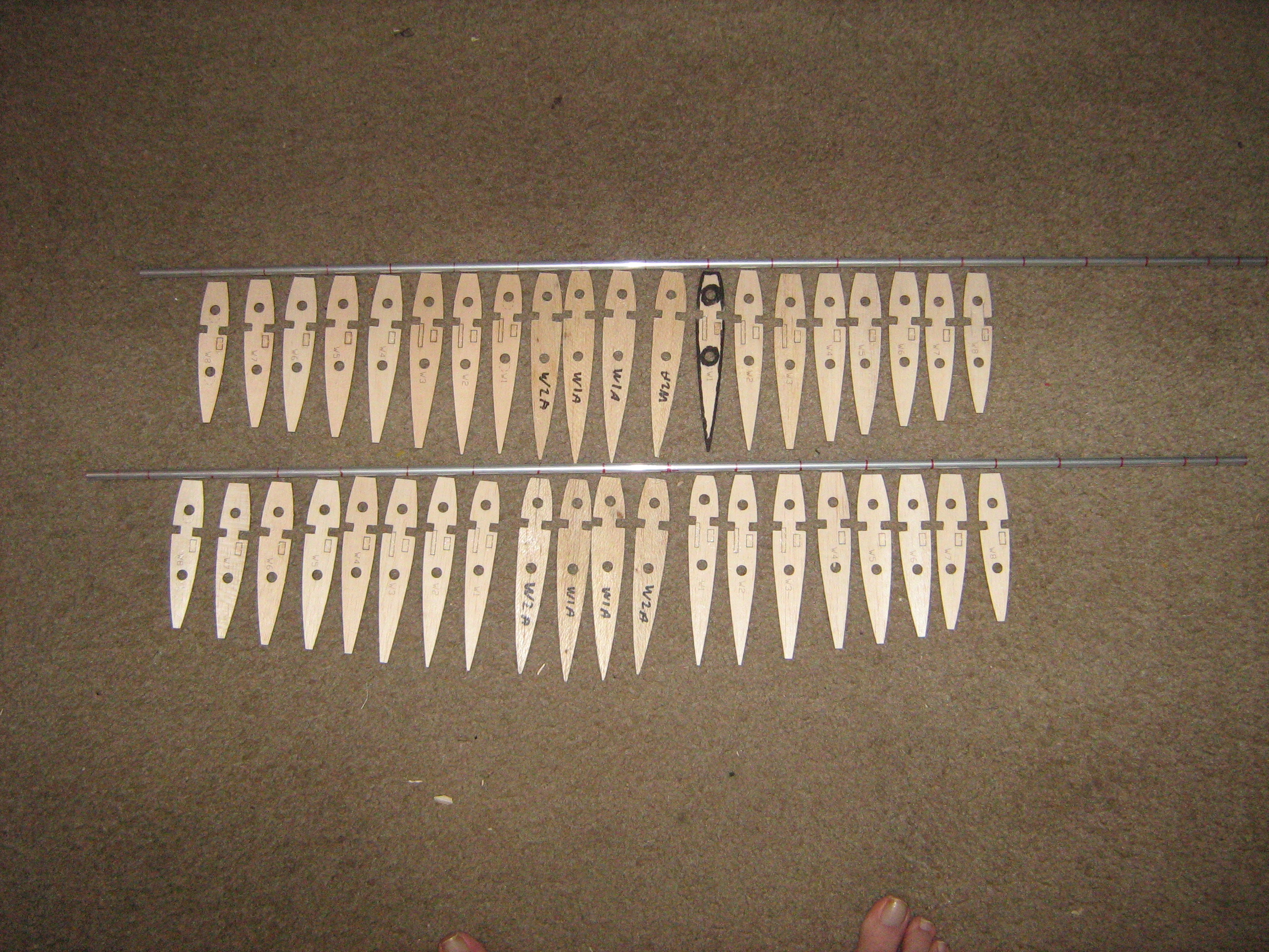

I also bought some aluminum shafts that match the round holes in the ribs. I will build with all the ribs mounted on them above my magnetic building board. I cut into 6" lengths a wood yard stick. Next I need to mount a magnet to each section. My magnetic board will set on top of a balsa laminate building board. It is pretty close to dead on, but at one end their is a very slight bow, about 3 or 4 paper thicknesses as check using my good aluminum 4' level. I left it on the card table to long. it was more but I leaned it against the wall at a pretty good angle and it almost fully straightened out. Now I have it hanging vertical and will recheck it in 2 days.
I have to make 3 center ribs. I will make 4, just easier. I will bolt 1 wing panel of ribs together with to blanks on the end, and the shape the 2 extra ribs. I will just have to real careful not alter the original ribs.

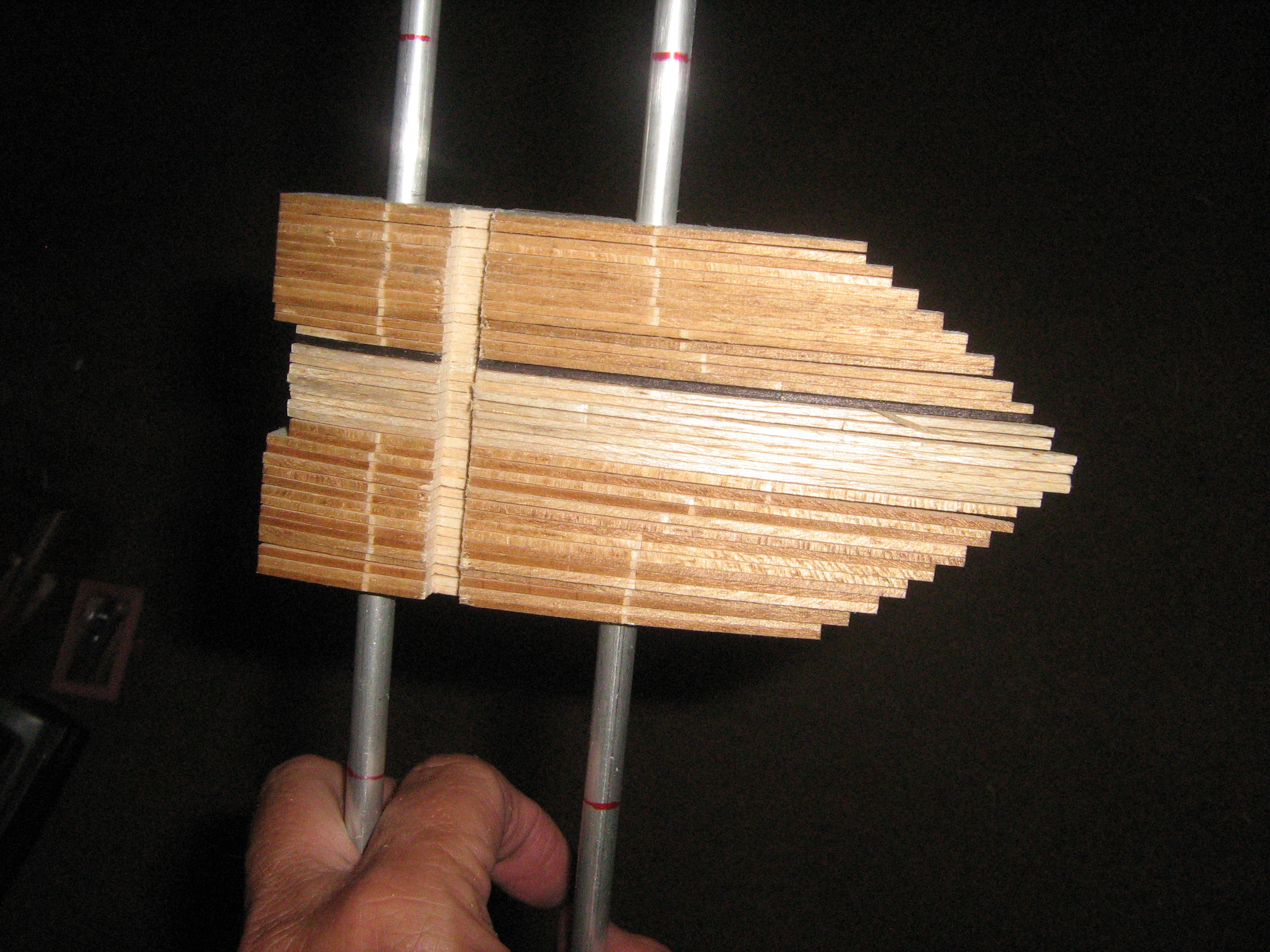

I have managed to cut two new inner ribs. It was not the cutting that was slow or difficult, but rather generating the pattern for them.
We recently had to replace our old printer. We were pretty sick of the cheap thing. I could not alter print size for one thing. Now I can in 1% increments.
I had calculated that the new inner most rib should be 1.04% bigger. So I scanned in the original W1 and W2 and printed to those sizes. It was actually more work and trial and error than I have described, but basically it worked. Then I just had to cut them out.
Now to make another of both.

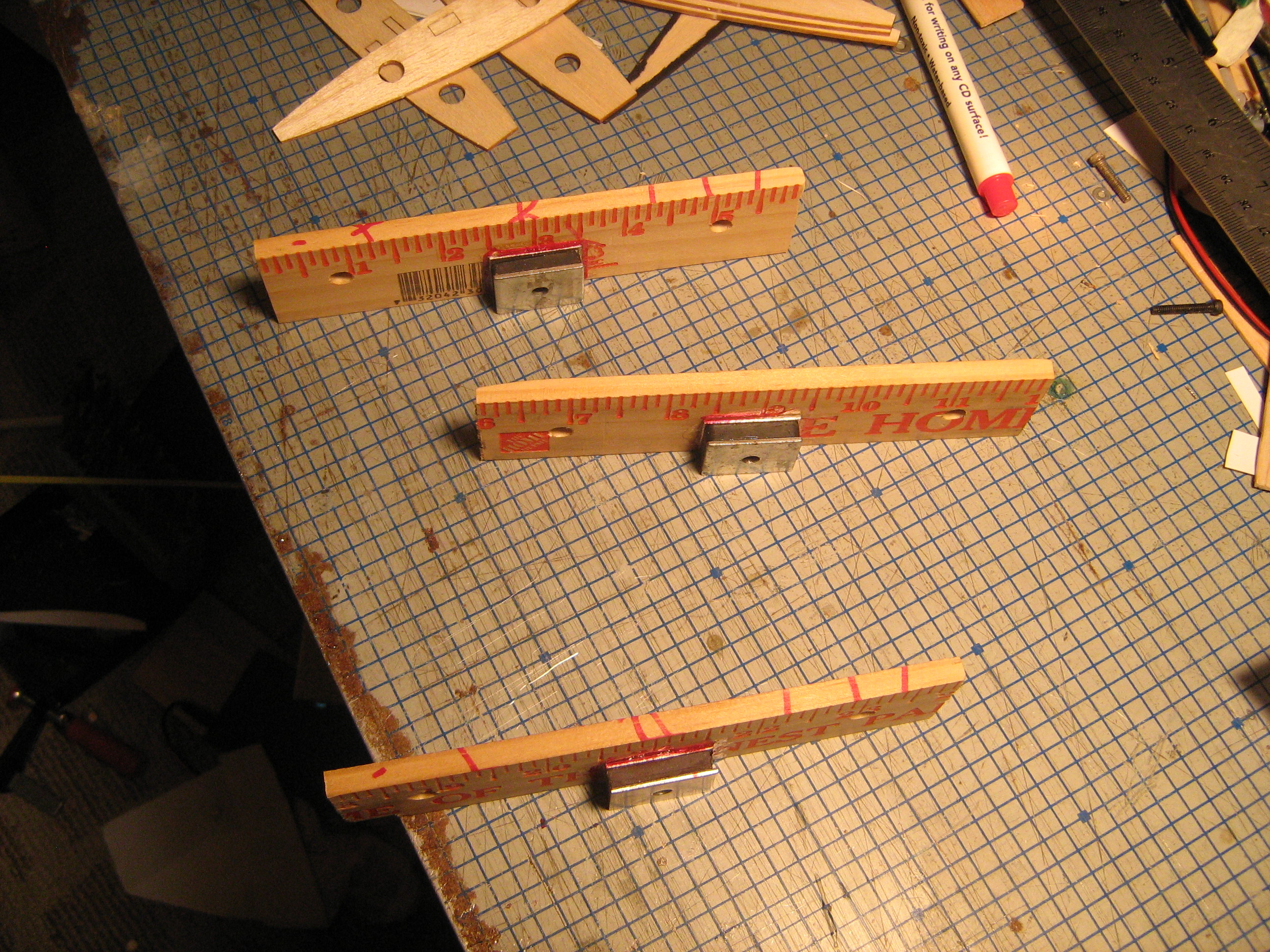

I have started on my rod holders. The magnets are glued on. I need to add a front stop and clamp bars. Then I can start building wings. The wing jig I am making will also work for other wings. Made no sense to make a one use jig. I may use bigger rods for bigger wings. These are a little flimsy but were a perfect fit for the existing holes. I may look at fitting something inside the rods I have now to stiffen them.

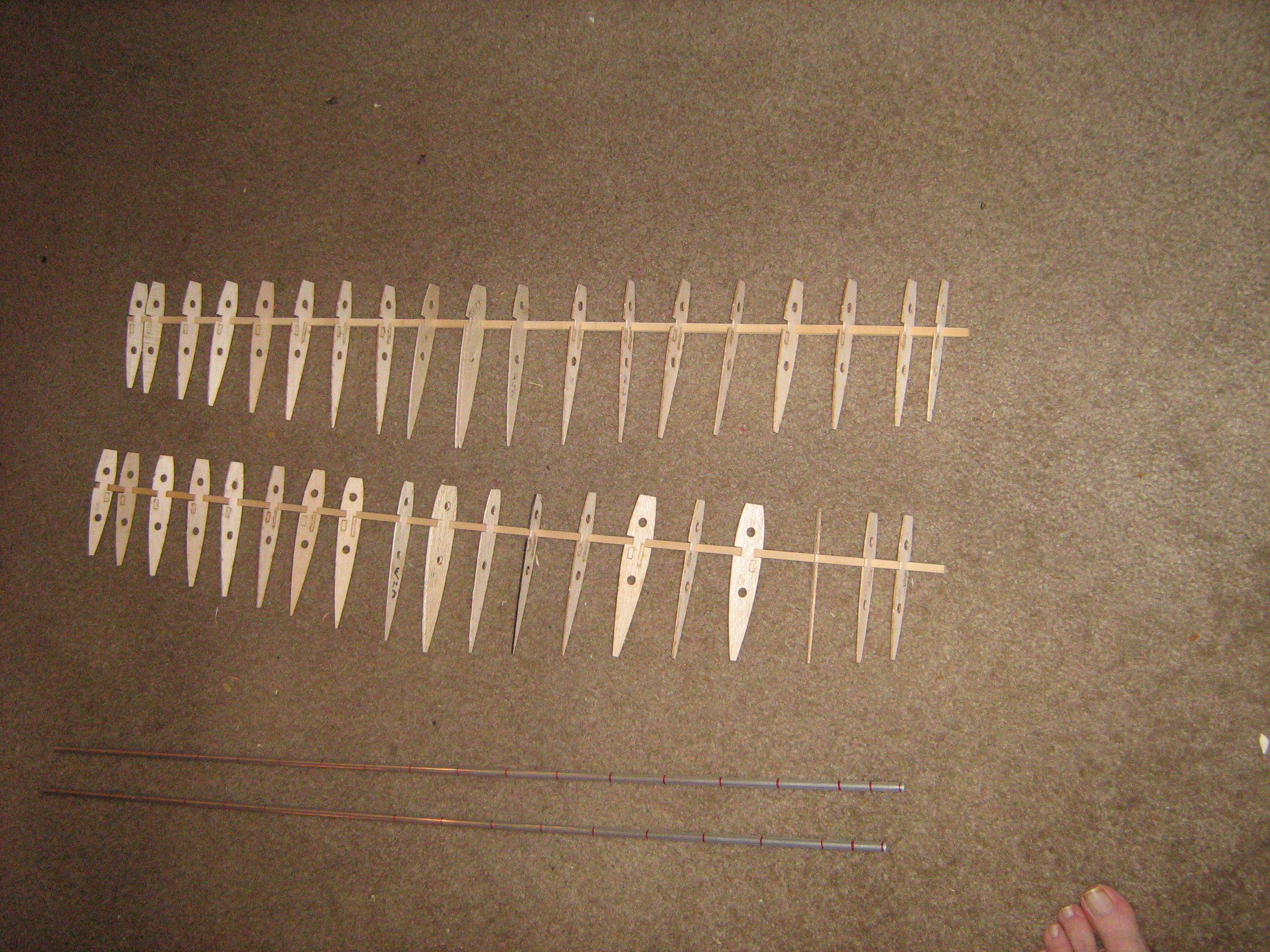

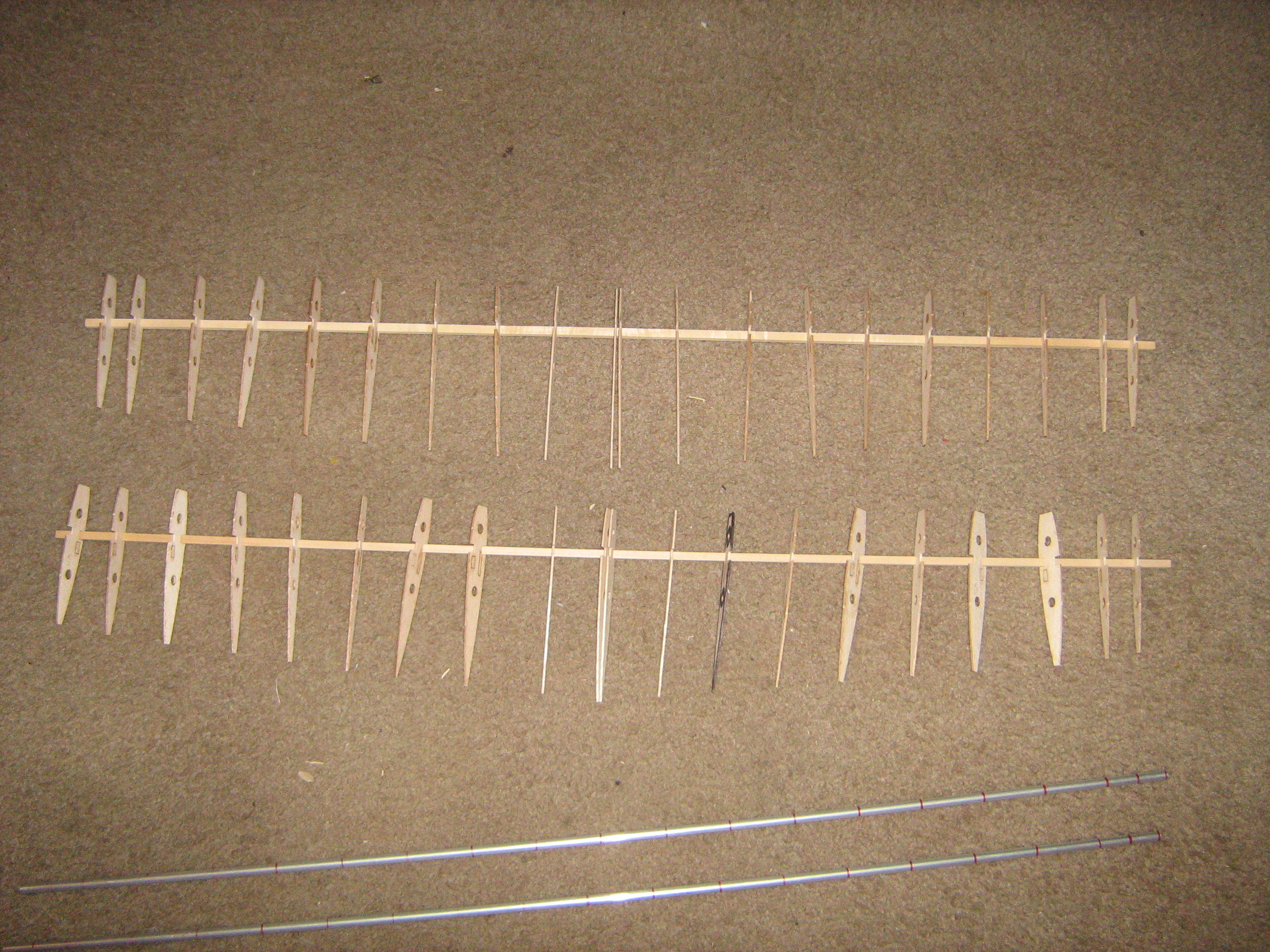

I did not get as far this weekend as I thought I would. I had expected to accomplish the basic framming of the wings. Or things to do and I had more prep work to do than I originally thought.
I am going to use a more normal spar system, top and bottom spars on each wing. Those had to be cut. I had place my balsa laminate build board under the magnetic on, started positioning ribs and went oh crap. I ain't ready Where are my spar slots. And hey I can't count, I am short 2 ribs, and I thought I was making 1 extra for a possible RC version down the road. So make 1 more W1a and W2a and use the 2 supposedly spares.
Then it was time to cut spar slots. Well slow down Sherlock, you still ain't firing on all cylinders obviously. I had become pretty heat stressed when I went out this morning to fly my little OS .10 trainer. Ended up on the ground at the end of the 1rst flight.
So I made the needed extra ribs and put them all the rods in the correct order but doubled up. Top and bottom wing ribs slotted at the same time W8,W8 W7, W7 all the way to the middle were it was W2a, W2a, then W4a, W4a, W4a, W4a, and the back to W2a, and continuing the pattern to the last rib on the opposite wing panel. .
I removed the balsa building board from under the magnetic board to avoid it taking a set. I am building on top of a card table with a 2" sheet of insulation foam on top of it. So there are some issues with trueness.
Maybe later this week I can start framing the two wings.

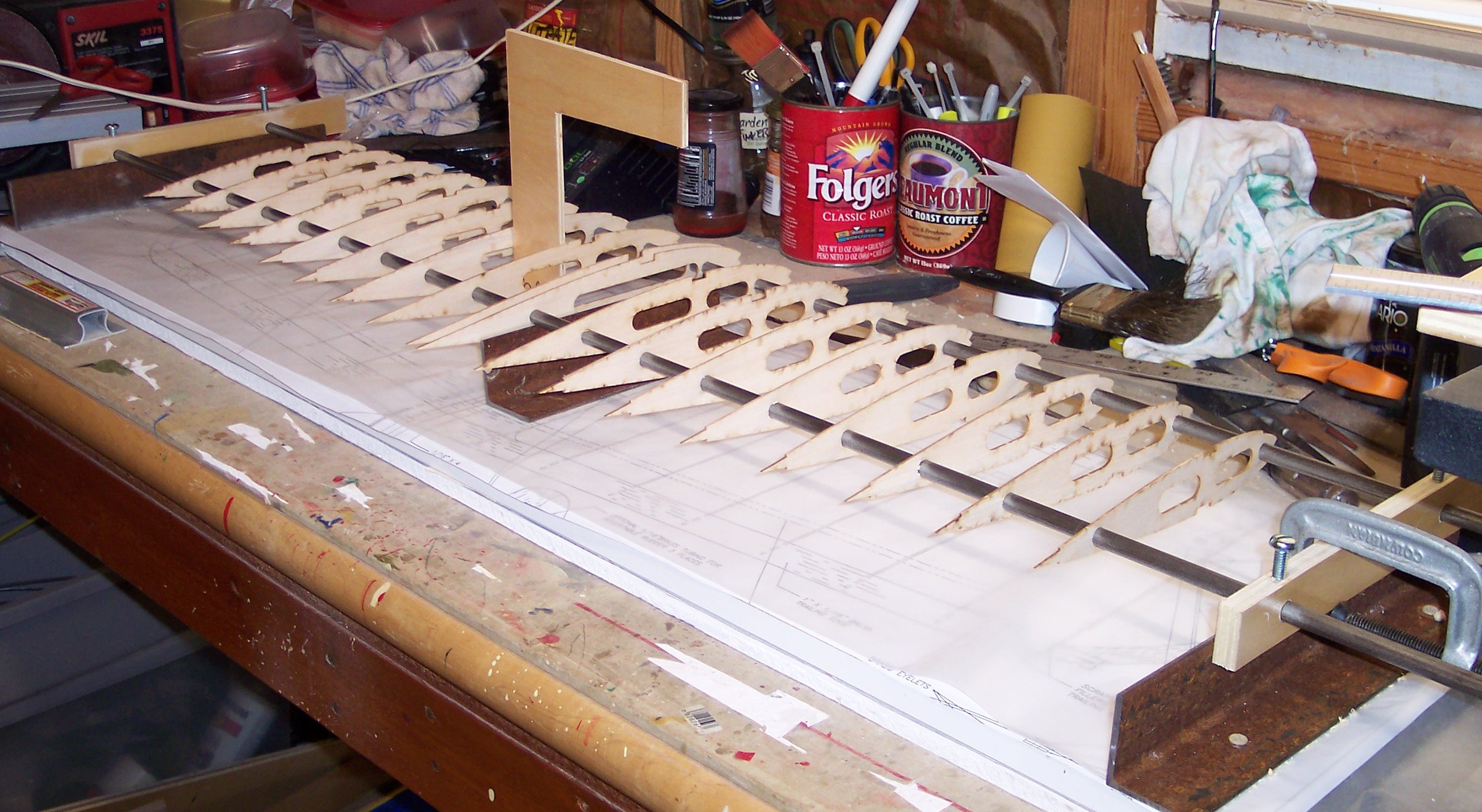

Ken, i made this setup this weekend to build a wing for my Brodak Shoestring. I made a tool to cut the holes in the ribs with a piece of 3/8" od copper tubeing with a 5/16" drill bit inside of it for a guide. I filed teeth onto the tubeing then inserted the drill bit into the existing 5/16" holes that were allready in the ribs. I inserted the drill bit end into the holes in the ribs and turned the tubeing by hand & it expanded the holes perfectly to 3/8" dia for me. I expanded the holes because i like you wanted the guide rods to be stiffer and not sag. I had 3/8" solid rod easily available to me and used angle iron on the ends to support the rods. I held the rods from moveing with end blocks i drilled & tapped & used 1/4-20 bolts to hold the rods. A C clamp on one end kept everything from moveing....Gene
Now that is one great ideal Gene. I love it. I also notice what I assume to be an alignment tool gauge in the second pic I will borrow that also.
I made a clamp bar (just some scrap 1/4 sqr bass) to hold the rods to the support stands. Does the trick very well.
Ken
Ken
Flyingagain, the tool is to space the ribs equally and keep them 90degrees to each other. It helps to keep the build moveing along faster. I hope you keep posting pics of your build as you proceed....Gene

But then I got some work time in on this bird. I got one spar tacked in, and all the ribs spaced out I borrowed you ideal there Gene. It worked like a charm. Made a small change though. A horizontal piece to align the ribs at 90 degrees to the spar at the same time they are being space apart 2", aligned vertically.

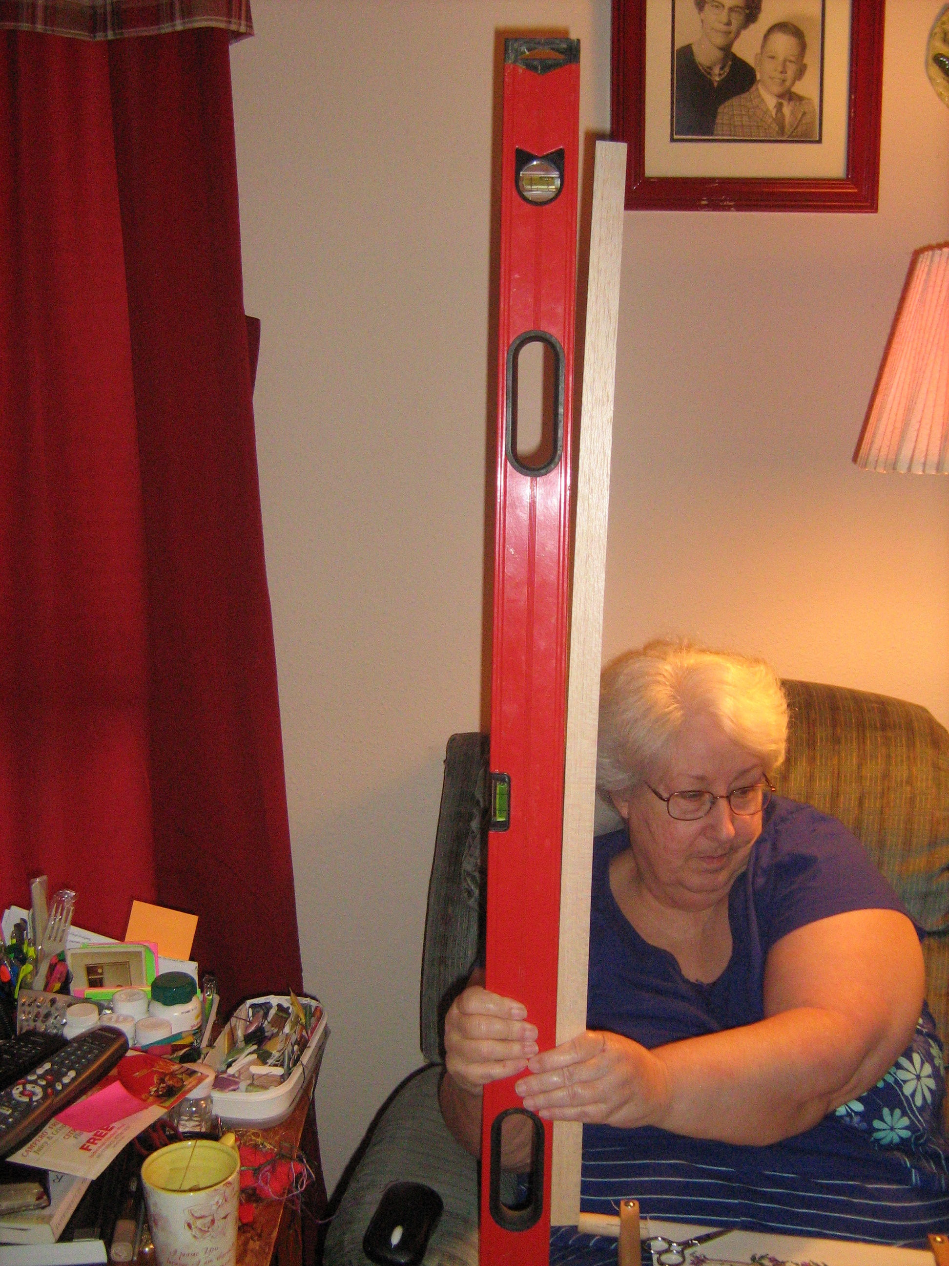

And now I have ran into an issue. My T.E. stock has a serious crown in it. It is 1" x 1/4" stock. To a lesser extent the L.E. stock is also crowned.
My inclination is to do a rather extend soak in water and then clamp it straight and allow it to dry for 12-24 hours. Not sure they won't twist as soon as I unclamp them though. But I guess I have nothing to lose.
Ken

I went to the LHS to day and sorted thru every piece of the correct size they had. I think I got lucky. I found (2) 1/2"square pieces and (2) 1/4 x 1" T.E pieces that are very close to true <1/16" of crown and real light weight no visible grain stock. I sat on the floor and dug thru their stock.
I have the new stock lightly rubber banded together hanging from a hook straight up and down. Don't wan't introduce any issues now.
The original pieces are still drying taking up my board. I will wait more before I pull them. They may rescue and they may not. But now they are not going to hold me up.

I am building again. The second wing is on the board.
I got the desk moved in. Checked level on it. and the back end was dead on. The front was bowed about 3/32. It makes sense. The back is just a really big I beam, and the front is not. So after about 30 years with computers sitting on and full drawers it settled. So I put a sheet of 3/4" MDF on top to protect the desk and so I could shim it to true. One spot is off by the thickness of two sheets of paper. That is pretty darn close. Then on top of that sits my balsa building board and on top of that my steel magnetic building board. It is all pretty close. I will routinely check it. Well heck this darn apartment is constantly shifting. I have to add a 1/2" foam shim to the patio door again. It has shifted that much in less than a year.
I am going to put a shelf system in back of the desk to give me some storage room.
But for now it is building time.
