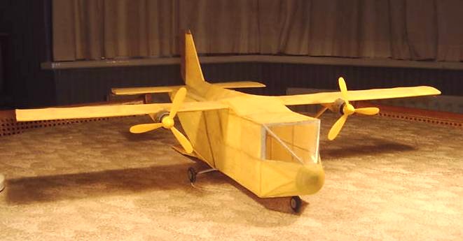

Still stick and tissue it even has telescopic sprung undercarriage (springs from retractable ball pens!). Impressive in flight but it has to be stored carefully as each motor weighs more than the entire airframe!
This twin actually has a third line used to power a motor to work the flaps and the loading ramp.
http://www.rcuniverse.com/forum/atta...mentid=1995056
The interior could hold a dummy stick and tissue house brick.
http://www.rcuniverse.com/forum/atta...mentid=1995057
Which it could drop it in flight!
