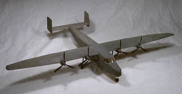

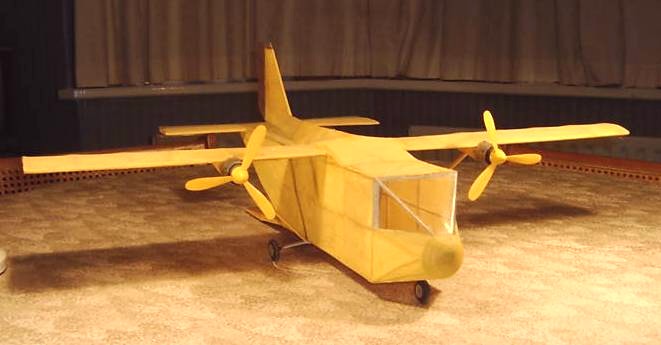

Or this free lance 4 motor not unlike a B24 Liberator.
Still stick and tissue it even has telescopic sprung undercarriage (springs from retractable ball pens!). Impressive in flight but it has to be stored carefully as each motor weighs more than the entire airframe!

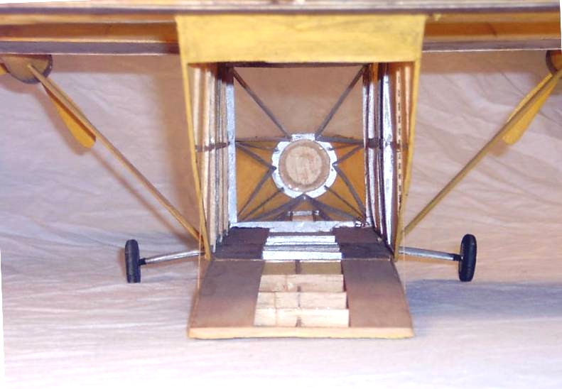

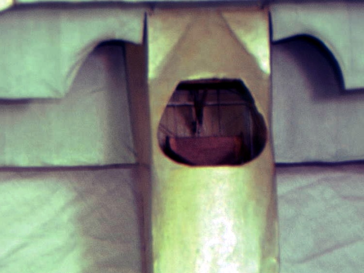

This twin actually has a third line used to power a motor to work the flaps and the loading ramp.
The interior could hold a dummy stick and tissue house brick.
Which it could drop it in flight!

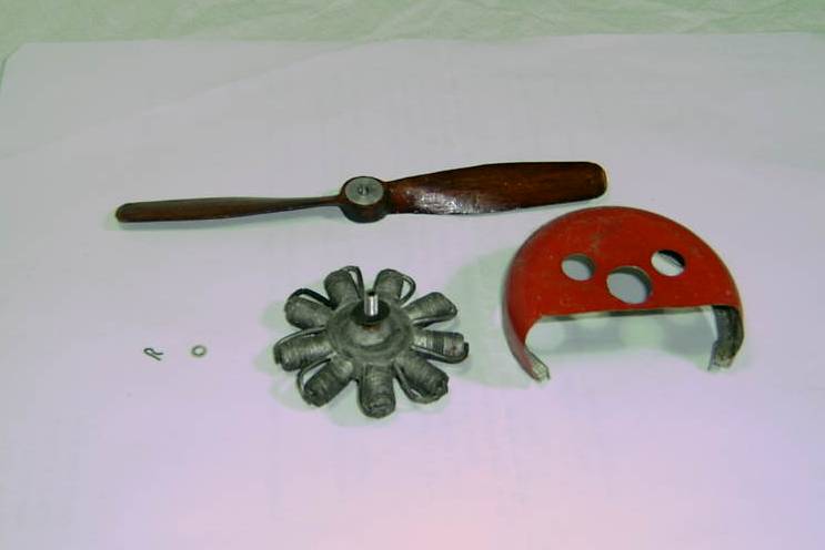

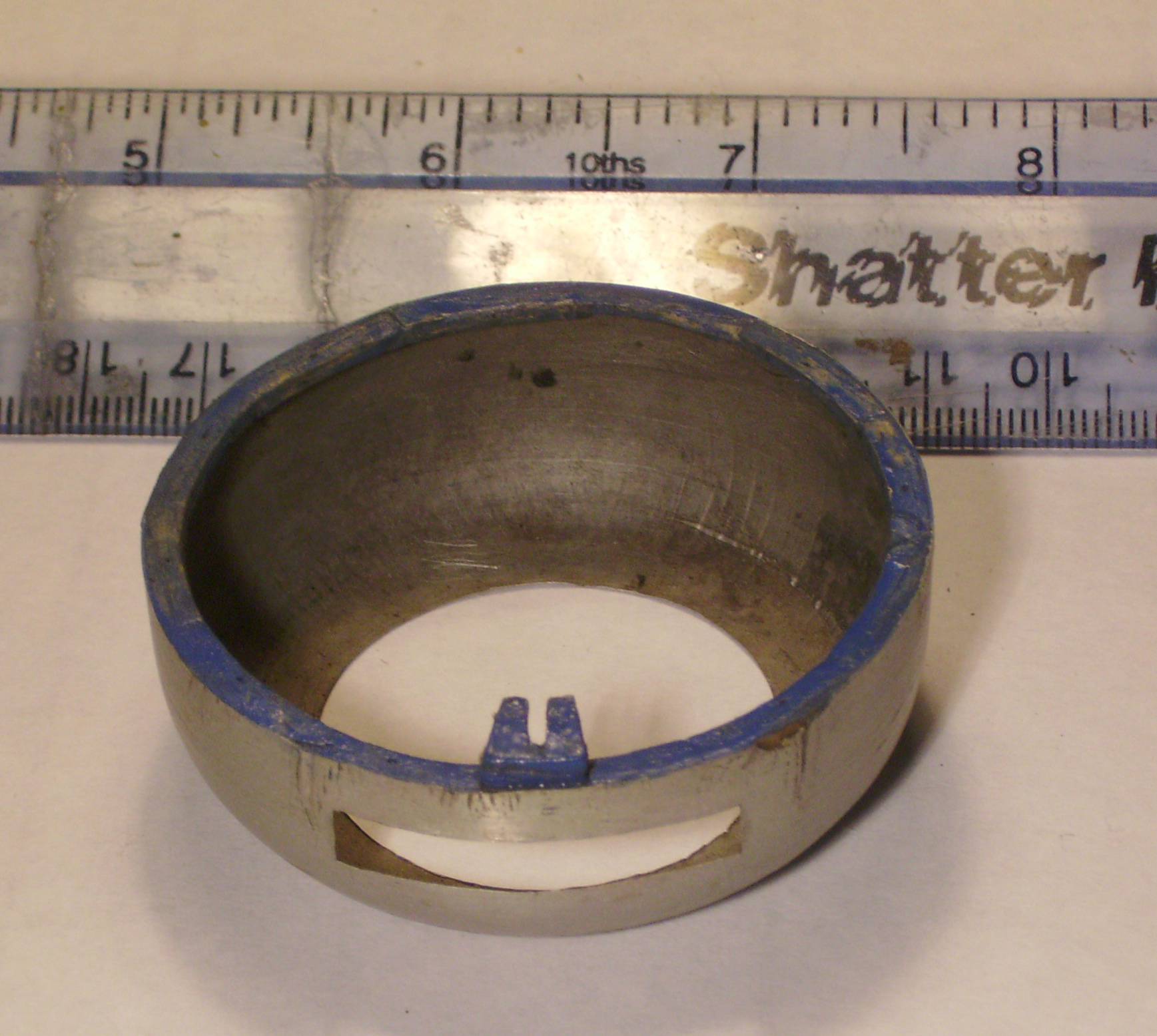

As my building skills improved I moved onto true scale not only in profile but in construction as well like this Sopwith Pup.
This had the benefit of a geared 'slot car' motor so it could drive a scale diameter (and pitch) carved balsa prop.
The undercarriage used elastic cotton to give scale springing and very fine steel wire for the load carrying rigging.
One advantage in having a very skilled model engineer for a dad meant he spun a scale aluminium cowl for me!
At 18" Span the Pup weighed just 2oz complete.
I seemed to remember it flew rather like the original - very well but stall it at your peril!

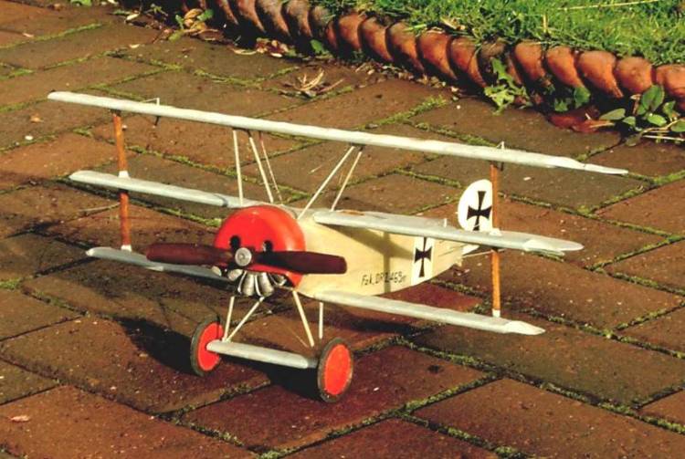

The story continues.

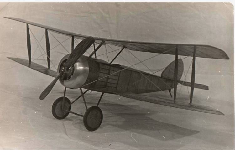

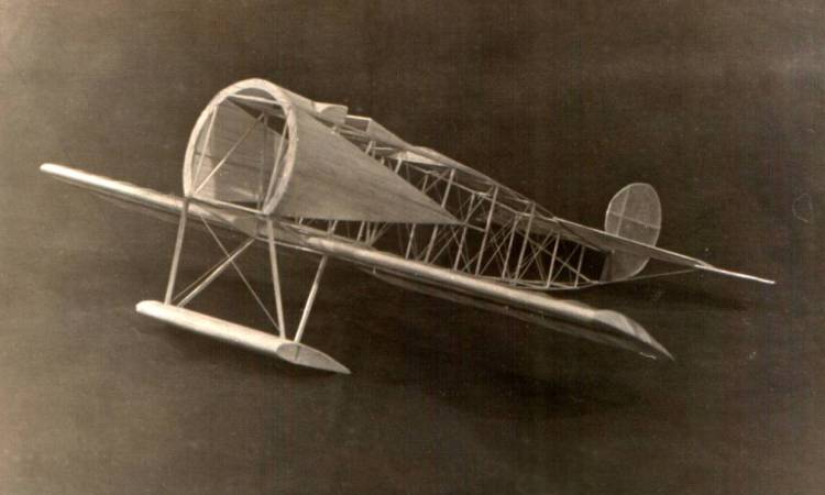

A contemporary of the Pup was the structurally interesting Fokker Triplane.
With the experience of building the Pup I could really go to town on the scale features even down to using 1mm round balsa to emulate the fuselage steel tubing.
This is the only picture I have taken during construction.
The fuselage is correctly internally braced with cotton thread.
Built to the same scale as the Pup it has a 16" span.
My dad again provided the spun aluminium cowl. It uses the same geared slot car type motor driving a scale prop but this time is has a scale Oberursel that goes round with it inside the cowl.
The final touch is the controls. They are all correctly run back to stick in the cockpit but of course all but the elevator are locked off.
The control line bell crank just has a short link to the stick. The scale control runs actually move the elevator.
It flies very well indeed and is able to 'hang on its prop' at a high angle of attack just like the original.
Surprisingly robust I still have it despite now being over 45 years old.
Now in well earned retirement but it still runs.

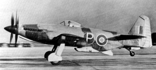

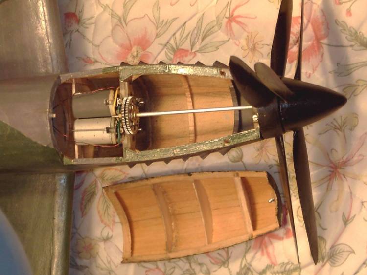

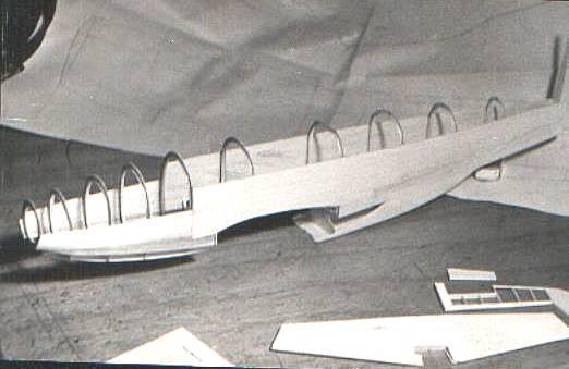

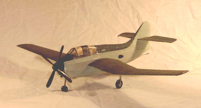

A plane with a big prop and small wings, then I remembered this, the Martin Baker MB5.
it had been described in the Aero Modeller with a nice 3 view. Fairly well known now but in the early sixties not many people had even head of it.
I guessed a 22" span was about the maximum I could handle but this still gave in effect two 3 blade 8" diameter props!

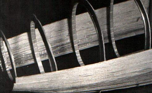

To look right this could not be stick and tissue (except the rudder and elevator which were fabric covered on the prototype) but had to be all sheet covered.
To keep weight to an absolute minimum it was built as a stressed skin monocoque using 1/32 balsa sheet planks.
Even the formers were 'built up' using the same material.

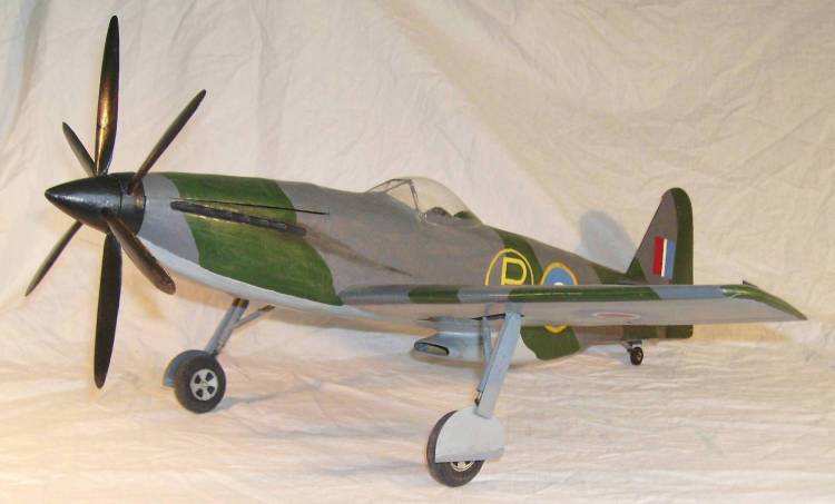

It would not look right without its contra rotating props so it ended up with two 'slot car' motors geared onto coaxial shafts.
The prop and spinner is all balsa.

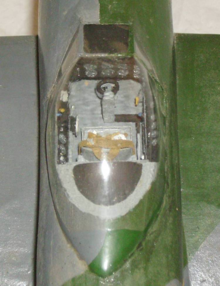

The canopy was home moulded and the cockpit fully finished with all the instruments.
I don't 'do' pilots in any of my planes so the harness straps are neatly folded on the seat.
Completed.
In view of its very light weight construction the undercarriage has working telescoping suspension to reduce landing shocks.
It weighs 4.25oz and produces just about that much thrust.
It flies well and compared to my other models is quite fast - actually only about 10mph but on 8' lines it feels much quicker! Landing is the most stressful part trying to keep all those balsa blades from touching the ground.
The hollow stressed skin structure acts as a wonderful sounding board so the gear wine is greatly amplified making it sound like a turbo prop, as this ground run shows. It was securely tied to a lump of lead!
http://vimeo.com/44119026 It is now 45 years old!
