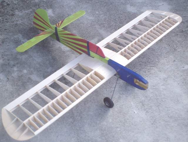

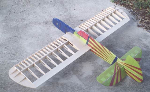

Another Magician
2 Attachment(s)
Scratch built from Brodak's Magician plans. The only significant change I made so far was to laminate some 1/4" strips of 1/32" ply to the top/bottom spars that extend a couple of rib bays beyond the sheeting -- i.e. where they tend to break when the thing is flown real hard. Still need to fit the fixed flaps and decide what to cover it with.
The fuselage is covered/trimmed with tissue/dope. A bit on the garish side ;->
Attachment 2239397
Attachment 2239398

cutaway 02-04-2008 08:48 PM
RE: Another Magician
Weight's not too bad and the wing is straight as an arrow right now. I haven't stood it side by side with my old Midwest Magician yet, but it seems a bit smaller in the wing than the Midwest kits were. My 30+ year old Midwest kit built one is pretty nice in the air and it came out a tad on the heavy side since the kit's fuselage was made out of ironwood.

cutaway 02-07-2008 09:42 AM
This one is at 24oz as it stands now minus engine and tank. The nose on this one looks to be around an inch shorter than the Midwest kit. I got it drilled for a Fox Stunt .35, and I may have to go with a muffler to get the balance in range. I didn't have any 3/16" on hand for the stab/elevator and wound up laminating 3 pieces of 1/16, so that kinda weighted up the tail a bit with a bunch of glue...

cutaway 02-14-2008 09:48 PM
It turns out the Brodak recommended C/G range on their plans is very conservative. This one wound up about 1/2" behind their rearward most position without a muffler and it still flies fine and is quite stable. I'll probably build another and stretch it out to the dimensions of my 30 year old Midwest one.
