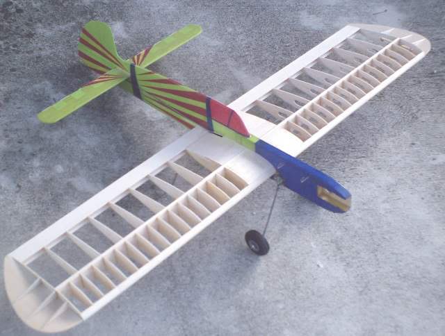

Scratch built from Brodak's Magician plans. The only significant change I made so far was to laminate some 1/4" strips of 1/32" ply to the top/bottom spars that extend a couple of rib bays beyond the sheeting -- i.e. where they tend to break when the thing is flown real hard. Still need to fit the fixed flaps and decide what to cover it with.
The fuselage is covered/trimmed with tissue/dope. A bit on the garish side ;->

Weight's not too bad and the wing is straight as an arrow right now. I haven't stood it side by side with my old Midwest Magician yet, but it seems a bit smaller in the wing than the Midwest kits were. My 30+ year old Midwest kit built one is pretty nice in the air and it came out a tad on the heavy side since the kit's fuselage was made out of ironwood.

I've got a Magician that I built over 30 years ago. It's been recovered and repainted and I bet it's the worlds heaviest magician! Mine weighs 42 oz with a Fox 35 of the same vintage. I've thought a lot about stripping it yet again, recovering with lighter stuff and putting a brand new, test run only Merco 40 that I have on it. How much does your new Magicain weigh? BTW: I don't think it's so garish. I think it's kind of in the spirit of CL flying when we were young!

This one is at 24oz as it stands now minus engine and tank. The nose on this one looks to be around an inch shorter than the Midwest kit. I got it drilled for a Fox Stunt .35, and I may have to go with a muffler to get the balance in range. I didn't have any 3/16" on hand for the stab/elevator and wound up laminating 3 pieces of 1/16, so that kinda weighted up the tail a bit with a bunch of glue...

That shorter nose might not be all that bad of a thing. The way those Fox's vibrate can make that long nose swing back and forth like a windshield wiper blade! LOL! I've seen guys put in a plywood triangle between the leading edge and the nose to try and reduce the problem. Good luck with your plane! It sounds like it should be a lot better flyer than mine because it's lighter. Sometimes I get the urge to try CL one more time before I die. Maybe I could get over the hump and learn to do something besides wing overs and inside loops.
Oh, BTW! I'm a bit embarrassed to say that I forgot to subtract the weight of the balancing stand I had the plane on when I put it on the scale from the reading. My plane actually weighs 37 oz. with engine, prop, tank, etc. Still heavy but I feel better now! LOL! I built mine with working flaps and moved the horizontal stab back about 1/2 inch from the location on the plans. I used a 3 inch bell crank. Looks like yours doesn't have any rudder offset. I've got offset in mine.

It turns out the Brodak recommended C/G range on their plans is very conservative. This one wound up about 1/2" behind their rearward most position without a muffler and it still flies fine and is quite stable. I'll probably build another and stretch it out to the dimensions of my 30 year old Midwest one.
