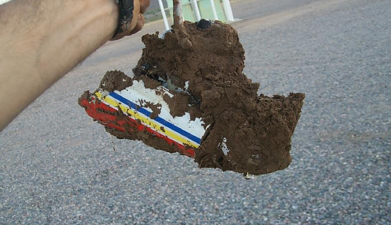

well.... today was eventfull, was flying a friends Epicure II pattern plane. Was a sweet bird... doing all the normal stuff.. having a blast. so i found that you could do perfect squares (box`s ) in the air was neat as hell!.. up...over..down.... i was just about to try them outside (like an outside loop) instead of inside. .. then IT happened.... left wing broke off in the middle in mid air!....and i was waaay up there!.. i tried all i could do... but as we all know .....it was futile.....it augered in like a yard dart..
i dont fly much pattern,,,, but i guess you cant do them box manuevers at full throttle.....a sad ending.. it rained a few days before pretty hard so ground was wet....took us 10 minutes of digging to get motor out!... pulling on header pipe. was like yanking on an oak tree root. was not budging. had to use wing tube that was there to dig it out.

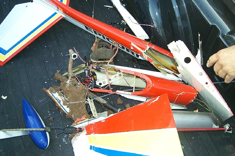

was the engine and radio damaged? (aside from a good hard cleaning) cant say ive ever gotten this pattern thing.

well.... have not got that far yet...plane was not cheap though. was 4 or 5 years old.. but....was just about perfect.
once we check it out....ill post details...

Thanks for the pics. I really like the turnip you dug out of the ground, er the engine
That's...in there...somewhere? I assume? hehe.

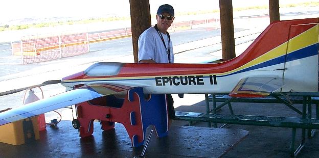

and no.. it was not..... an ARF it was a custom built plane.. all painted....whole nine yards..YS, retracts... all high dollar servo`s... PCM reciever ect ect.....
pattern planes fly like nothing else... smooth as hell.. i just thought .since they can go so fast....(and it was fast) . that they could take some g-force`s... i guess i was to hard on it....... being under 11lbs.... i guess you need to shave the weight some where...( and i think i know where now)...

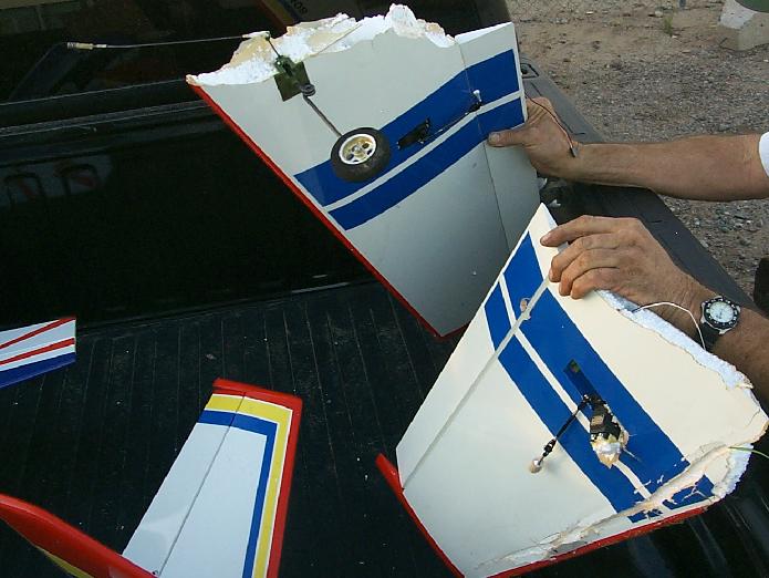

dont take this a rude, but this just goes to back my adversion to foam wings. granet some say they are stronger, i still beliebe that i could build a stronger lighter ing with balsa ns kevlar (less brital than carbon)

I am curious what part of the structure you will use the kevlar on? As you know, Kevlar has very good tensile strength and stiffness... but in compression, it is butter! "E" fiberglass has roughly 2 times the allowable compression strength of Kevlar... "S" glass is even better...
"(less brital than carbon) "... that is an interesting statement... lets think about that.... if you consider any given load condition on a model plane, there is usually a compression load present that is nearly of the same magnatude as any given tensile load at any given moment. (Say... compression on the top spar cap and tension on the bottom spar cap) Rarely under these conditions is it the tensile member that fails... nearly always it will be due to compression, shear or failure due to buckling. (Instability of the structure)
Now "Brittle" is typically a remark that means "Breaks under conditions of small deflections".... so... we take the kevlar solution you propose... less brittle... ie... less stiff... ie.. more prone to buckling! also... it is the "Stiffness" of the resin system that permints a shear or compression failure... not the fiber. In nearly all air load cases, a less stiff (ie. non-brittle) structure is MORE prone to failure. A spar that is permitted to be more flexible will in fact induce upon itself more stress... particularly a stress that attempts to "Squish" the spar caps towards each other. Using a material that has exactly the same strength (ie. identical maximum psi at rupture) but "STIFFER" will reduce the stresses within the structure.

Foam vs Builtup?... The foam basically replaces ribs. If the foam is relied upon for more functionality then this, then the builder/designer is asking for trouble. I know millions of foam wings with 1/16" balsa sheeting and 4" of fibreglass in the middle have flown succesfully for decades!!! But this is a structure that is hardly optimized. Building a discreet spar, and reducing the sheeting thickness, honeycombing the foam, false cap strips are simple methods to end up with a wing that is lighter for the same flight envelope requirement. (Years ago someone argued that foam attenuated the noise...but I never saw any real testing) One advantage to foam core is that the average schmoe builder can build a very straight wing even with taper and changing sections.... easily!! This can be done with the more tradtional built-up with ribs etc, but harder to get there....
There are examples where Fiber glass can be a solution better than carbon... but usually these are situations where large amounts of energy must be absorbed, and accelerations must be minimized... like a landing gear strut... carbon will produce a stronger strut at the same weight... but it will be stiffer, and will subject the airframe and its contents to higher accelerations at any given landing descent rate.
