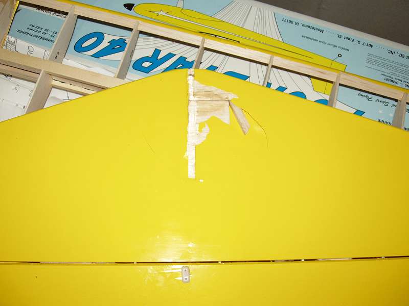

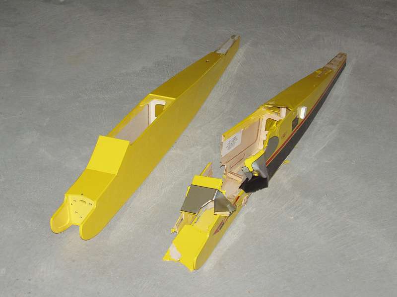

Well, I had my first crash with my LT-40...
I was up with my instructor, and was doing the pattern right to left. As I was making the first bank to the left of me, I noticed the wing started to bounce. As I came out of my bank and started the other one, I found my sticks had no effect. I said "Hey, I have NO control over this!?!?!" My instructor took over... Nothing. As it was directly across from us, it rolled on its right wing and the throttle went to full, and it dove right into the ground. [:@]
We went out and got it... the first time I have ever had to wade the tall grass for it, and we found it. The fuse, starting at the furthest rearward point the wing touches, had disintagrated. The Engine was alright except for the back plate, and the servos all seemed to be fine, except the plastic thing that encircled the connector on the Aileron servo was gone. Some sheeting was busted on the wing, and one wing rib. The antenna was broken off at the receiver, and the landing gear was completly bent. This was my first crash, and as my Papa said, I didn't do it half way
This was in early July (the start of flying season ) and I was about to get my licence
Oh well, I have it ALMOST all repaired, we are going to put in all the servos this week, and hope to be up next week, or the week after.

Oh, and you can't tell, but those pieces are taped together so that we could get them home; I wanted to get a picture of it, and it wouldn't stay together
Old 08-21-2004 | 03:58 PM
Joined: Sep 2003
Posts: 87
From: Troy, MI
Default RE: First Crash
[&o] Keep forgetting things:
The result of the crash is still up in the air. When we got it back, all the electronics were still working, although we could not test the range because of the lack of antenna, and we don't know when the thing came off. There are only two things that we could think of. Interference: the usual cry !QUOT!I DIDN!QUOT!T DO IT!!!! IT WAS INTERFERENCE!!!!!QUOT!
Or, maybe the switch. We think that the switch may be slightly sticky at the end and vibed in flight, turning the system on and off. As I said before, neither of us had control.
Oh well...

it sounds like if i read it right that the rx antenna was not on the rx? in that case, thats why it went down since there was no way of controlling it
Old 08-21-2004 | 07:19 PM
Joined: Sep 2003
Posts: 87
From: Troy, MI
The antenna was off, but we think that it was crash related. It (the piece that broke off) was under the plane when we found it.

Well, now you're a real R/C'er! Welcome! It's annoying that you don't know what caused the crash, but at least you managed to salvage the expensive stuff. By the way, I hope you had your radio checked out after that crash! If I were you, I would also throw away that Rx crystal and get a new one. Crystals are very fragile things; don't let an $8 part down another plane.

How many flights did you have on it that day, and did you check/recharge the receiver pack? SOunds like low voltage on the pack to me.
