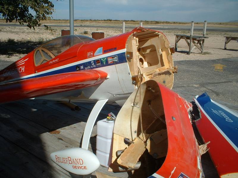

At the field nice sunny day. A friend puts together his Extra 300, checks the batteries usual preflight. We go out get it started running great. I ask if he check the surfaces for proper direction hes says "Yep" Taxis out nice takeoff plane begins a nice roll to the left.then impacts. The whole time he's saying "I'm holding right" Post impact inspection. Didn't plug in the airlerons. Moral of the story. When you asked "everything going the right direction" be sure and look at everything. I guess rudder could have saved it but never even thought to try happened too fast. Shame too he just got it trimmed and flying great.

That does stink. That's why I "wag" (and watch) all the control surfaces just before EVERY take off. yup, yup, yup...ok lets go...It's a little ritual now. Saved me from the ailerons plugged in the wrong channel.

I was taught to check EVERYTHING. Up, Down, Left Aileron, etc... OK, let's fly! Bummer of a crash.

Me too. As I taxi out I always check movement "one more time". It funny as time goes on and we become "more comfortable" with a plane we may go through the motions but not notice whats going on.
I learned from a friend's mistake. Hope maybe this saves some one else from the same.

Welp: It looks as if it took a pretty good thump'in, but I don't see anything that can't be fixed. What I'd do is put it back together make the repair covering different nasty colors so that I had a blunt visual reminder of how it got in that condition to start with, and then see what else it had to teach me.
