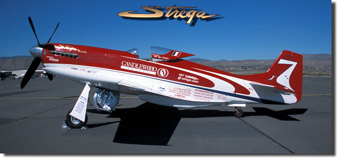

The one I have now only clocked 120 today on the radar gun. I'm looking for the scale speed for the next one. Strega runs in the oh....480mph range
