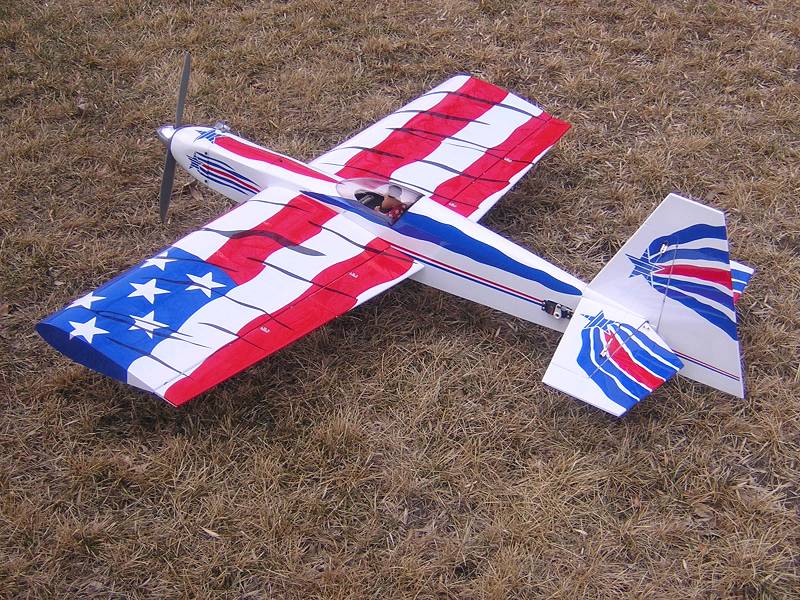

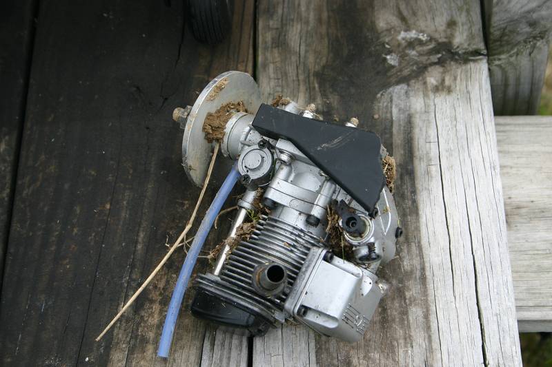

It was one of those perfect days that you dont see very often, no wind and perfect tempature. I started flying my Funtana x100 just like always slow and having fun. Well I just got done doing a snap roll when all of a sudden it went to full throttle. I knew that I could not fly the x100 at full throttle with the YS 1.10 so I decided to go verticle, that way there would not be as much stress on the plane. Well after a few seconds there was a really lound noise and then silence. At first I thought it was going to be just like any other dead stick but I realized I didnt have hardly any controll. My first thought was I blew one or more surfaces off. Well after fighting it all the way to the ground for a super soft touchdown about 10 feet from the edge of the runway. I was pretty happy untill I walked up to the plane. I realized there was no motor! TALK ABOUT TAIL HEAVY!!! I took it back to the stand and looked it over. The cowl was destroyed the motor mount failed but other than that not a single scratch on the plane.
The field is pretty much surrounded by swamp land all the way around so my hope was the motor didnt fall in there. One of the club members saw something fall and new a gerneral area to look. We probably looked for 30 mins or so with no luck. I thought there went a $400 motor. We gave up and started heading back to the club house. All of a sudden we saw the motor right in the middle of a cleared spot in the field. I was so happy. I then realized how lucky I was.
There might be some minor damage to the motor but not to bad the prop was no were to be found so who knows what really happened in the first place all I know is I got all my stuff back and pretty much in one piece.
FYI: The field looks really bad because it has been raining here in central Arkansas for weeks, so it has not been cut!
I have to put the pics on a couple different post, says the files are to large.

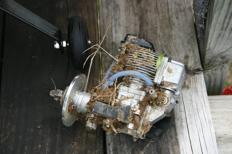

More pics.

looks like a simple fix, just order a new cowl and put a new engine mount on it.. one question though, did you balance the prop that was on there? i can't imagine that engine mount just snapping like that, that is crazy! well, nothing to do but put it back together and fly her!

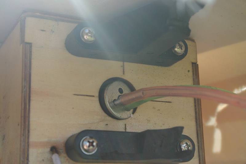

As a guess, I'd wager the throttle went to wide open because the mount failed on the same side as the throttle linkage...allowing the motor to rotate/slide in whatever direction necessary to open the carb.

Cool story rc-plane. I'm trying to understand what happened to the prop though. It appears that the prop nut is still on the shaft, so either the prop shattered in flight or when the engine struck the ground. The blades didn't end up in the ground where the engine landed did they? Was any of the prop left around the shaft? I wonder if one blade fell off, during the vertical climb, causing a severe imbalance that broke the mount. Maybe the other blade then struck what was left of the mount or maybe the landing gear, and broke off. Nice save anyway.[sm=thumbup.gif]

That's what I'm thinking also. But, if the prop exploded, I'm guessing it did so before the engine mount gave way. So how did the mount break? I would think that once the prop was gone, that would relieve the strain on the engine mount. Unless again there was a momentary imbalance that lasted long enought to break the mount. Sorry, I get hung up on things like this now and then.[&:]

from what I can see in the pics it looks like the throttle side of the mount broke last and since you said it went to full throttle the prop may not have exploded right away but instead warped during the vertical. I have had some plastic props off of toys that I stuck on my 30,000 rpm rotary tool and the pitch of the prop causes the tips to bend forward slightly. This often causes the pitch of the prop to be disturbed for a moment increasing the rpm's. After a few rounds centrifugal motion takes over and the prop straightens out. the loud sound you heard may have been the increasing rpm's of your engine then upon the staightening out phase the prop may have broke. If my theory is correct the increased rpm's and the propellers warping caused a lot of vibration and that is what snapped the engine mount.

The prop got broken when it hit the cowling due to the movement of the engine which was shaking inside the cowl, the engine stalled because one part of the mount was already broken (servo travel was useless) and maybe part of the prop broke apart by hitting the cowl, you know what happened next.
Congratulations for saving your plane and as a suggestion I would tear apart the engine and clean it before any attemp to run it again.
