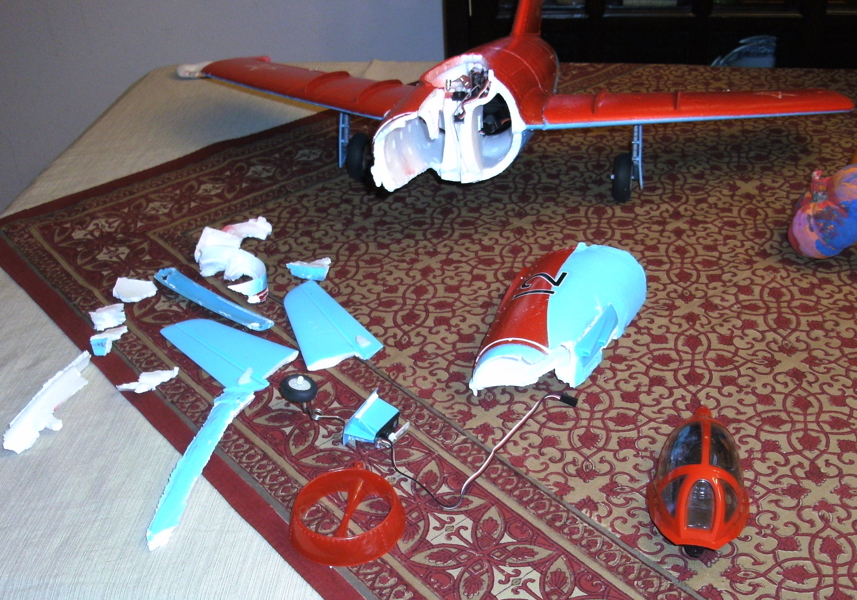

looked away for just a split second today. also for some reason or another all my pictures started turning giant anyone who knows why feel free to chime in

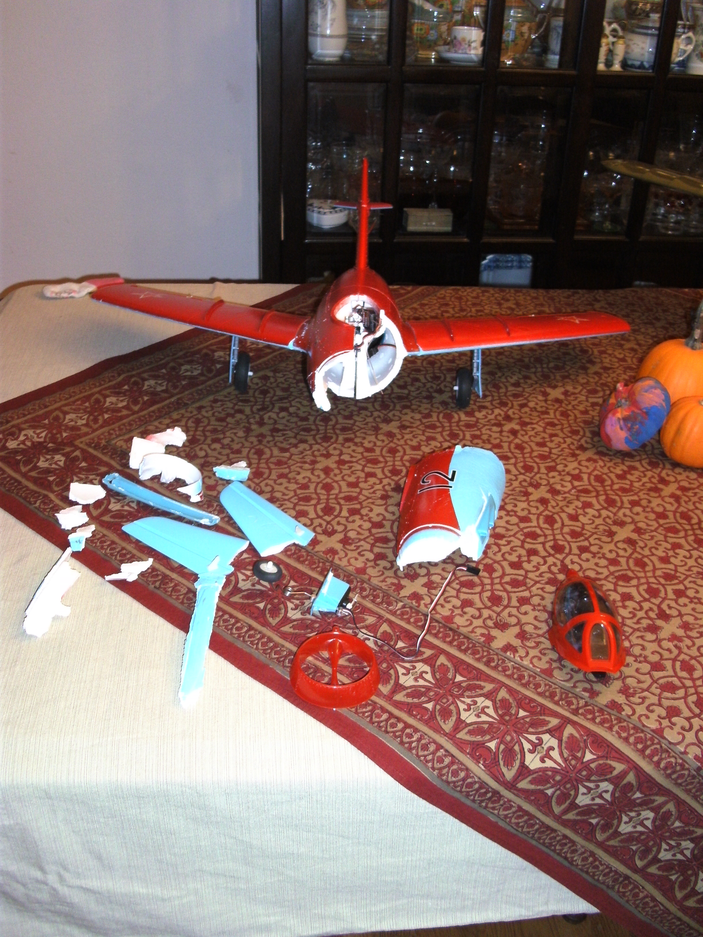

hopefully these pictures are a little better. nope this is a wierd thing anyway click on full size and they become viewable

wow you weren't kidding about the giant pictures !
Even though I haven't exactly repaired anything quite like your mig, I have to think its fixable. It may not be as pretty if you have lost alot of the foam. But I would say line up what you have and glue it, fill in the holes....Sometimes if you have a big odd shaped hole in the foam its easier to square it up neatly, then glue in a new piece and shape it... Sometimes its less about a right and wrong way as just thinking up a route to go !

Oddly enough all the pieces are there its all just a little mushed. Im slowly stretching out the pieces. looks like only a little fill even.

Looks hard but not impossible. Try to assembly dry (no glue) first vvith tape maybe to check alignment. if you're ok start to glue, checking again.

Oh heck yes, that'll fly again. If you decide it won't, box it up and send it my way! It'll be in the air the next day.
There's nothing to it...Personally, I'd toss the crumbled/squished foam pieces, fit in the larger "undamaged" pieces, patch what's missing, and off you go.

Ditto, I could have it flying again tommorrow! Packing tape and a carefully applied heat gun will help shrink the tape and pull the pieces back tight.

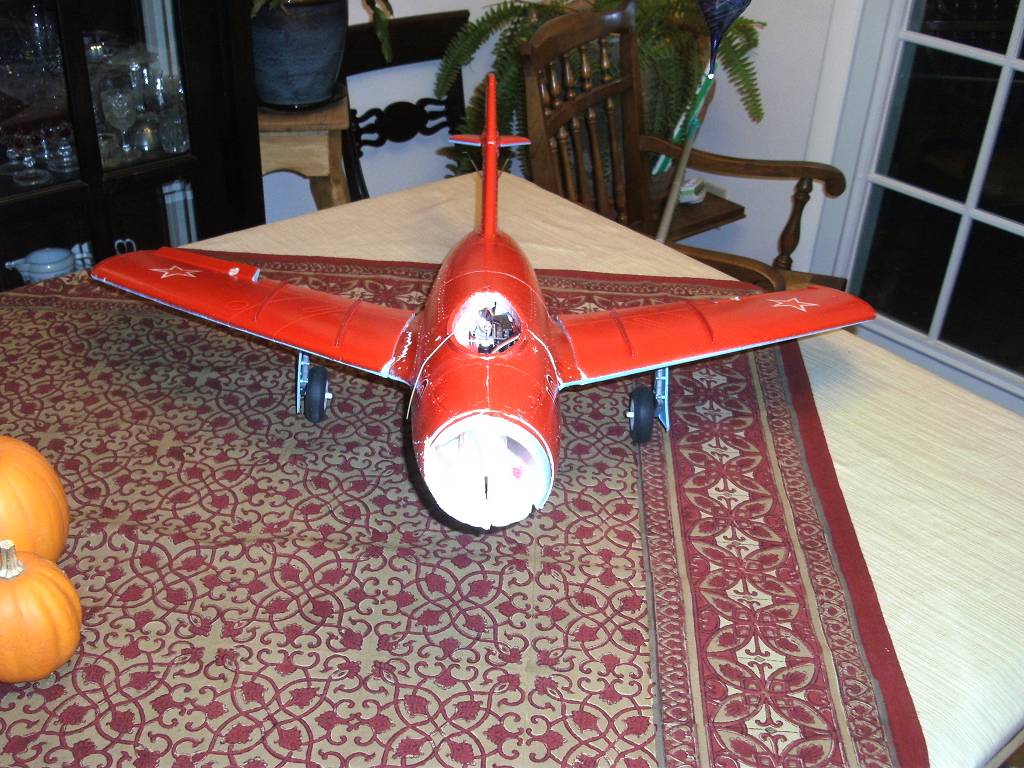

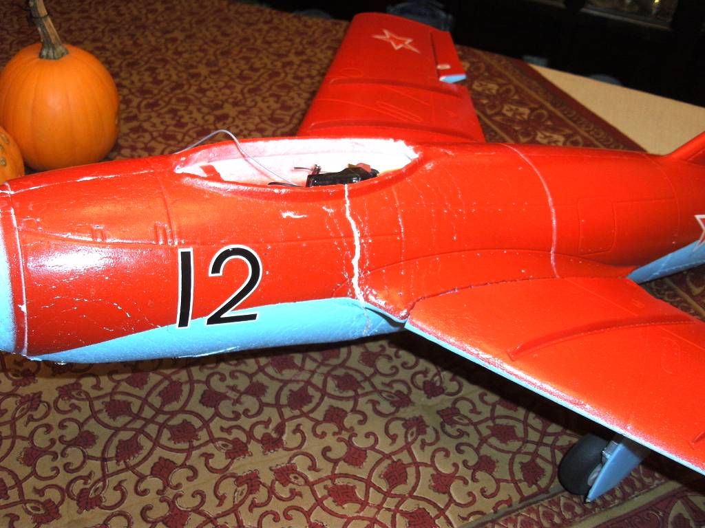

flys good will post pics
