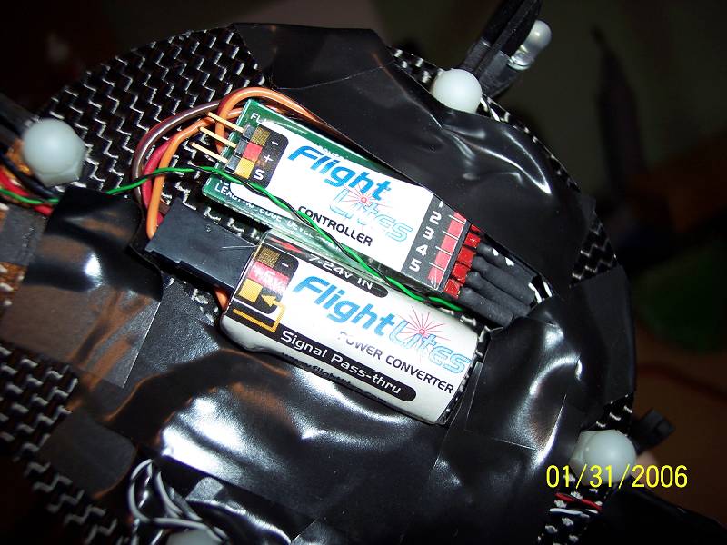

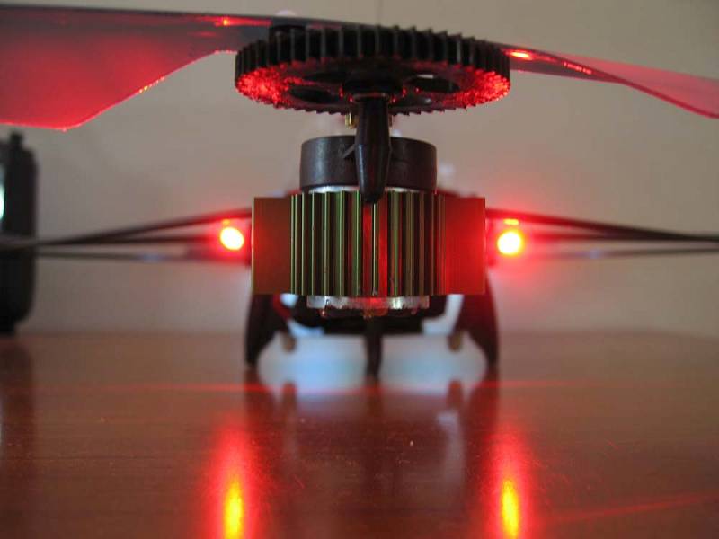

I just got my Flight Lites kit today!
I flew with them this evening and they are kick ass! [sm=thumbup.gif] The solids are very similar to my original keychain LEDs as far as brightness and the strobes are very realistic! Not like the simulated strobe I was using that had two blink patterns instead of pulsing. They look just like real helo and plane strobes and the current controller has 5 different sequence profiles to choose from. Jeff Swayze at Flight Lites said there is another version to be available soon with around 20 or so profiles to choose from. Then later on this year a pro controller where we, the end users, can create our own custom profiles with our PCs. [sm=thumbup.gif] Another high intensity landing light controller will be released soon as well. The kit comes with a controller and 5 lights of any color of solids or strobes that you choose. Each light is custom made and terminated with a two pole micro plug. The kit is only $44 including postage and the delivery time was only 2 days!
My keychain LEDs cost me $140! [>:] But, they are high quality LEDs with switches and served their purpose well until I found out about this kit. Now one switch turns on all of the new lights and no more $20 (5 x $4/2 pack) Energizer button cell batteries to power the others!
Important!: Unless you have an independent 5v power supply, you will need to get the multipin to 3 pin adapter from DFI in order to power the LED controller from the board. DFI will send one at no charge only if you request it. If you do have an independent power supply and it exceeds 5v, you will also need to order the Flight Lites voltage regulator or provide your own. If you're ordering this kit for your DF, you will also need to request custom wire lengths of at least 12" per LED. If you don't, you will get the standard 36" lengths and have 10 extra feet, that's right, 10 feet of wire to manage and carry onboard. My DF was his first application with this particular helo and by shortening the wire lengths, it saved 4.5g of weight! [sm=thumbup.gif]

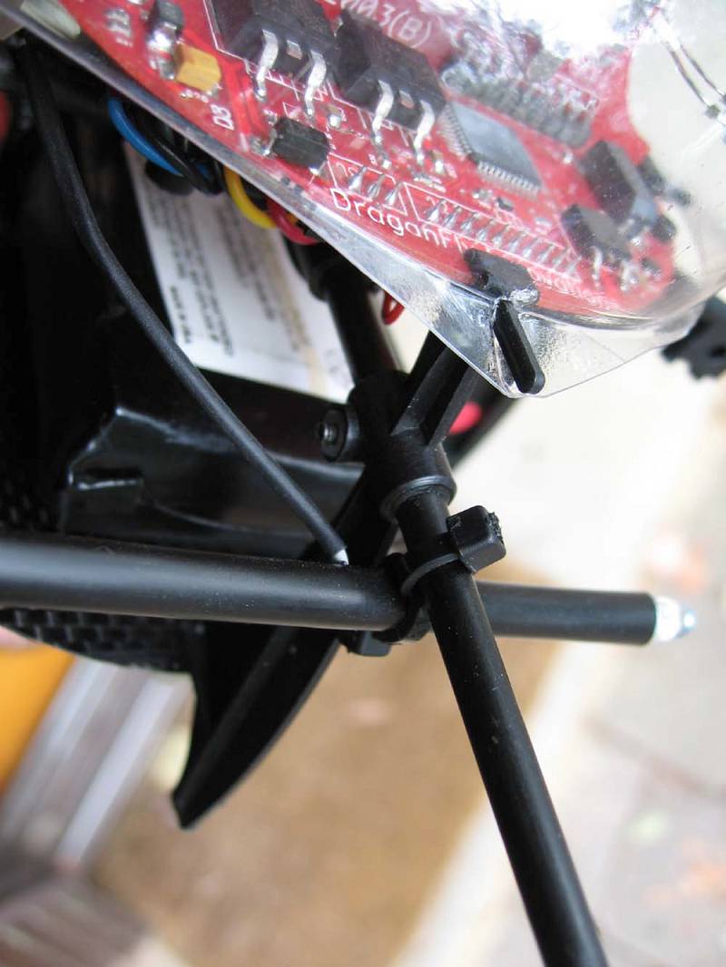

I have had a few e-mails requesting information on my home made Nav Lights, so I have a description and a few pictures
Parts
2 x Hi Intensity 5mm LED red (16,000 mcd).
2 x Hi Intensity 5mm LED white (16,000 mcd).
Some stiff black 5mm tube (I used a good quality drinking straw) but cf tube would be good
2 x 50 Ohm resistors (I used 47 Ohm, it is slightly too low but gives a good brightness)
1 Plug to connect to the Draganflyer 5v supply (I used one which was originally made to connect to a PC mother board) which seems to fit well, otherwise you can
order one from Spectrolutions.
4 x Small cable ties
Some heatshrink sleeving.
Assembly
Cut the tubes to about 60mm length and make a small hole about halfway up each for the wire exit. Thread some wires through the holes and solder the resistors
and LED's according to the diagram attached. Connect a white LED, the resistor and the red LED in series, Take care to make sure the +5v goes to the anode via
the resistor, and then from the cathode to the anode of the other resistor. Make sure all connections are insulated from each other and drag the wires back through
the holes.
Each LED tube requires 5vdc to operate, so you have to connect the two assemblies in parallel and tidy up with heat shrink tube. Connect the plug and attach the
assemblies to the Draganflyer arms with the cable ties. See the pictures attached for more detail.
Good points
Very bright
Very light weight
Very low cost
Very low power drain
Bad points
Lights go out if the fuse blows (No help for recovery in the dark)
Hi intensity LED's are only very bright when viewed at +/: 30 degrees (so they do send out a cool beam of light) but they are less bright when viewed from the side.
I have been very happy with these lights, but they do not have cool strobes or sophisticated lighting patterns. I am sure there is room for improvement
Happy flying

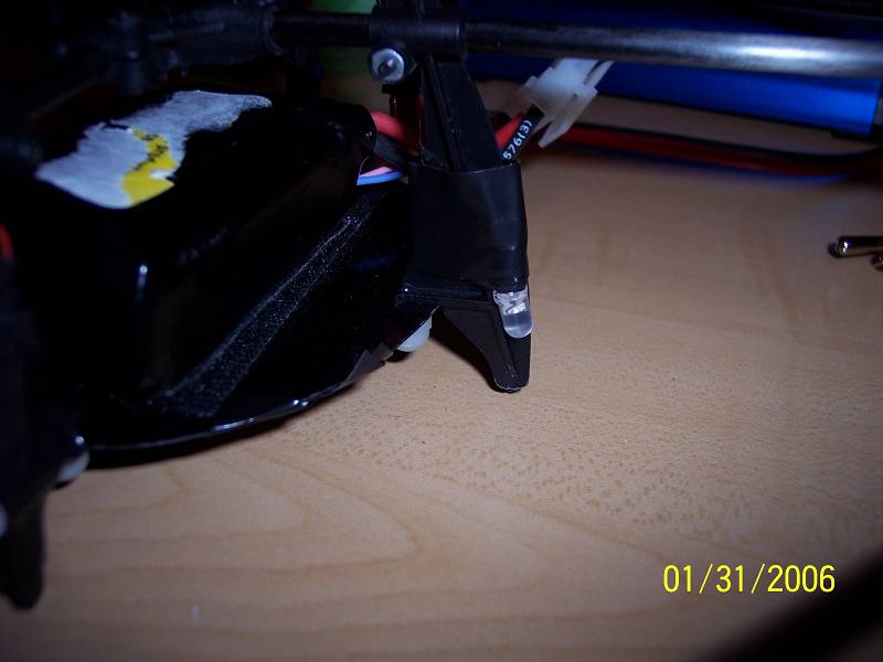

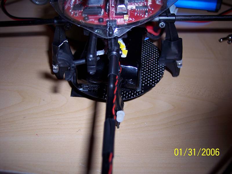

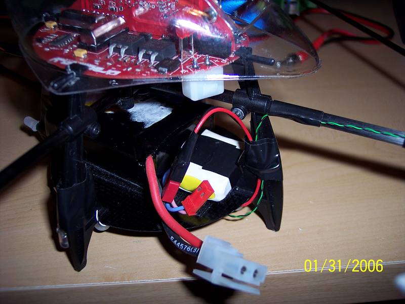

Sky I received my Flight Lites yesterday and will install today I have to say they really are great and I cannot wait to get them put on today.Jeff at flight lites is really a great person to work with and he got my lites to me very quickly.I give Flight lights and their customer service a big [sm=thumbup.gif] and a big thank you to you for showing me the site.
Banned
My Feedback: (14)
Joined: Dec 2003
Posts: 561
From: Colorado Springs, CO
My DF with it's new lights put on,the lights work great but it is raining here so I cannot try them out in flight,hopefully tomorrow.The small Lipo is how I power the lights and if my math is correct I should get two hours of time to power the lights and still be in a safe zone.
