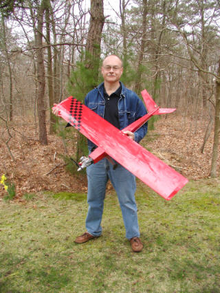

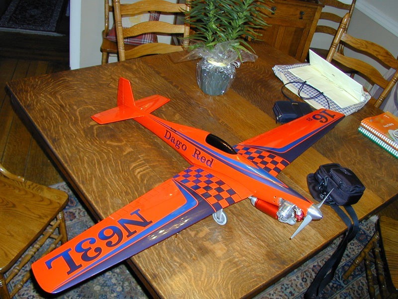

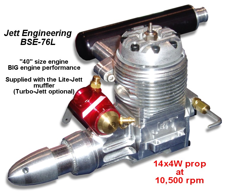

Hi Dave,
Thanks for writing.
Yes, the more competitive Q40 and Q-500 planes have become pretty popular for sport use. Its hard to find something much faster
By rules, the racing engines are 6.5cc .40cui displacement. For sport, there are no such rules.
The racing engines are indeed extremely powerful. But, they are tweeked to the very edge of stability. They are very rpm dependant. It takes some experience with them to set the needles, and to deterimine which prop is best for a given set of weather/location conditions. Plus, neither the 428 Q-500 or Q-40 engine have a throttle.
You can use them for sport use. Many do. As long as you do not mind not having the throttle (or you can add a jett carb), and you choose to go with a conservative prop size (8.8x8.5 is ideal), the engines operate quite well, and will be user friendly. And as you gain experience - you can experiment with heavier props. The bounus here - is you actually have a 'legal' plane that you can race if you wish. And you gain the experience of setting up the engine and aircraft for race conditions. The 428 engines are mainly AAC these days, and are an ounce lighter than the ABC sport engines, and sometimes this makes balancing the airplanes easier. Often enough, you can find older generation Nelson and Jett QM40 and Q500 engines, well cared for, just tired and maybe a few rpms down on power, for some bargan prices. Just beware the source when purchasing a used engine like this.
The reason many folks use the higher output SJ-50 with the racing muffler (or a SJ-60LX engine with a black racing muffler) for sport racer applications is that these engines produce basically the same power as the Q-500 engine, the muffler tunes for the same rpm, they turn the same Q-500 racing props at the same rpm - and do that effortlessly. Here we have a powerful engine, user friendly, no critical needle, AND a fully functioning throttle
And most folks choose to stick with the standard glow plugs (The nelson plug head is available, but the nelson plugs do not idle or transition all that well). Added bonus here, is later on, you can install a standard jett-stream muffler, and put a 10x6 on that same engine.
For the Q-500 application, you can aquire a SJ-50 race configuration with the backplate mount - bolts right on to the plane as the racing engine would. Use the 8.75x9W, 8.8x8.5, 8.8x8.75 or 8.8x9 props. Set any of these down 600 rpm off of peak rpm, and go. For some, getting use to the speed is a challenge - in this case, throttle back
For the QM40, a few of these have some ground clearance issues with 9" props, but most will actually accomdate a 9" prop quite well. So for most, you use the same props above. Also, you can take one of the 8.8x9 or 8.8x9.25 props, and clip it down to 8.25" diameter - the engines love this, and the QM40 will go like he|| with that setup. The bonus here, is with the larger blades, yeah, you give up 5-10 mph on the top speed, but the low speed pull is there ALL of the time - take off is effortless - just a bit of right rudder as usual. On landing, you can idle and approach as usual. The spinning prop actually helps you slow down. I do recommend killing the engine on final though - save the prop.
Ive attached a couple of examples of what was discussed here.
I hope this is helpful

Bob, thanks again for taking the time to share your knowledge with us less experienced fliers. You've been more help than you can imagine. I may link to this in the extreme speed forum, since I think such information would be viewed by more people that may make use of it there.
Nice fleet you have there too.
