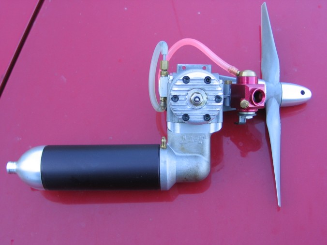

I have noticed a difference in the black mufflers for the Jett 50. Just curious as to what, if any, the practical differences are. The one I have is in the first picture. The one in the second is slightly different.
Also, I noticed in another thread in the Jett support forum that you recommended ( among others ) an APC 8.5x 7.25 prop for use on small, fast planes. Sounds interesting. What rpm range should this prop run in, and should it be used on a relatively new ( bench ran only ) engine?

the muffler you have there is the SJ-50 race muffler .... basically the same internally as the Q-500 black muffler shown in the other photo. Runs the same from what i have seen. It just replaced the double-bubble chamber with a straight one.
With the black muffler, if you have the engine installed on a Q-500 or something similar/quick, start off with an 8.75x8W, or 8.8x8.5 prop. You want to prop the engine to run over 18K rpm on the ground. Preferably up over 18,000 for launch. As the engine breaks in and you get some experince with it, you can experiment with props that work best on your airframe.
That 8.5x7.25, on a SS-40 engine (1 needle carb, SS red muffler) will turn upwards of 20K+ rpm on the ground. Hits over 21K in the air. Turns out that combionation had a secondary tuning node we found purely by accident some time ago, when we used the 8.5" props for break-in and early test flights. The engine really responded, and we noted that the test flight speeds and lap times were faster than with the 8.75x8W "Baseline" prop. So for regional/club racing, where they did not require 8.75" min diameter props, we used the 8.5x7.0 and 8.5x7.25 props for actual Q-500 racing. The SS muffler works similarly on the SJ-46 and SJ-50 engines.
