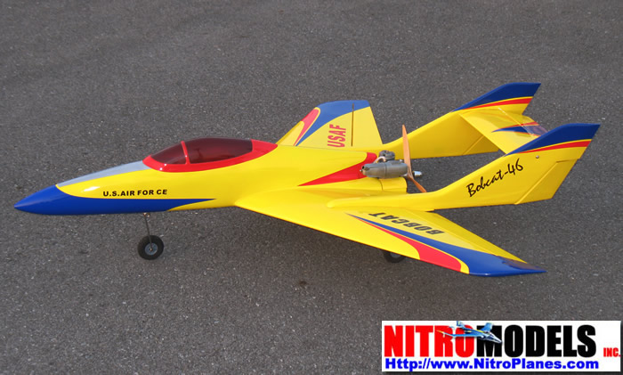

i have a fairly new Jett 50, it has about 10 or 12 flights on it. The first 5 to 6 flights where very good ran strong no hesitation, these last several flights have been fairly poor. After starting the motor and taxing out it seems to load up and on a couple of occasions it boggs and sputters so bad I abort the take off. The last 3 successful flights still have a bogg down or hesitaion in flight sometimes it happens just once other flights in happens the whole flight.
So far I have moved the needle valve off the back of the motor( no change), I put all new fuel lines in yesterday (no change), I have very slightly leaned the low end ( no change).
On the bench I am hitting 14,800 turning a 10x8(make that a 10x6) 2 blade pusher prop using the power master 15%. I have this motor on a Nitro models Bobcat. The tank faces forward like in a regular plane so it has long fuel lines
I am out of idea's , help if you can...

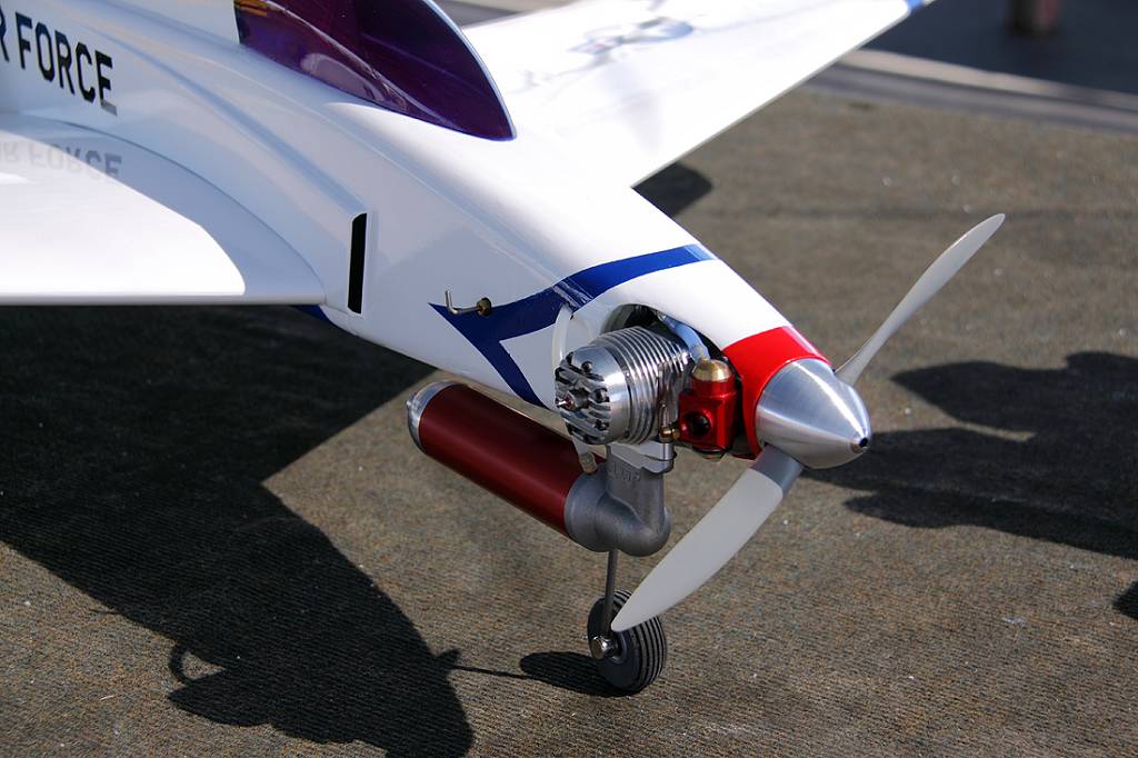

here is a picture of where i have my needle mounted. 6 flights so far and haven't touched a thing, but the 50 is showing signs of more power, not less. i'm still on the original plug too, and that includes 40 minutes of breakin.
these engines are the smoothest and most consistent engines i've run yet.
i don't own a torque wrench and i like the idea of using one, but i never run engines lean so haven't had anything loosen up.....might even say my pattern of mechanical setup and checking is rather boring, but competition teaches you that. but like Rich said, if you have run lean and the holdown screws have loosened enough to allow the sleeve to rotate, then that will make a sudden change like you just experienced.

I see a three bladed prop in that picture - what are you actually flying it with? It could explain a few things. Overloaded pusher engine, feelin' "hot hot hot", loosened head bolts, plug change, rotated sleeve... ? That situation has been documented here more than once.
If that is a 10-8 3 blader, especially on a pusher setup, it should be on a sport timed .60, not this engine. Heed Jett's instructions about rpm!!! Let it spin!!! I would not put more than a 10-6 2 blade on an SJ .50. Normal advice in the RC fraternity is to reduce prop load a touch on pushers, two strokes run hotter the more you load them up, especially when you exceed a critical threshold defined by the design of the engine and pipe tuning. In general overpropping a 2 stroke is cruel, not kind. Esp a new one, and double-esp if you are overloading it on a tuned exhaust setup.
Bob will undoubtedly arrive here and clear this up. I bet $5.43 on an overheated engine and rotated sleeve or some heat related issue. Search this forum for rotated sleeve and I bet you find some insight. If I am out to lunch here I owe you $5.43.

Okay, good. The pic and mention of a 10-8 had me concerned so I chimed in about overpropping. 14 and change with that 10-6 is most definitely an eyebrow raiser. Hope it is as simple as a rotated sleeve or the like, as I mentioned there are historical accounts of that here. I wonder if first flights as a pusher is an issue. In the end.. Bob Brassell or Dub will know.

I did, that is on the test stand, and I see that it was a 10-6 APC. But I wondered about what was used in flight since (a) I saw a three blade prop in the pic, and (b) read post #1 which mentioned a 10-8 pusher prop, and wondered if putting 2+2 together meant it was flown with a 10-8 pusher prop or worse yet a 10-8 3-blade pusher prop for the first flights.. either of which would lead me to think it might have ran hot on those flights.
