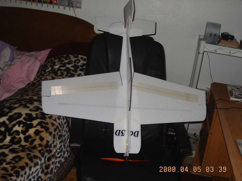

i use a thunder power 3S 1200 mah on this plane and it hovers great.
but do u think ill burn out my motor using this li-po with so much voltage on a GWS c drive??
thanks

It will work fine as long as the current is held to around 2amps and you use the GWS heatsink.
For a DX-C on a 3-cell Lithium pack, this means using a 11x4.7 prop or smaller.

You'll probably burn up the motor but they are so cheap to replace, who cares! Get one or two replacement motors and the small gear and fly the crap out of it until it fries. You could always go brushless.

well...I burned up my motor AND li-poly... [:@]
I took off and the plane just didn't sound like it had a lotta power. I went into a hover and it started laggin even more. Another five seconds and the plane had like no power at full throttle. When it landed, i held the plane at full throttle and the motor was making weird noises and not turning. Then i looked at the battery and it started smoking. I quickly pulled it off burning my finger a lil. I picked up the battery and the connector was melted away, the shrinkwrap was all melted and so were the cells. I just took the li-po and buried it in sand under a tree. I was not gonna drive with it in the car. The motor was super HOTTT!!
I'm assuming the motor seized up and since i held it full throttle, the motor was pulling way too many amps and killed the battery...
