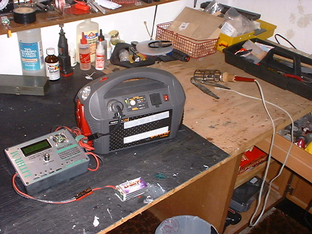

For charging I have purchased a Xantrex Power Pack 150. It has a built in Gel Cell and is designed as a replacement for jumper cables for your car. It allows you to plug your charger into a standard Cirar Lighter fixture. In addition it has an inverter allowing other functions. And in an emergency you can actually use it to jump start your car. Coleman also makes a similar device. It has been really useful. I use it in my shop for charging, as well as at the field. I always charge all my Li-Poly batteries before going to the field, and this device has enable me to fly a whole day without running down.

I use a 12V battery for charging. I've even hooked to my car battery when nothing else was available. I have an Astro Flite 109 Li-Poly Charger and it was the best investment I've made since going to Li-Poly. It never screws up, Only I did on a couple of occasions.
Li-Poly must be charged at 1C or lower.
Charging at a higher rate can cause them to overheat and burst into flames at over 1500 degrees. Li-Poly should never be allowed to go above 170 Degrees Farenheit. Keep them cool at all times, and be sure that you have more MAH than your plane needs to fly. If your plane is drawing too much Current and the batteries are getting hot, you stand a chance of them catching on fire.
To be safe I always go a bit below 1C (C being the MAH of the pack) when charging. For example a 1200 MAH PAck I would charge at about 1.0 to 1.1 AMPs. This is a form of insurance. Takes a bit longer to get a full charge, but the time is insurance.
Also, never leave the batteries while they are charging, and never charge in your plane. Some even go as far as to charge in a Ceramic pot of some kind.
Also never leave the batteries hooked up if you aren't ready to fly. The ESC typically is drawing from the pack and eventually will destroy the battery by taking it too low in voltage. Li-Po Batteries cannot be discharged below 3V per cell or they are ruined. So if you have a 3S pack, it should never be taken below 9V. A 2S Pack never below 6V. Most ESCs for Li-Poly have this cutoff built in or in the more expensive ones, it is programmable.
Most of this information is sent in the instructions and warnings when you purchase the packs. I've been using them for over a year now, and have only had incidents when I, the operator screwed up. Learn the characteristics, and you won't have any problems.

Most people that I know dont worry about anything but the amps going to the Li-Po battery.
An AC to DC power supply will put out 13V in most cases, But so does my fully charged Car battery - And my fully charged Flying Battery setup. My Astro 109 tells me this, but seems to take it into consideration and charge the Li-Po at the rate I choose. Amazing these computers, smarter than we are.
I personally ignore the voltage drop and current draw from the charger, output from my Charging battery etc. What counts is do not exceed 1C going into the packs. I leave all that scientific and Technical stuff to the Brains that designed it.
I guess I'm just making it too simple, but it works for me. I just want my packs to charge, not explode, and work after the charge. Anything else I dont care about.
