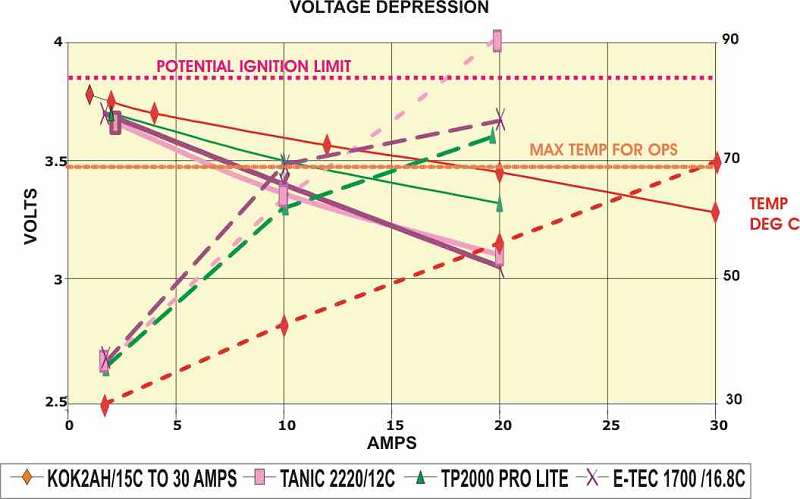

Old 06-23-2005 | 09:15 AM
Joined: Aug 2003
Posts: 180
From: Frederick, MD
Default RE: Eflight 400 and Phoenix 25
ORIGINAL: Wingpilot
I would like to build a Combat Wing. I have the kit, Eflight 400 and Phoenix 25 speed controller. I would like to go with the Lipo battery but really dont know what to select. 7.4V or 11.1V, 2000-4000 MAH? Any input from you experienced pilots would be greatly appreciated.
Dale
Dale,
The attached curves show the clear choice. Operating the 400 brushless for more than a few seconds at over 15 or so amps will overheat and damage all except the KOK 2000/15C
